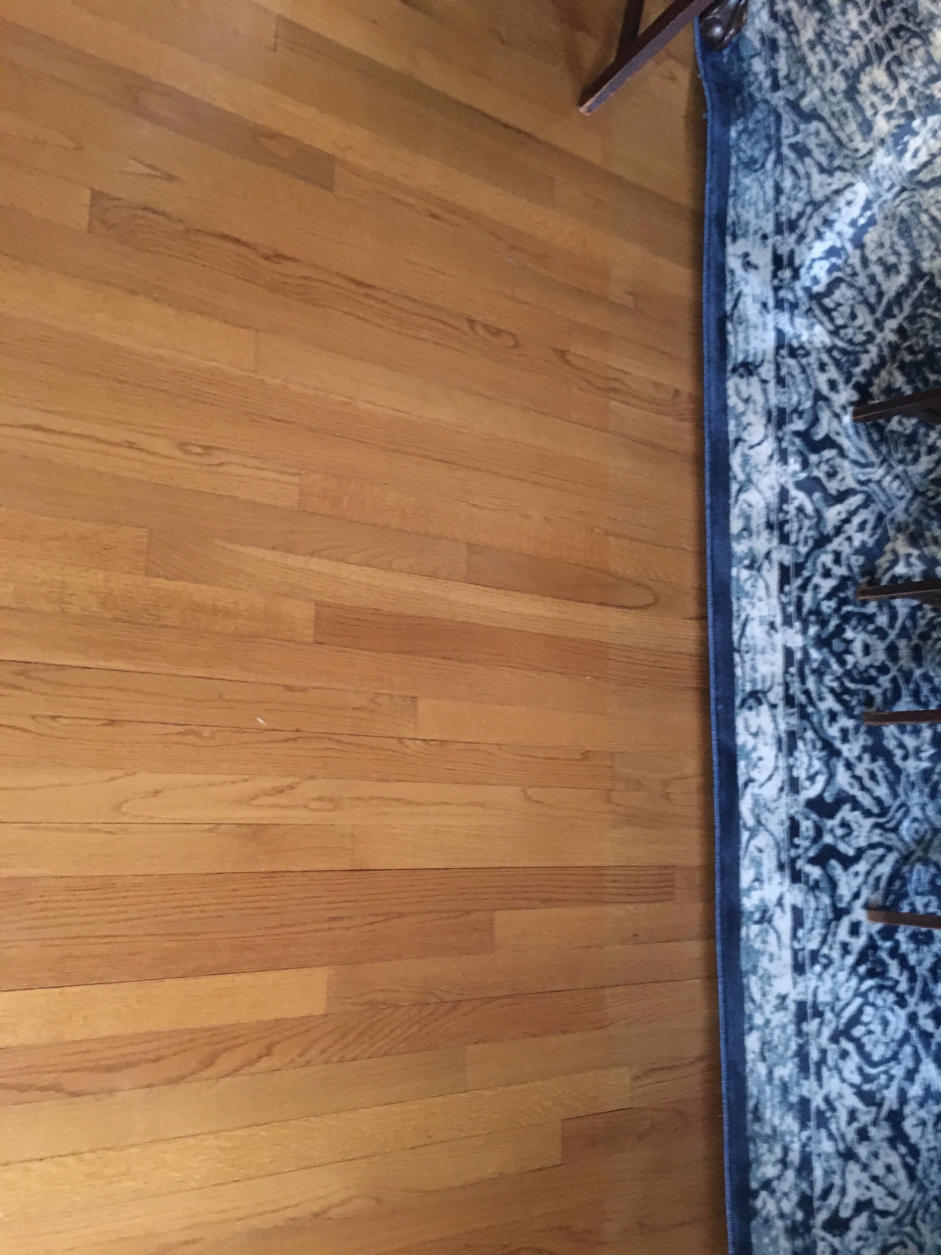

Two real scenarios. The blue rug during cleaning :
“ ma’am,can I show you this? As you know I had to use water to clean up the spots on the rug. This buckling is from the cotton that’s weaved in the backing. It does this when exposed to moisture. Give it a day or two and it’ll relax.”
“Ok, no problem”

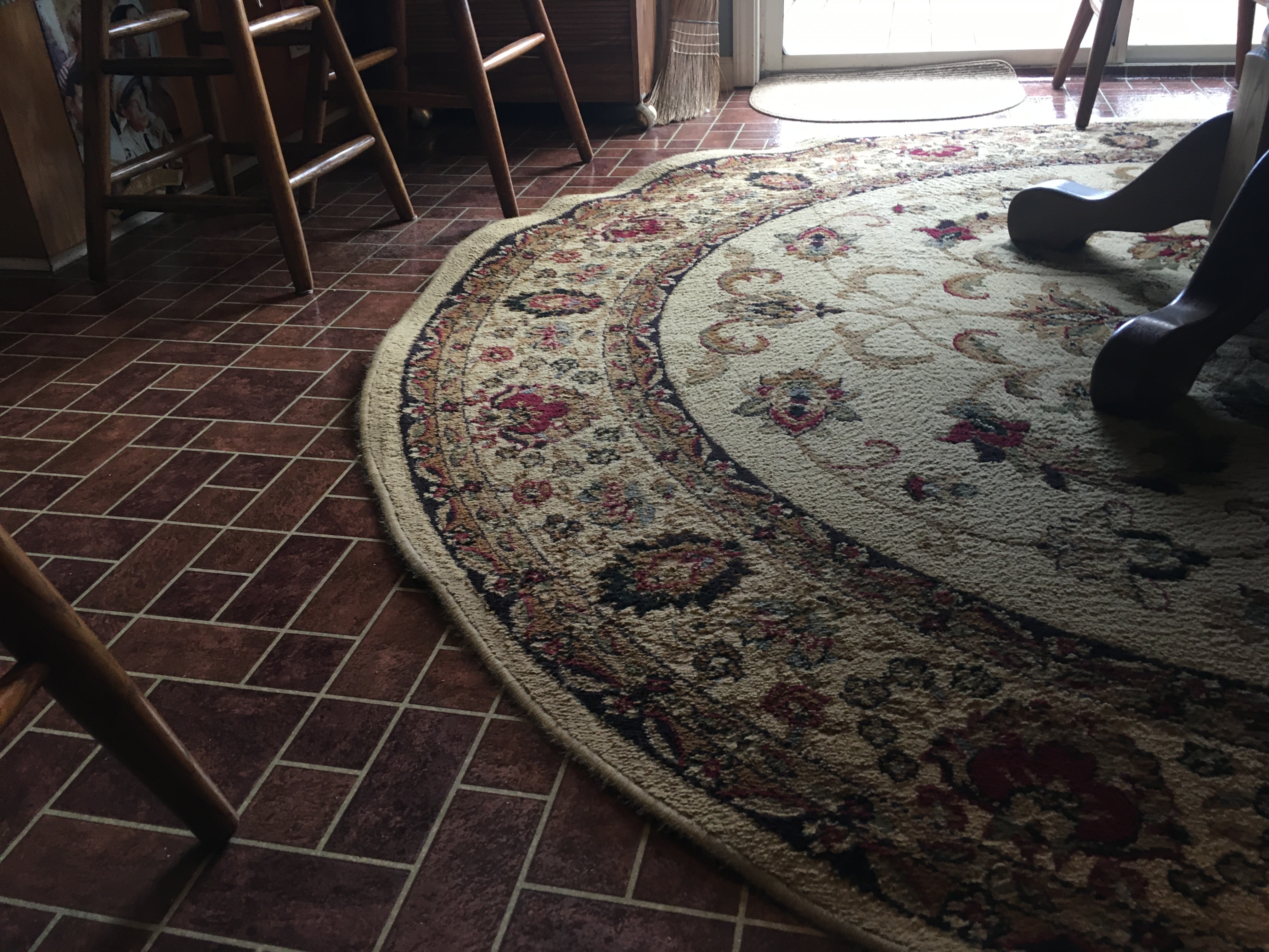

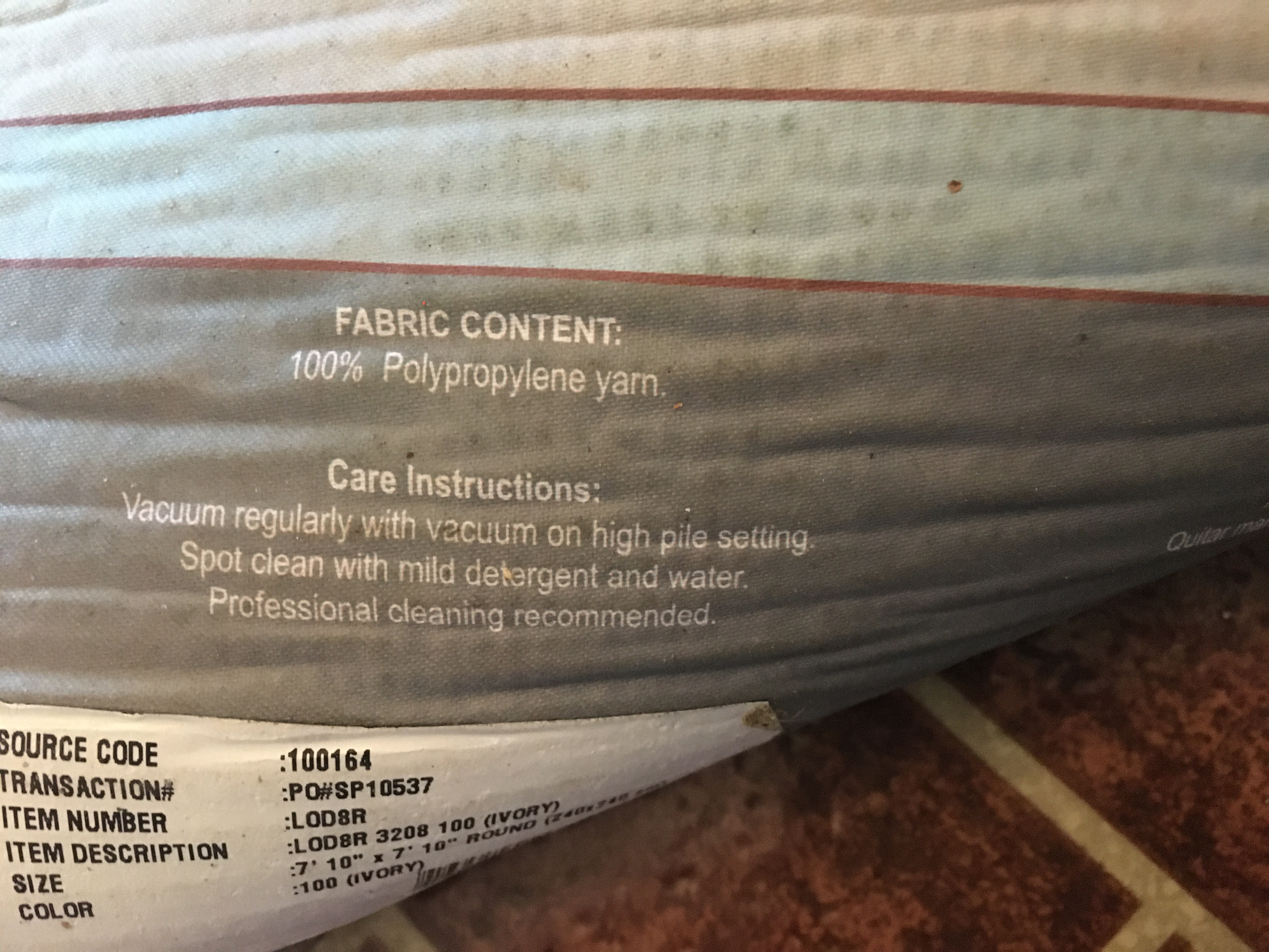

Next one:
“From the flushing method I’m using...it’s causing this polypropeline to buckle. It’ll relax back down once it’s fully dried. Just please watch your step when you walk around it.”
She accepted that explanation.
And don’t give me any excuse for saying encapsulation would’ve prevented that. It started buckling almost right after I put a light spray on it.
BS on refunding any money for these rugs buckling

Using an OP would've put the same amount of moisture on it that caused the buckling. Note that I said it started buckling with just a light spray. The blue and white rug had dog crap on it, which an OP would've been useless to make it clean enough. I know Mikey is just trying to piss me off, but the Canadian above has really pissed me off.
