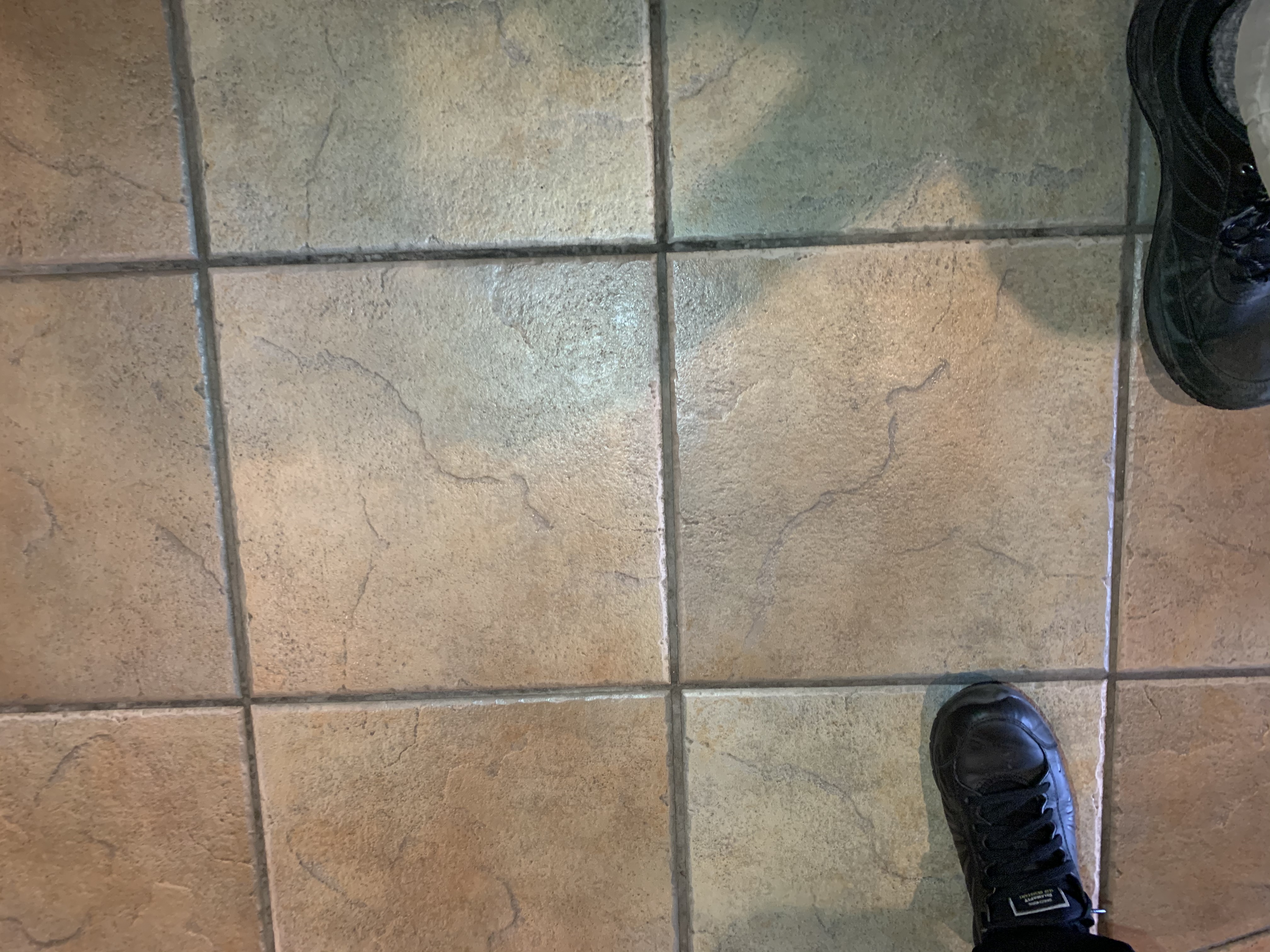

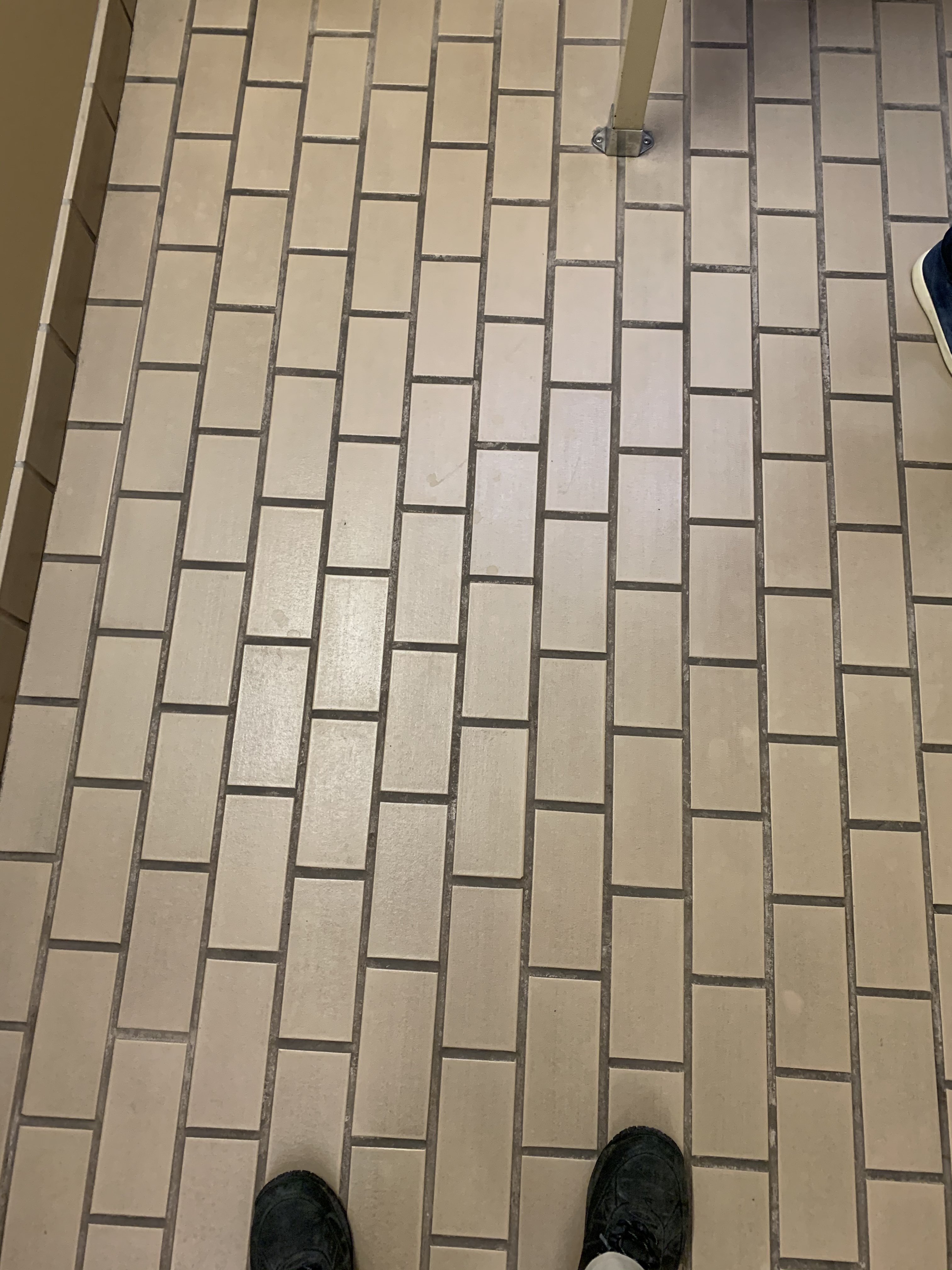

I’ve been asked to clean some T&G in a set of restrooms. The spaces (men’s, women’s, and handicap restrooms), have been cleaned improperly for a long time. There is not only daily funk, but some dough head decided to wax them aswell. It was never cleaned properly in the first place, and they then slopped wax on them to give them the shiny look.
And, I’ve been asked to clean and wax some polished concrete....
I was wondering what process and chems the collective would recommend.
My plan was to clean the restrooms, and re seal the grout with Saigers Super Sealer.
The concrete: what wax would be EASY to work with.
Thank you in advance.
I know the first reaction is to walk away, but, this one I cannot. It’s part of a much bigger project, and if I can’t solve this issue, they will find someone else who can.....

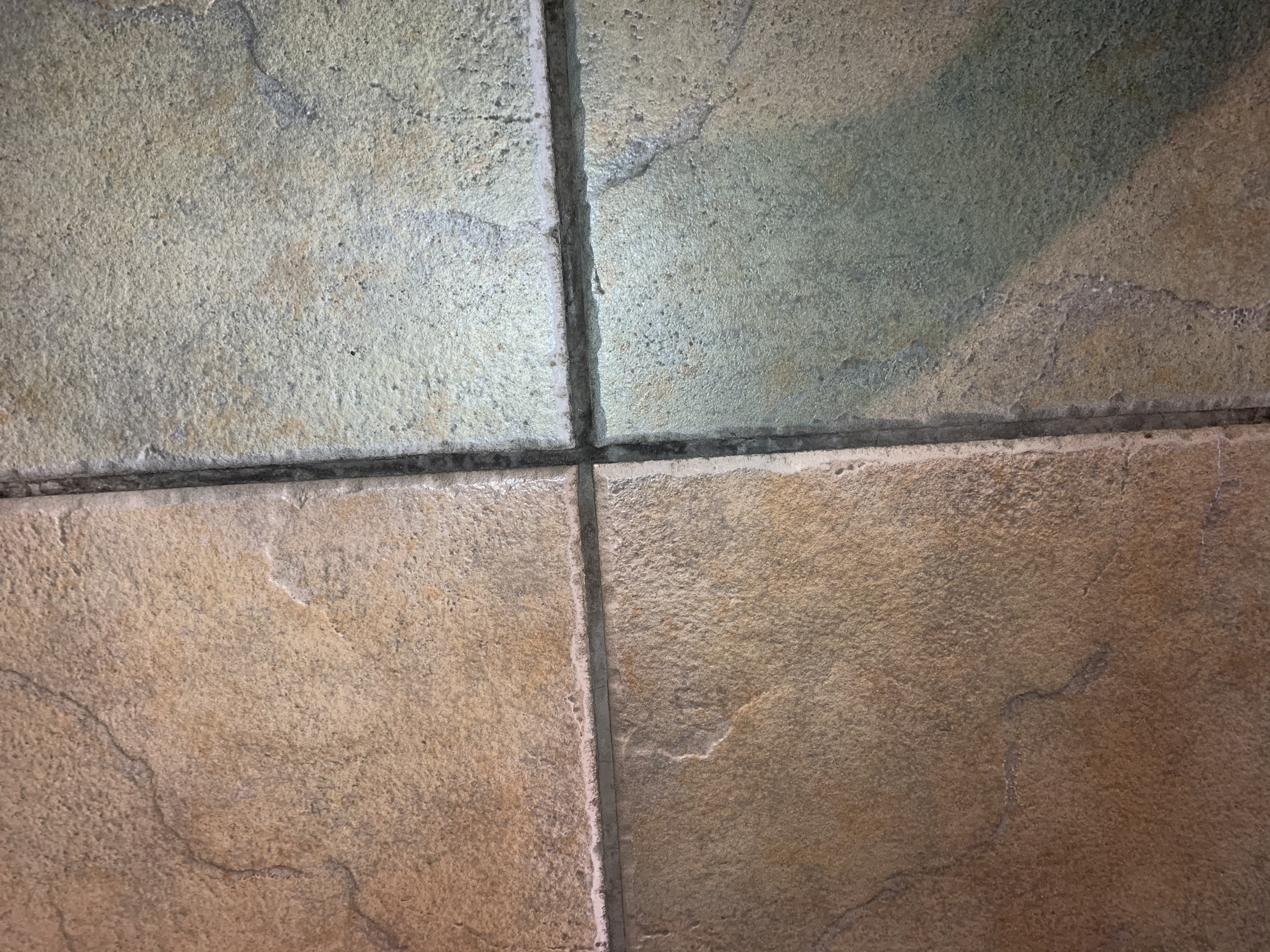

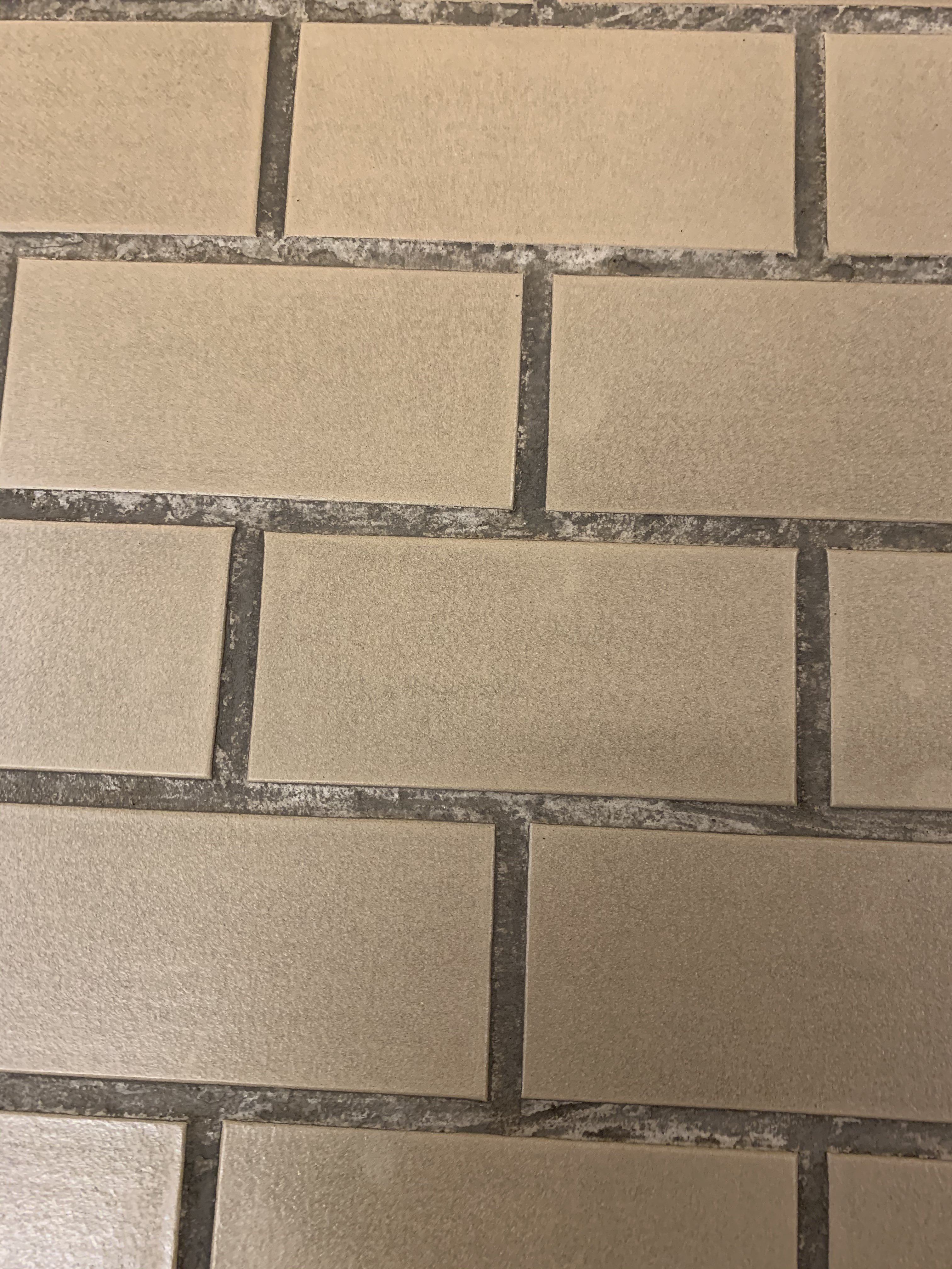

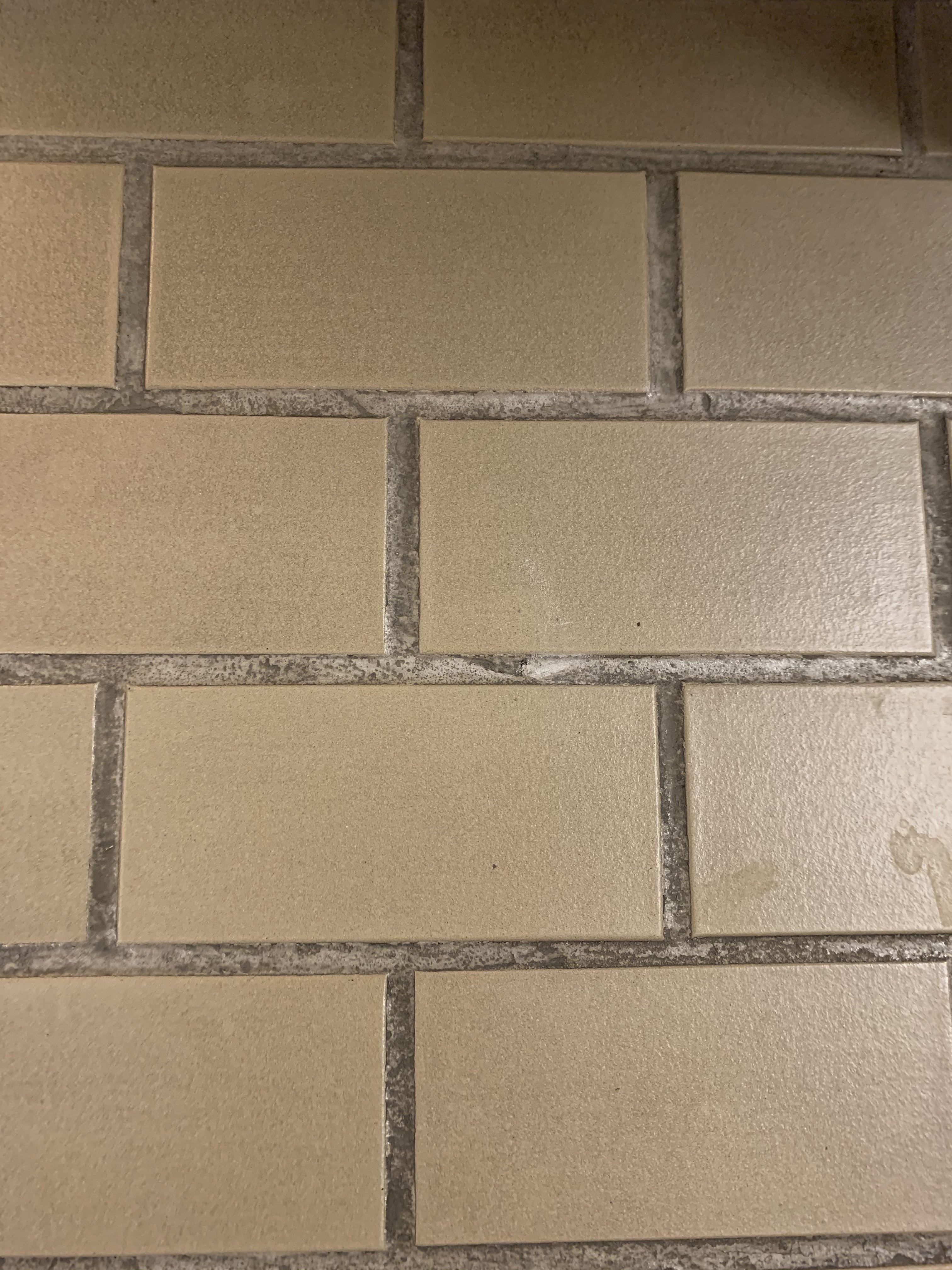

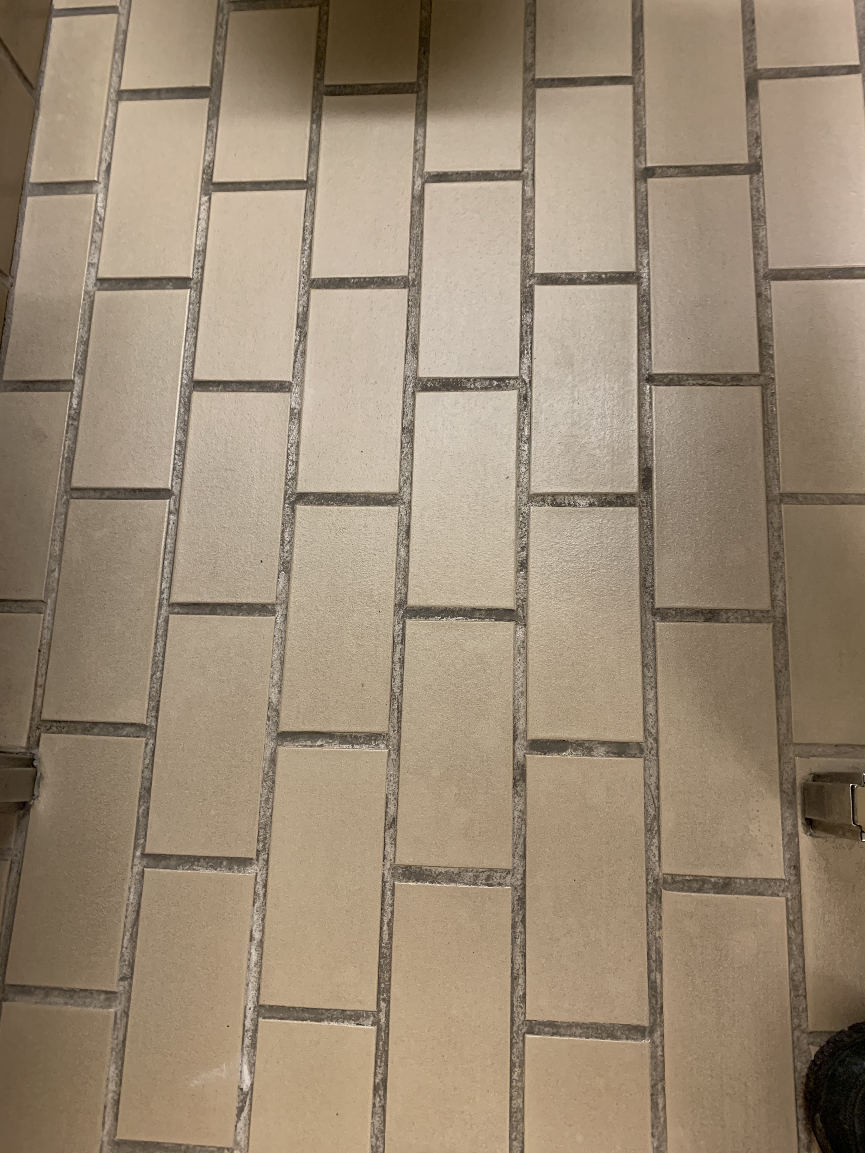

Use a grout brush on a 175 and use stripper in small areas. Keep it wet don’t let it dry and do add to much stripper a lot of em the water acts as a catalyst. Just don’t promise 100% removal. Sometimes the last 5-10% is the worst!
9,430
Yukon, Oklahoma
All you can do is the very best you can. Hot stripper, and baseboard stripper in joints. Use a regular black pad for tile, then brush for grout. You probably won’t get it all out of grout. Then I would reapply aqua mix sealer. That decision was made a long time ago

Sometimes we will throw on 50-75lbs of weight for grout lines. For tile surface black or a green pad. Just remember to rinse the pads off they do clog. When using pads we will use a buff pad on the driver then set it on the strip pad

Jobs looks rather easy. It’s not on that thick
use you fav chem stripper
test different dillutuon ratios fastest production rate
standard brush fine may need a blue swivel
Grout brush.
plan on using acid
For the white grout lines after atripping
Grout brush.
plan on using acid
you are using a turbo right? If not get a poertable
Set up
I was planning on doing a cleaning firsthand with my TM. Then, put down stripper, scrub w/175, and grout brush. Then suck up slurry with a shop vac, rinse, and repeat...

What I seen in your pictures, the cleaning first would be unnecessary. The dirt is probably embedded in the wax anyhow, especially in the grout.

if there is a wax on there then standadr cleaning first would be waste of time and may hinder the stripping process.
we turbo stripper all the time, just squirt some liquid defoamsr with flip top..
like i said, test, i do not see much wax on there if any... maybee even a strong alkaline gets iy clean
