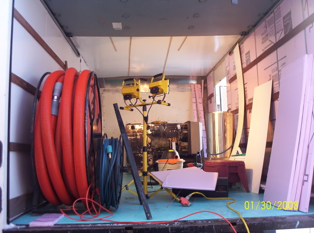

Lee Stockwell
Mylar bubble wrap from Lowes.
Bob Savage also has some great pix of his insulation project. His workmanship is prettier than mine.

bubble wrap will work
we use sheets of styrofoam (pink owens corning from home depot) about an 1 to 1.5 inches thick....with ferring strips....then peg board over that to make it neat and hold the insulation to the steel of the van....and you can run carpet over the peg board for additional insulation.
you can have foam insulation sprayed on too
we keep our vans in a heated garage...but do the insulation if the trucks sit out side while not at the shop
even if you insulate the van....it will still freeze inside with out additional heat...the insulation will just keep it warmer longer and hold in whatever heat is in the van

i did the pink, then fiber board over it...
then use a 1500 watt heater...works ok, my bill goes up about $50 or so in the winter....but then again i am heating 2 vehicles.
my van has carpet all over inside and that acts as a insulator..
