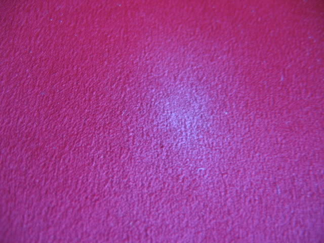

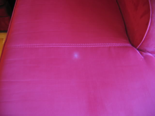

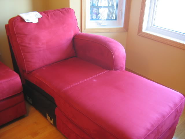

I attempted a spot removal on a polyester sofa recently. No pre test. Used a vds and no problem spot came out but removed color also. Is there anything that can be done to rectify this?

If it removed the color just use some dye. There is so many shades in micro fiber when looking at it that if the dye is even close you will never know its there.

Well polyester can be solution dyed or disperse dyed. I cannot believe it is polyester if a VDS took out the color.
Are you sure the tag did not say polyester fiberfill?
The good thing is that if the dye came out then you should be able to redye it. Normally polyester does not dye unless you are using that crazy Canadian Tony W magic crayon potion. You may want to email him.

For this one, I'd suggest doing a little testing on a hidden area. Try with marker pens or even better some acrylic dye which you can dilute.
Start LIGHT and expect to use several layers.
Most art supply stores carry them. Re-create a discoloured spot with some more of the same vds and test away. You want to find a colour that won't give you a darker spot though that would probably be an improvement.
I wouldn't want to heat setting a crayon on a microfibre, just a guess as I have not actually tried that and until you KNOW what fibre you're dealing with it would be risky.
But as Bill says if it can lose dye, it can probably be re-dyed.

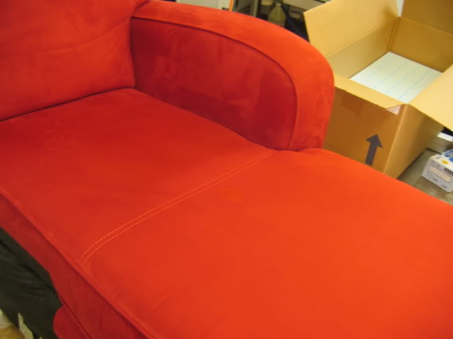

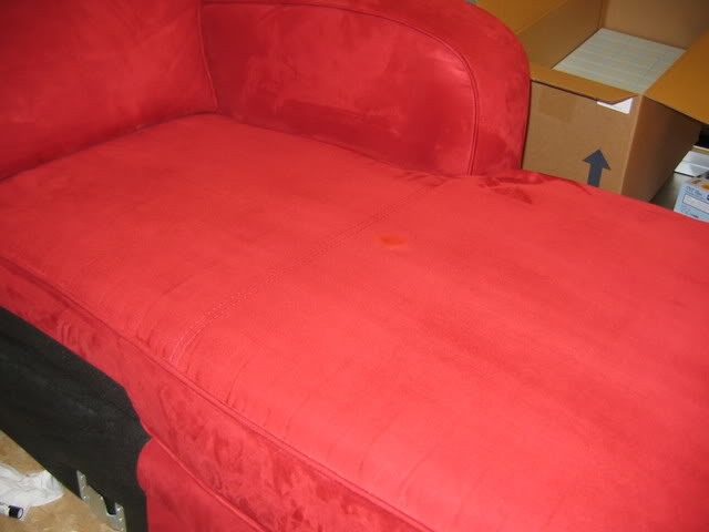

Did a burn test, all I can tell is that it is synthetic burns down to hard ball and has a white cotton backing. Found a marker pen that I thought was close and depending on light and lay of the nap looks not so good:
or not so bad:
Will return piece to customer and see what they say. Thanks for all the help
12,834
Your burn tests confirms synthetic. All that I can imagine is that it might be nylon (there is some nylon microfiber out there) that wasn't dyed properly.
The repair looks better than the fade; if your customer is a decent, understanding person, I'm sure you'll be ok.
