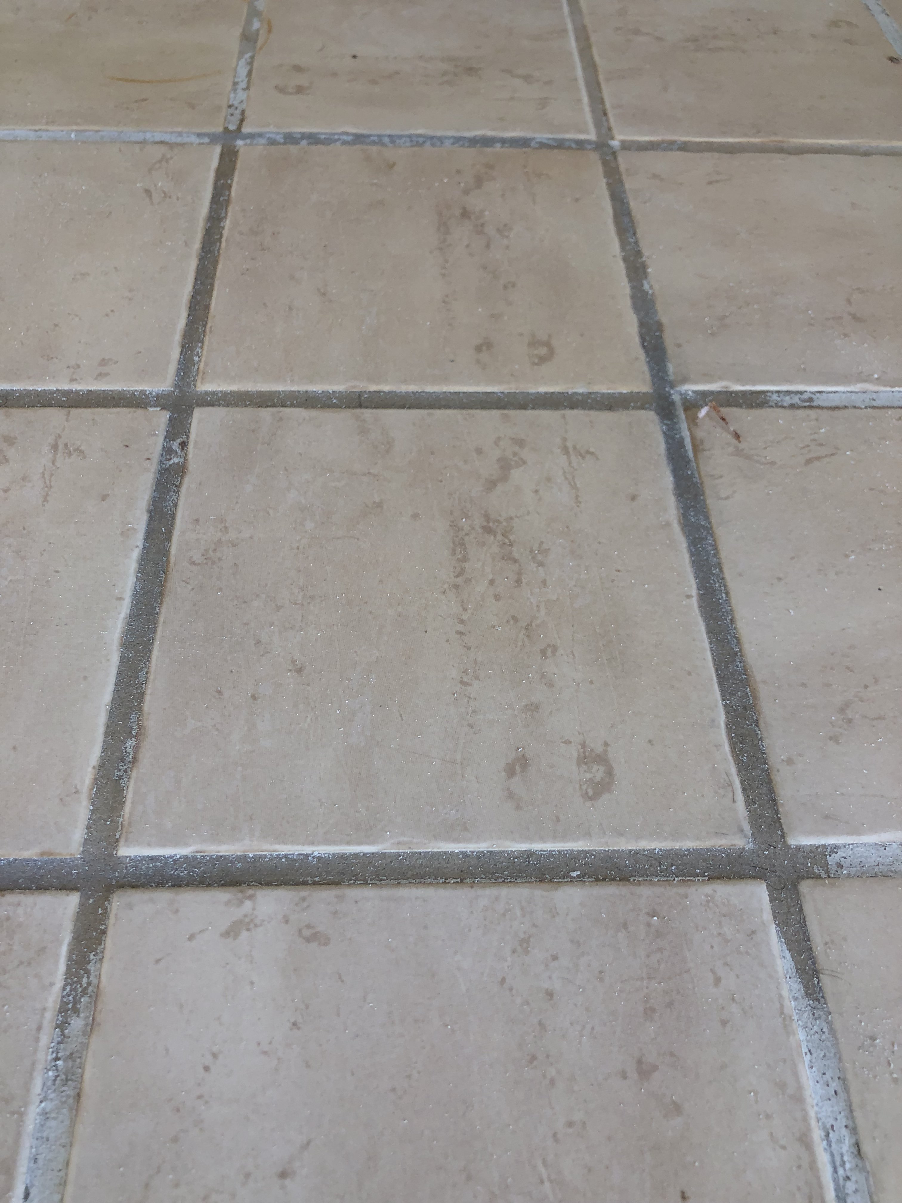

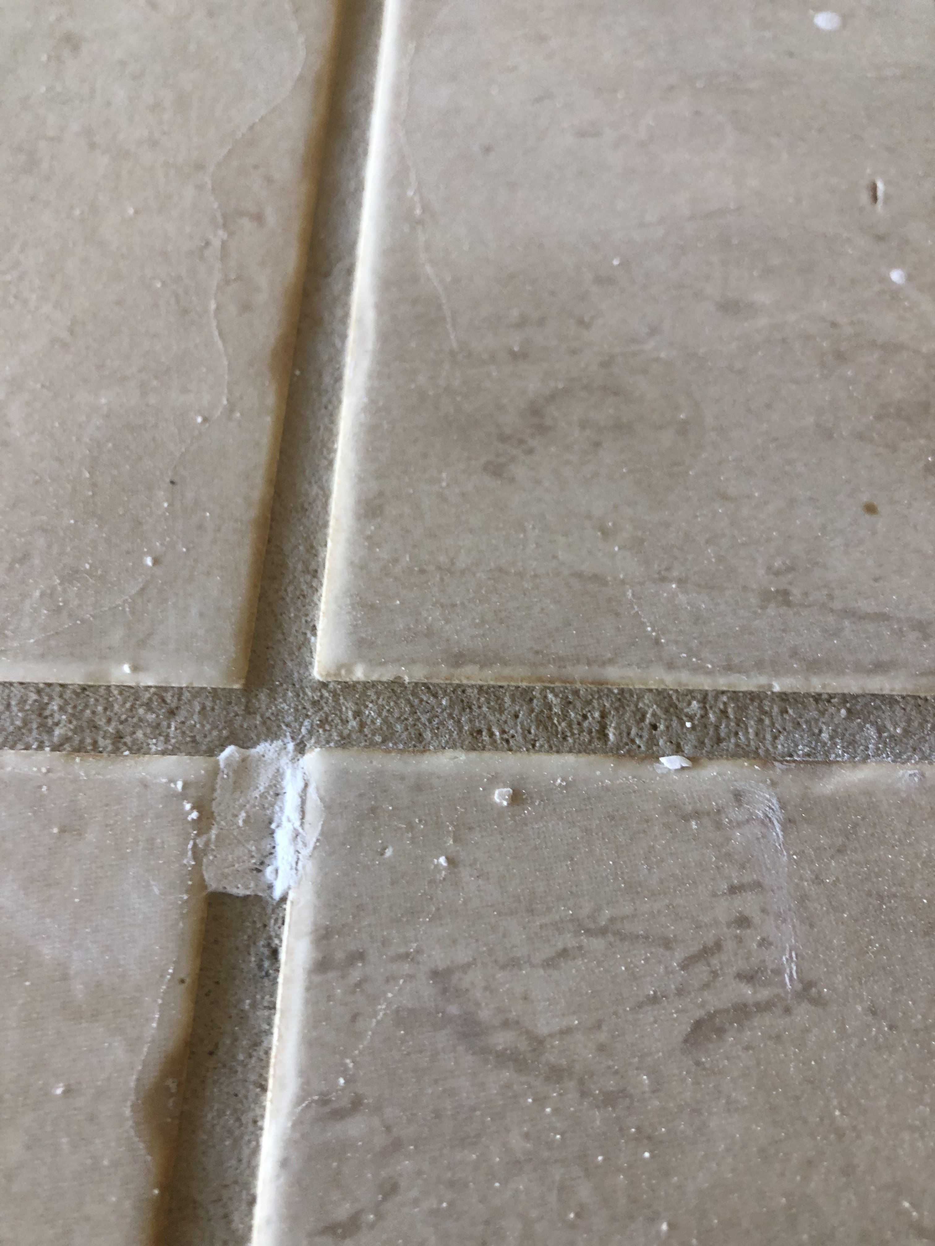

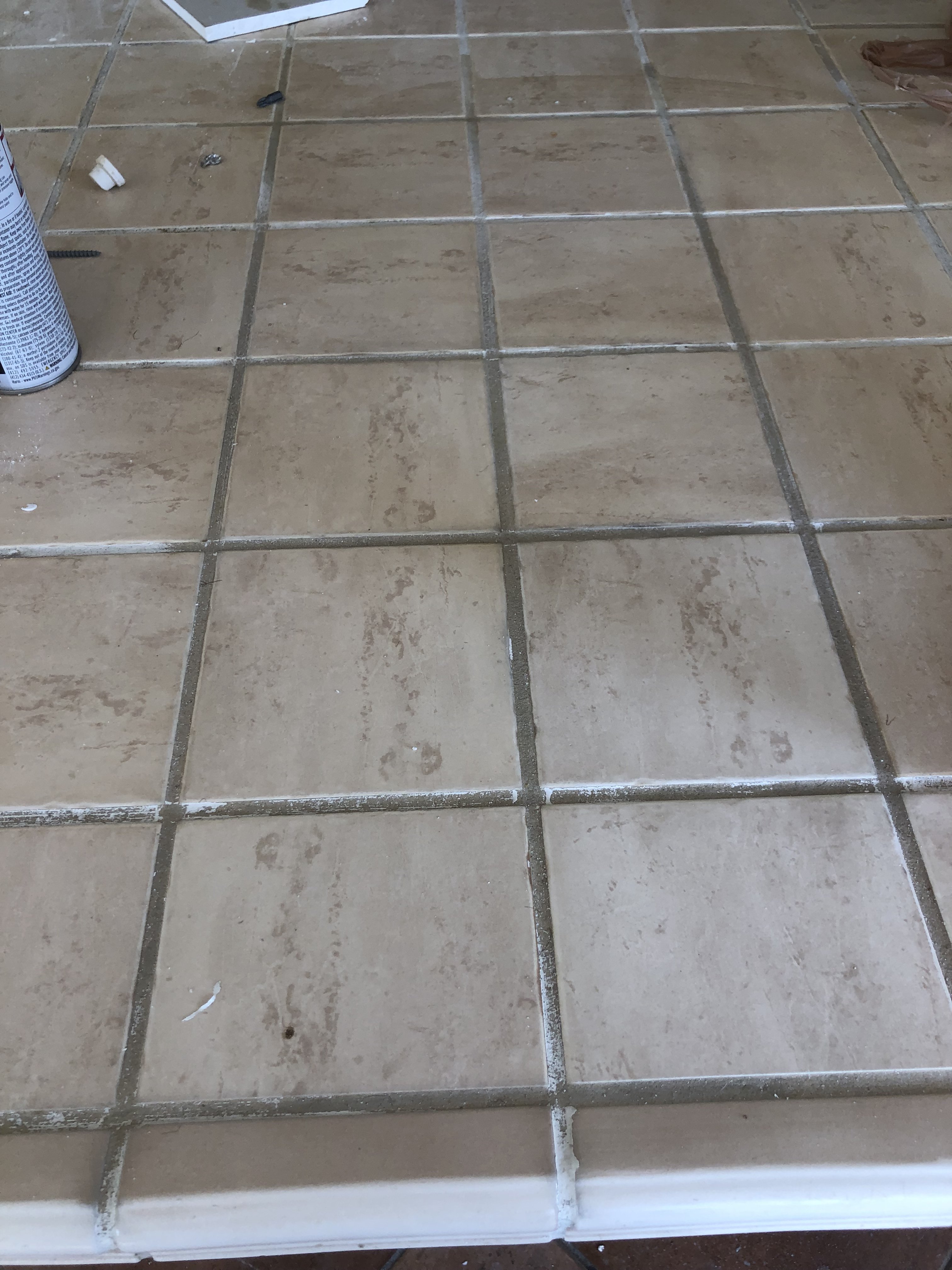

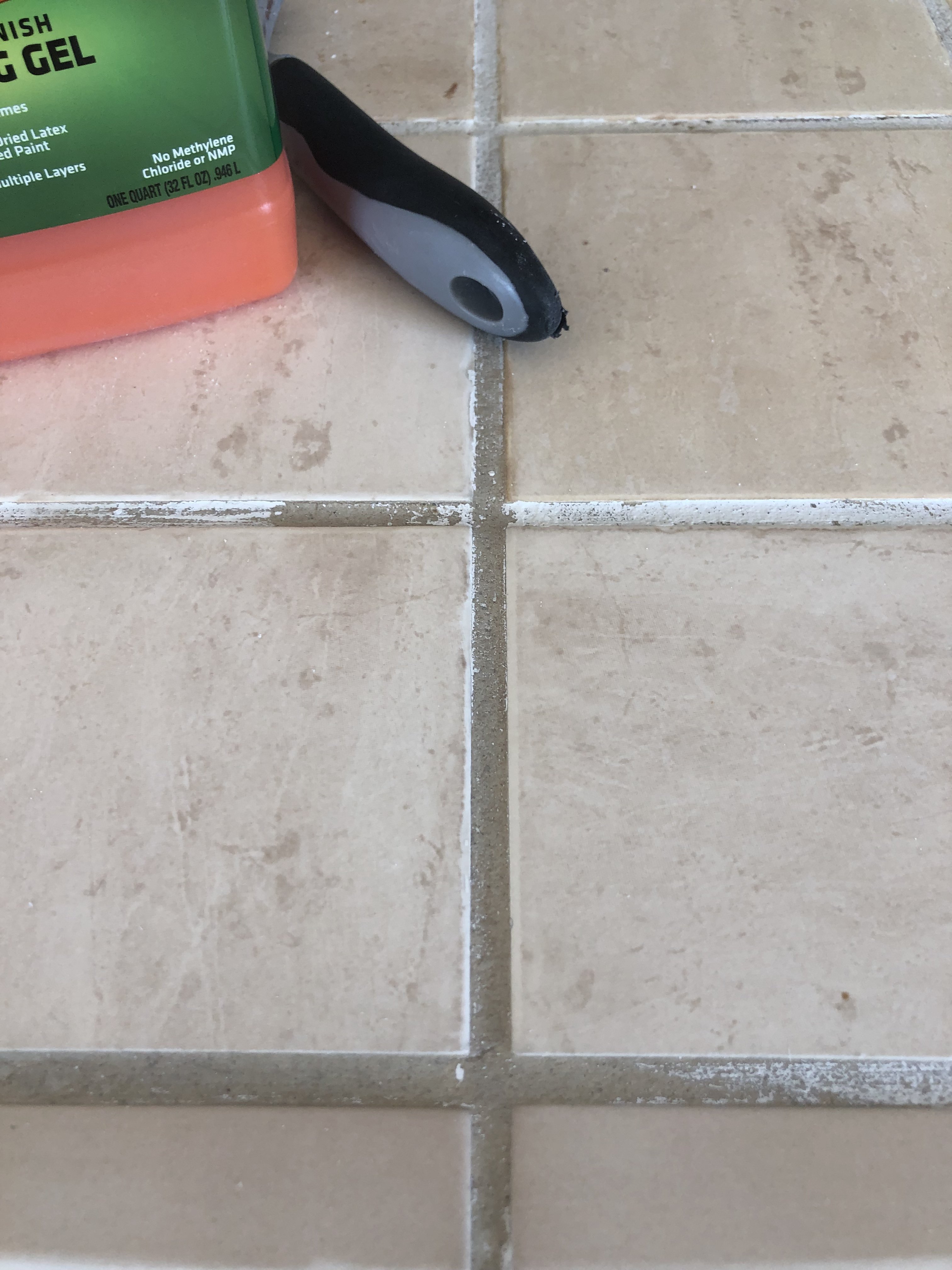

Color seal failure, probably grout removal tool or razor blade? 20 ft of countertop and island .
Any tips?

small wire brush?
Have to be careful not to nickel tile but yeah
Wondering about the stripper from stone pro??
Maybe I’ll go with a wire brush and check and see how hard it is.
The razor works decent.

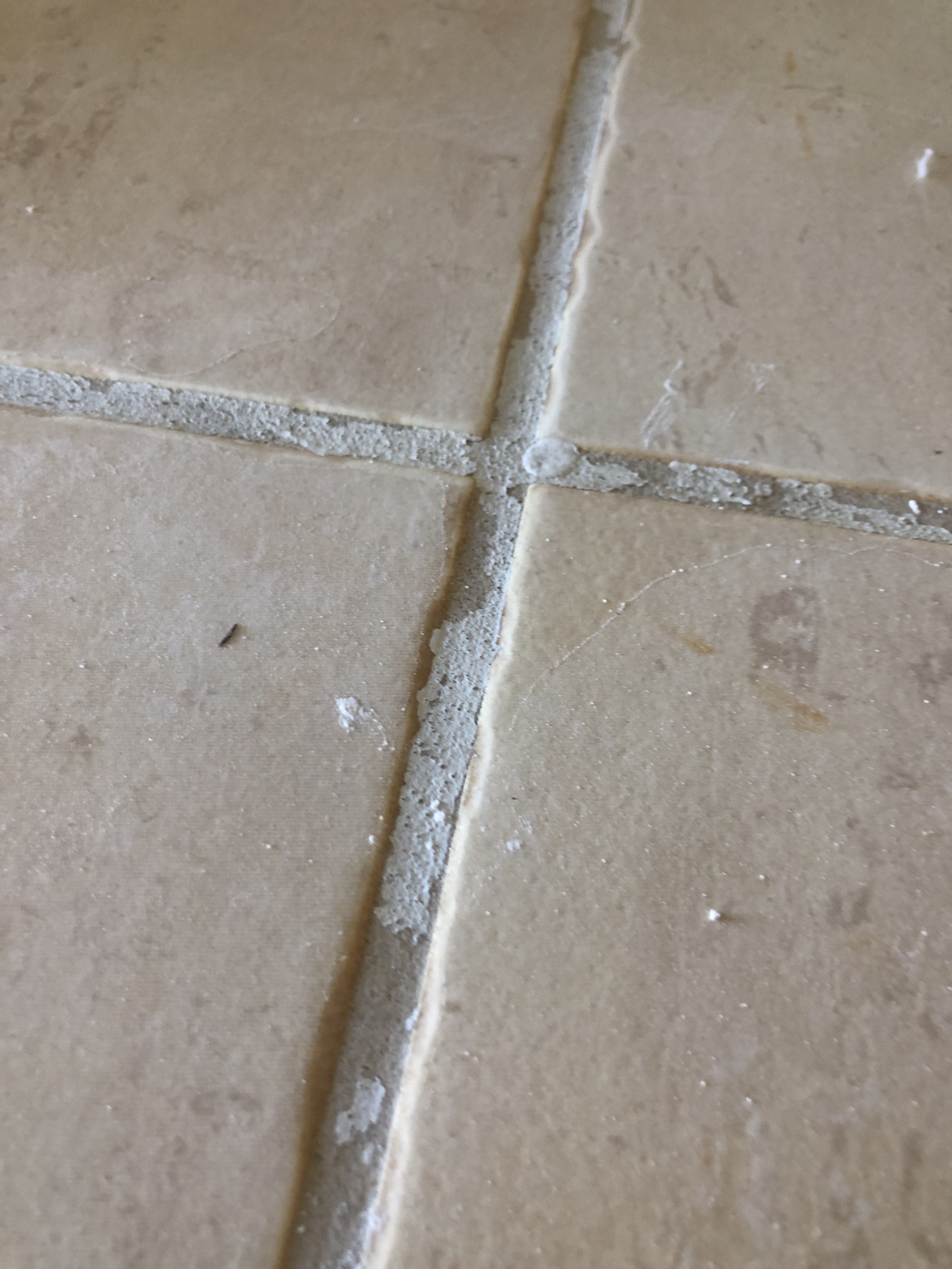

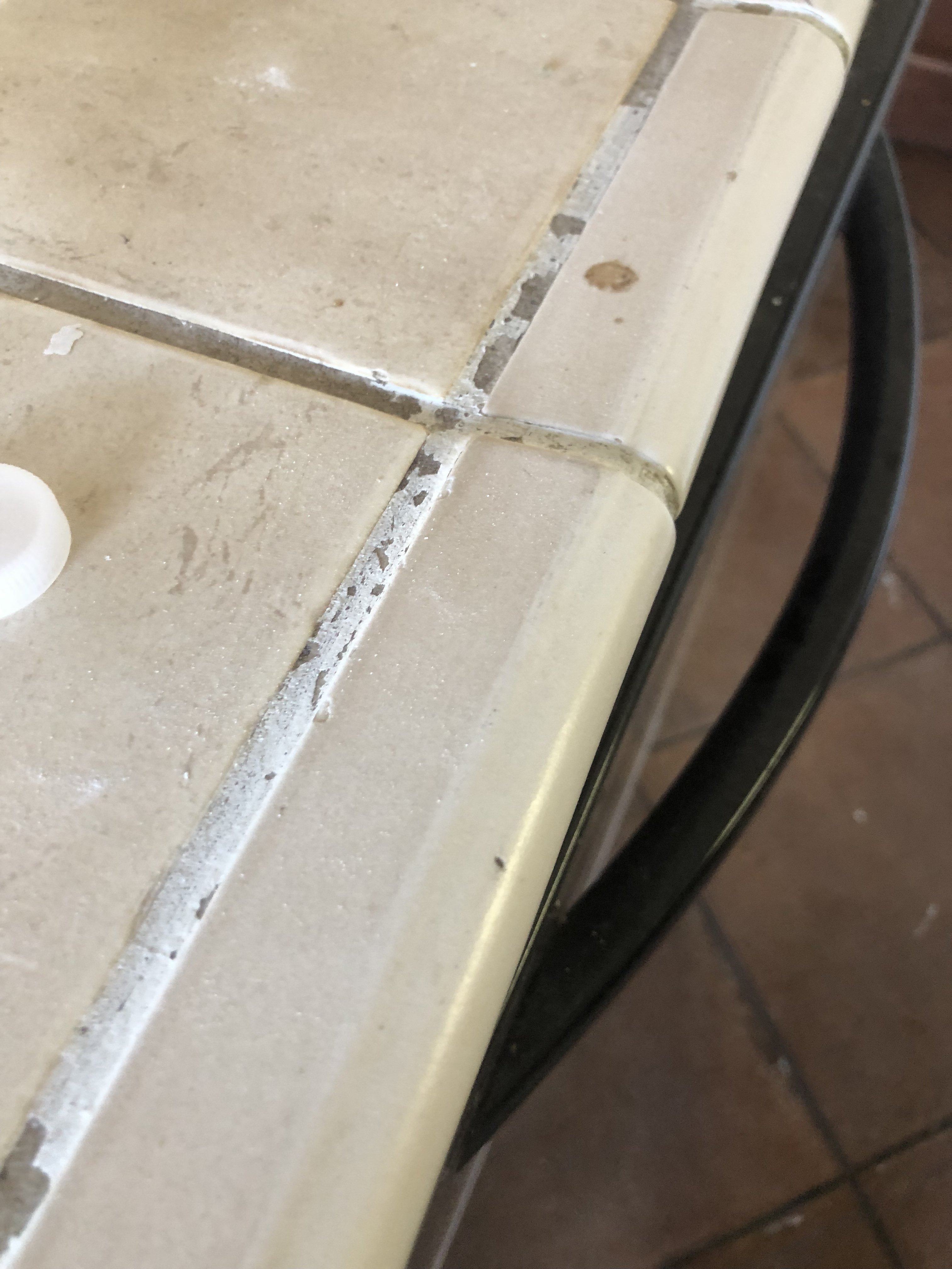

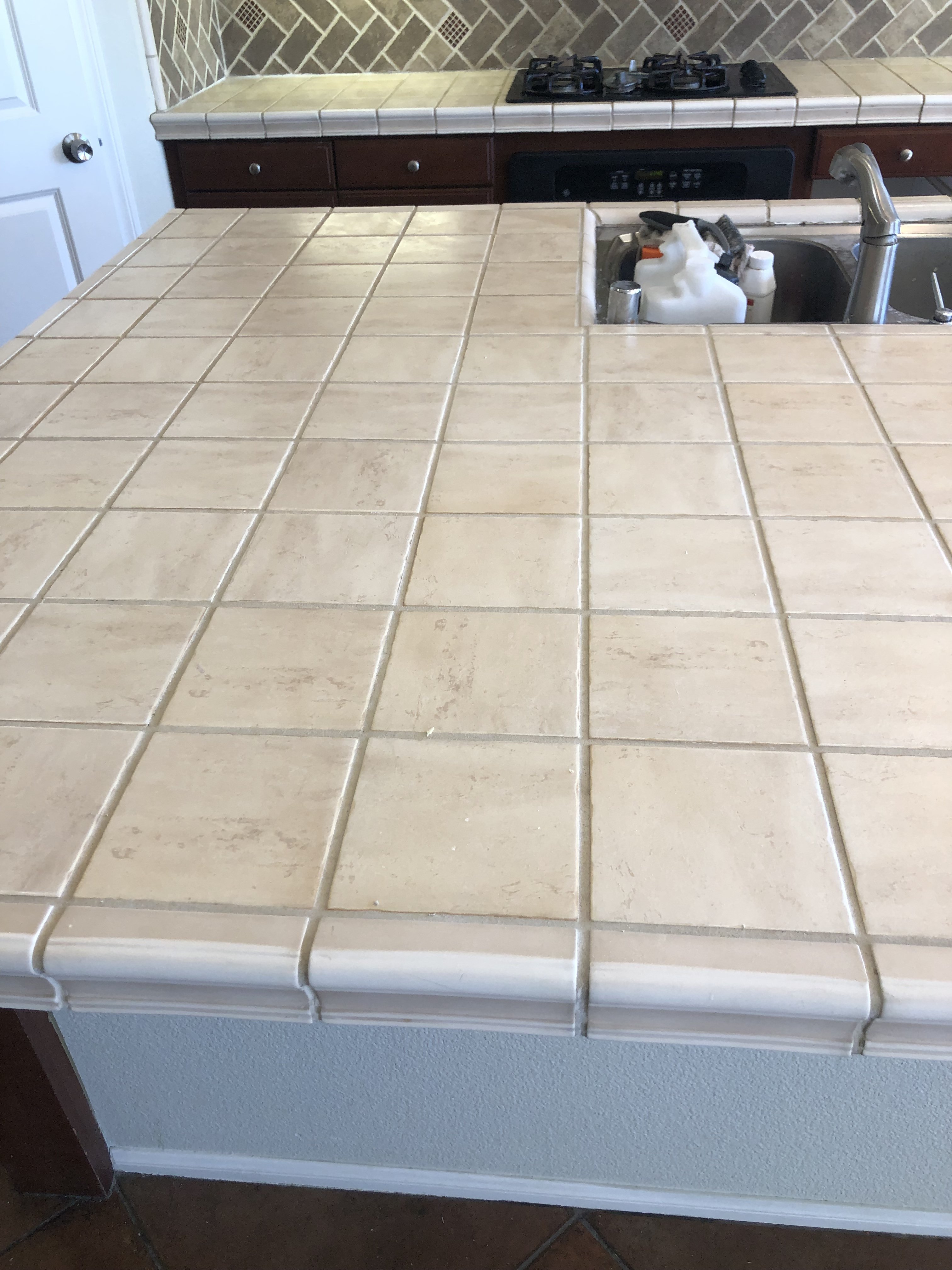

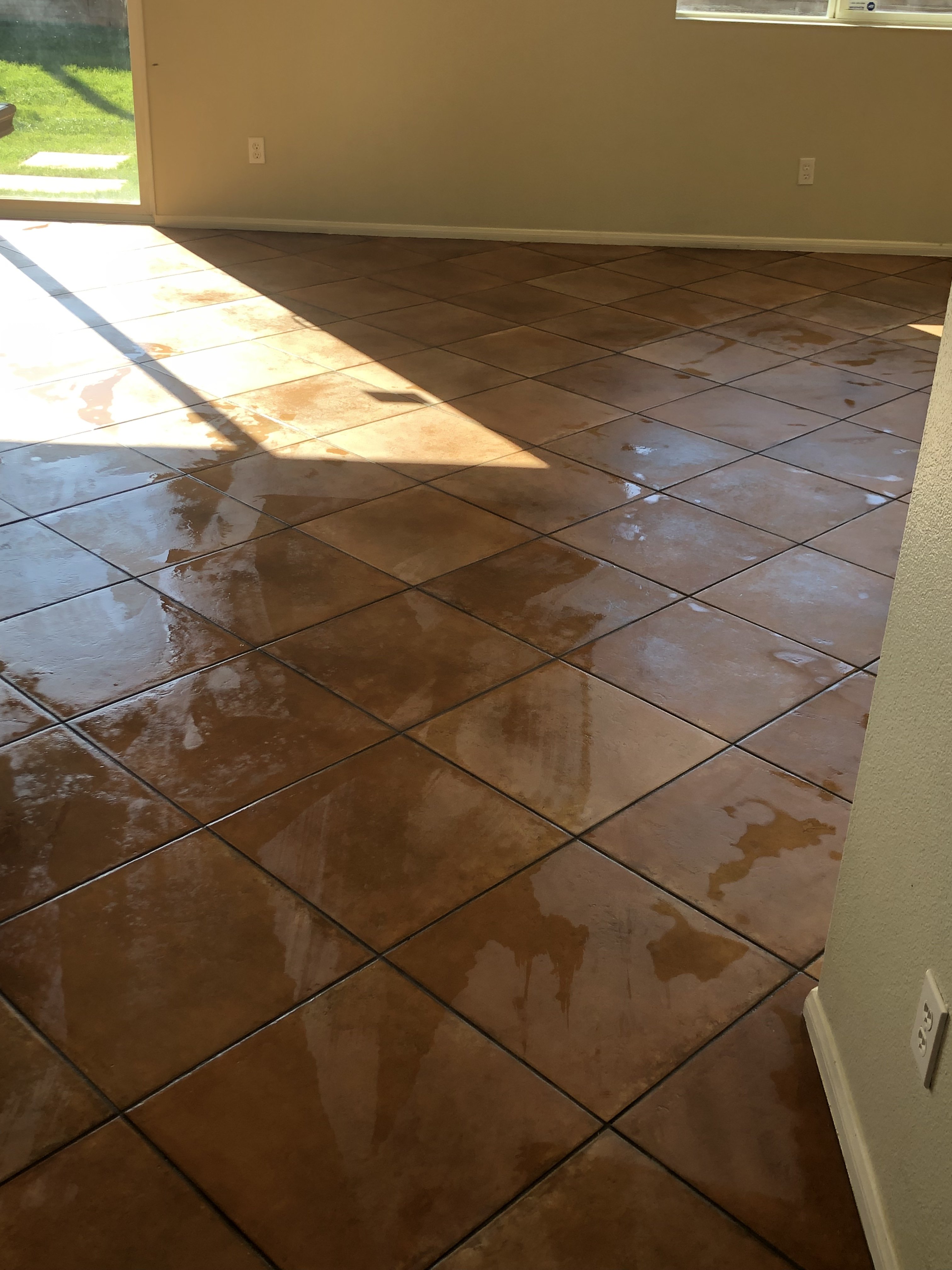

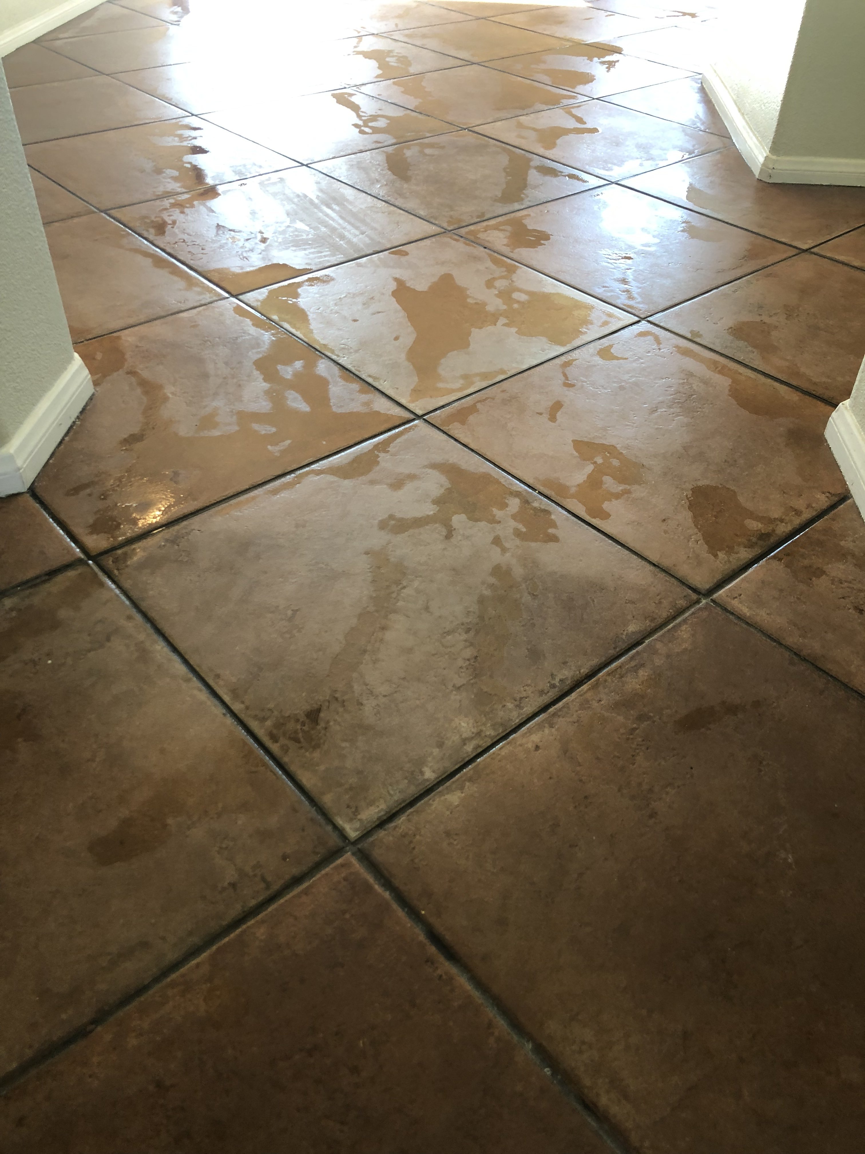

Came out really good, Damon was right a lot of work!
The tile appeared to have a little topical.
I didn’t have a vibe or 175.
So I mixed Saiger’s tsunami, with the rest of my sample stripper from stone pro.
And flooded it and used a crb with Black brushes.
It improved a lot.
