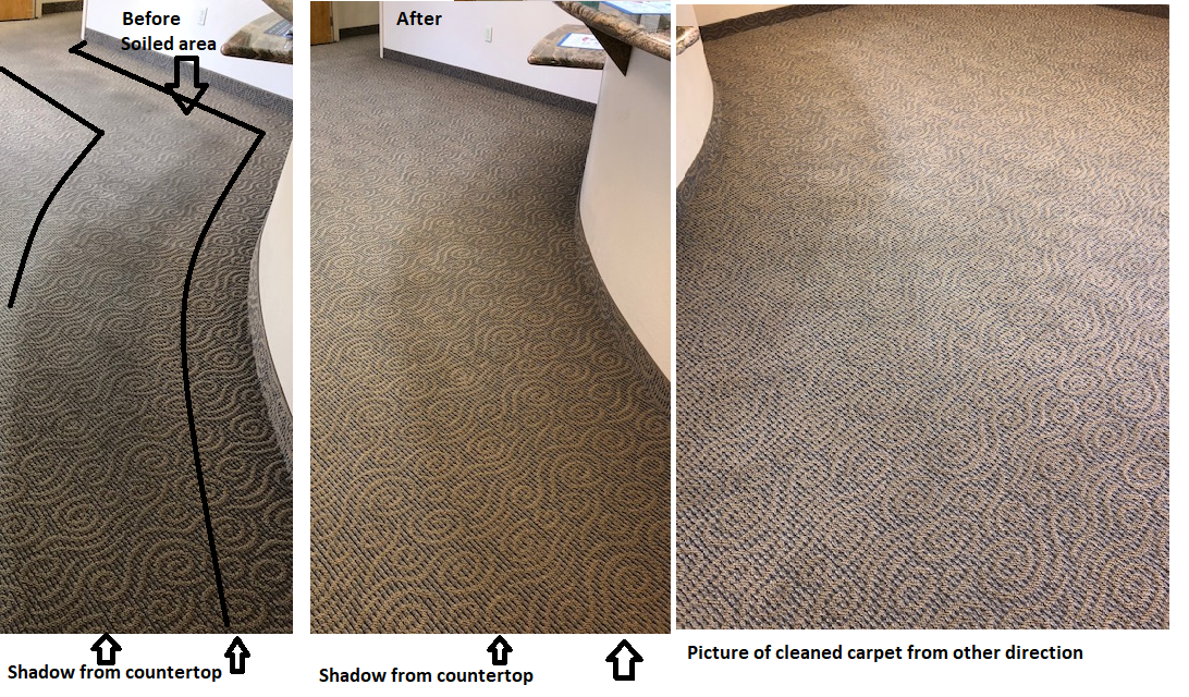

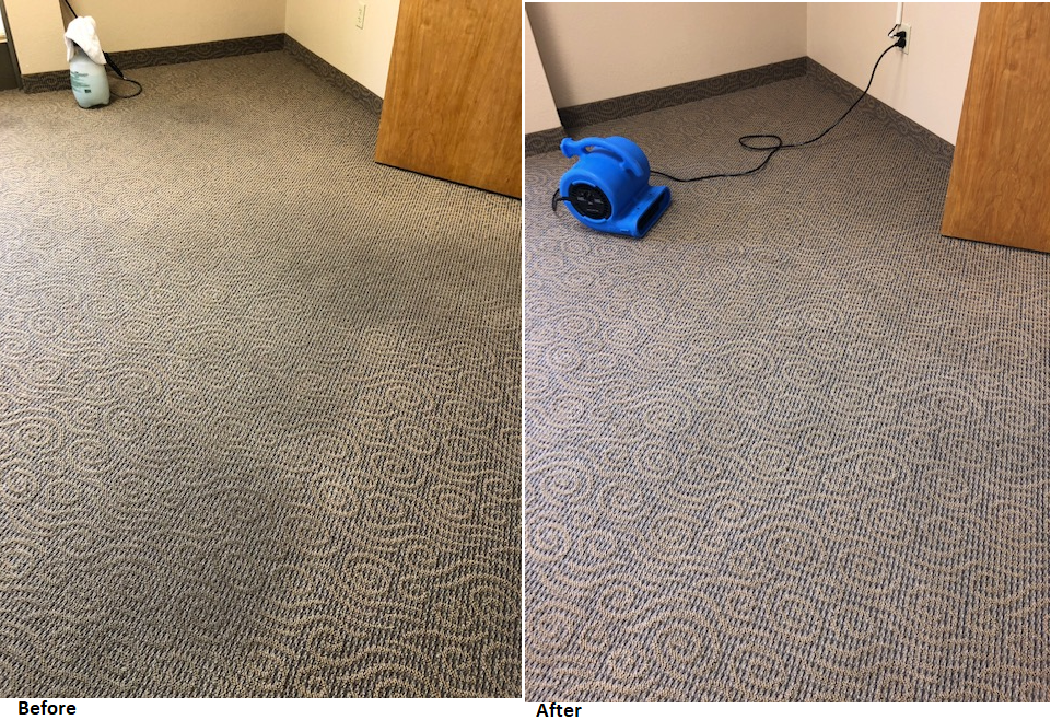

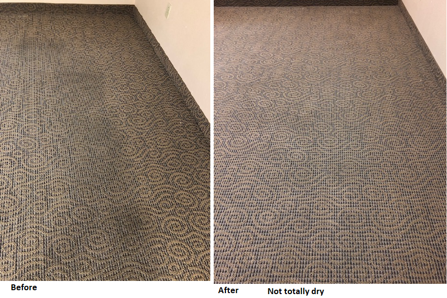

This is b4 and after from Trinity on CGD I did today.
Dark areas on after areas hasn't dried completely. I'll go back when I get a chance for a dry pic.
