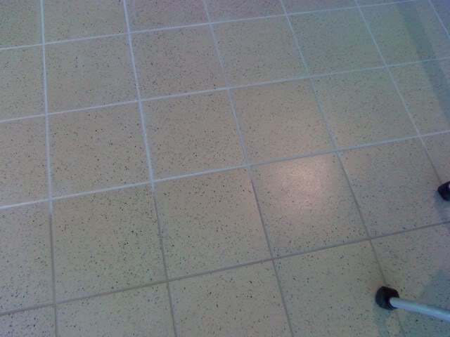

How's this look?

It does look that way don't it?
Best thing about this job is you just know Jose is gonna murk it up real bad with his mop.
I'll be HWEing it twice a year I bet.
D
damion68
Your not done with that yet????
Seriously, nice work. What is the total sqft?
