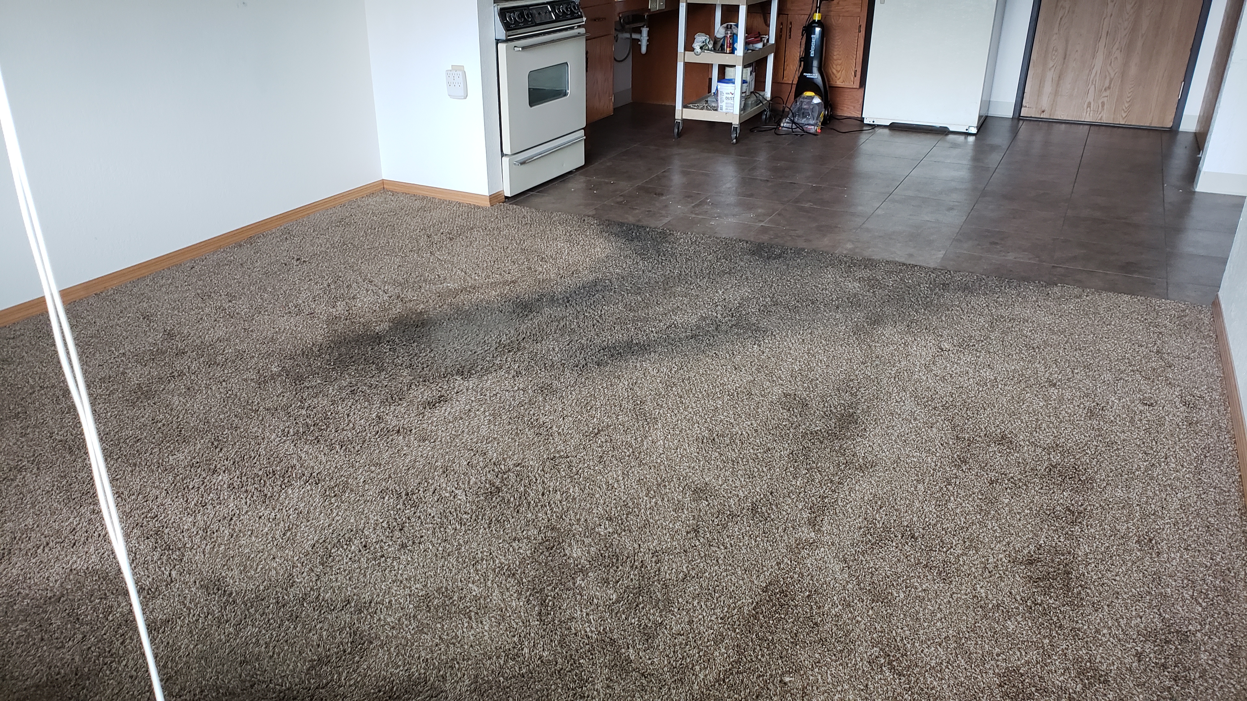

There are a couple of schools of thought on Smartstrand, or PPT.
Its oil loving characteristics make it hold onto surfactants as well oily soils. If you aren't getting it in a grossly soiled state (good luck on that...), non surfactant cleaners like Cleanfree and Procyon products are good choices. The idea is that you won't be leaving another oily residue (surfactant) to cling to the fiber.
(No, an acid rinse won't do much to break that bond)
The other way is to just drop your high pH nuclear bomb prespray of choice on it, and use mechanical preconditioning tools or rotary jet extractors to help break up the oil bonds. Some find that olefin fiber preconditioning products work well here too.
Don't have "nylon cleaning expectations" with this product though.

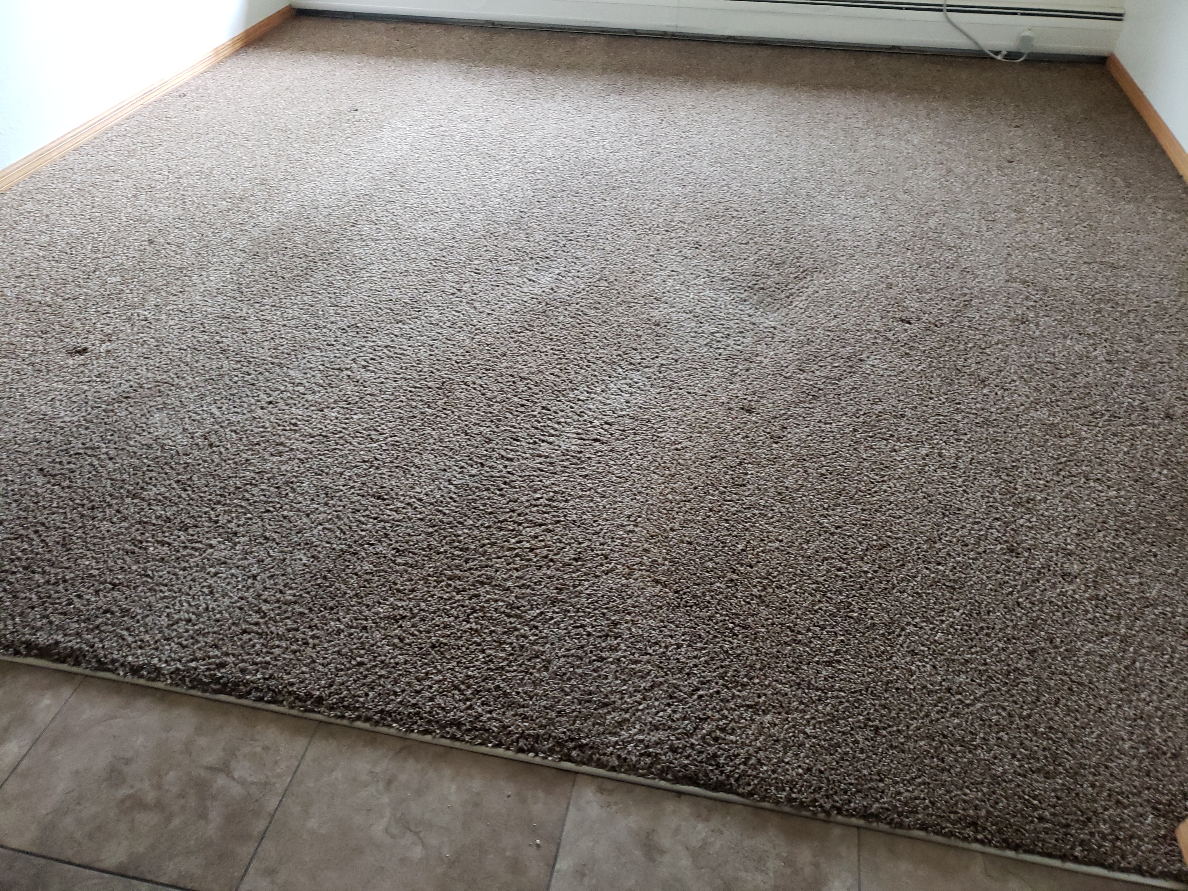

PET after clean
upstairs bedroom . Rest of the place looked new. Used to seeing this, unfortunately.
And also on this stuff , often chemical damage looking like pink/purple irridescence, not correctable.

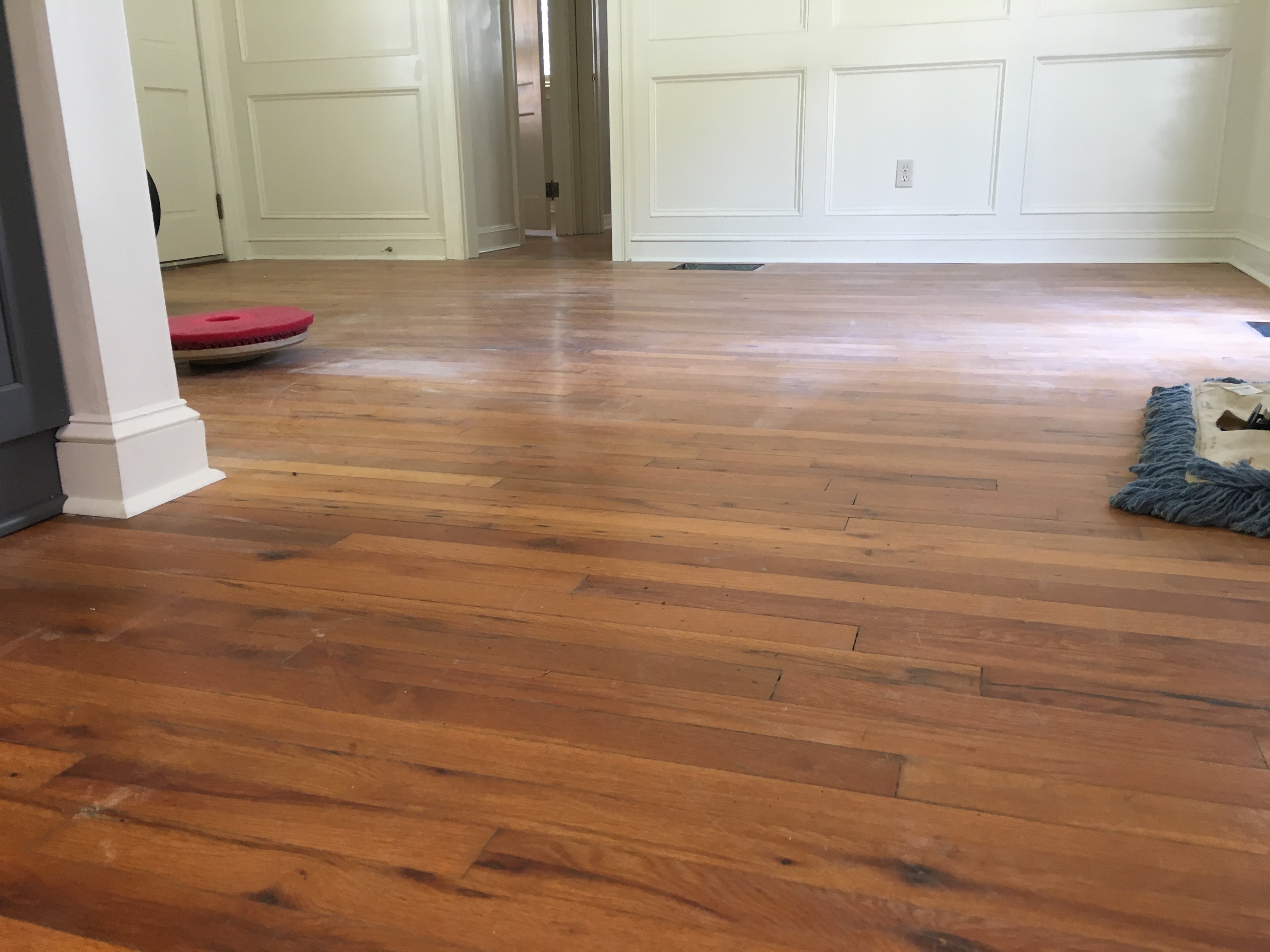

They’re pulling that crap up and discovering nice hardwood from the idiot baby boomer generation.
So I’m turning the average $150-200 3-4bedroom job into a $500-$750 hardwood job

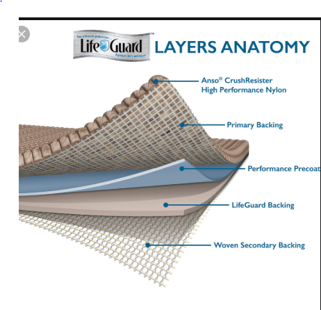

It seems some people, even some retailers are confusing P.E.T carpet with pet stain resistant carpet. I recently had a customer who was claiming he had pet proof carpet and that it had a special backing that prevented liquids from passing through. I pulled up a corner and it was just a regular backing. He was sold or assumed it was pet proof.
revitalize
May 20, 2016
59
adrian
The backing is Shaw's Lifeguard Backing which your customer didn't get.

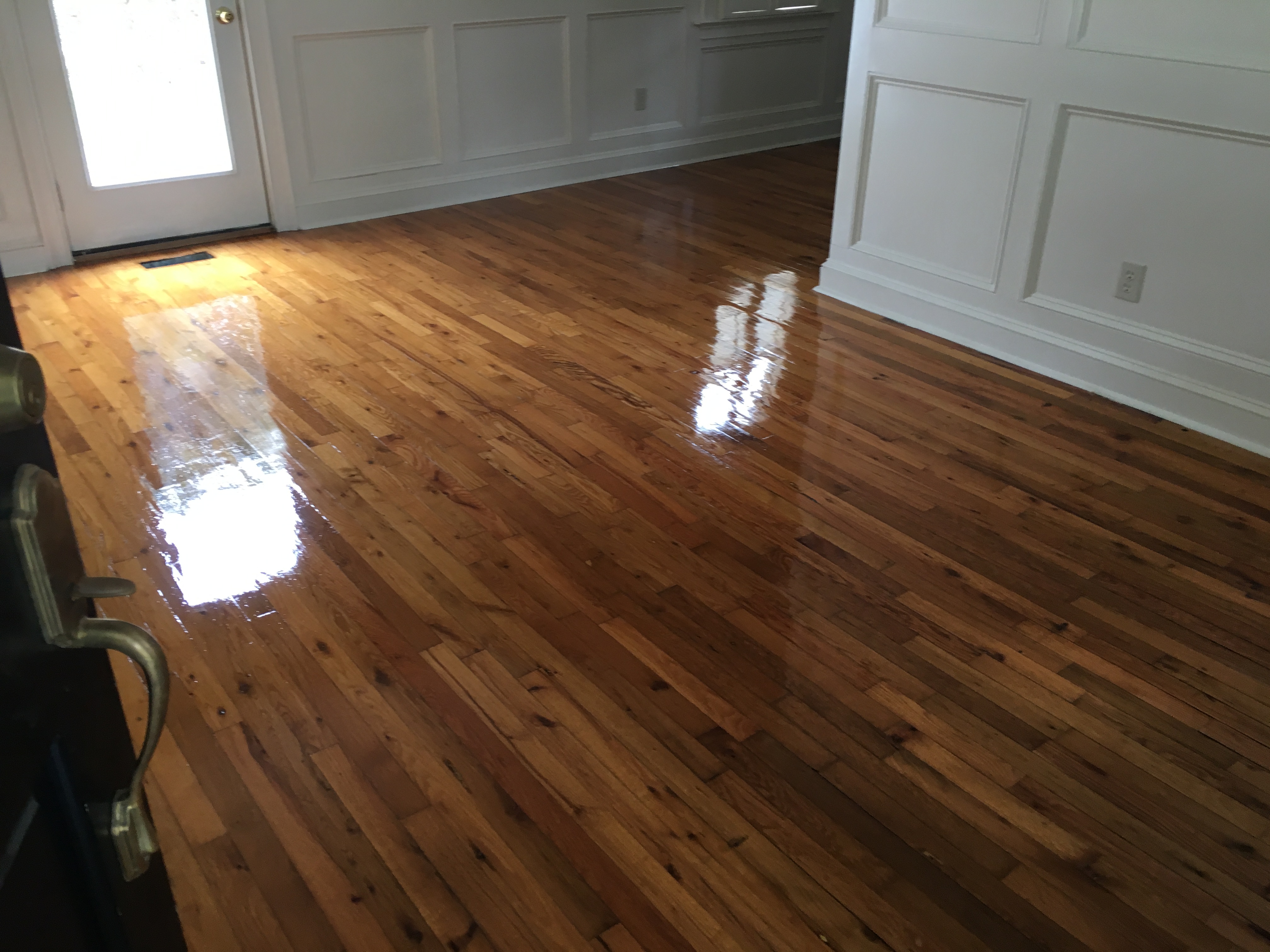

The dirt dragon fills tackless holes too?
The dirt dragon was left in the truck on this job. The scratches were too deep to use the Tykoat method. I had to do a screening 150 to get deep in those scratches. No cleaning was needed. Just screen, tac, slap on a couple coats of finish
