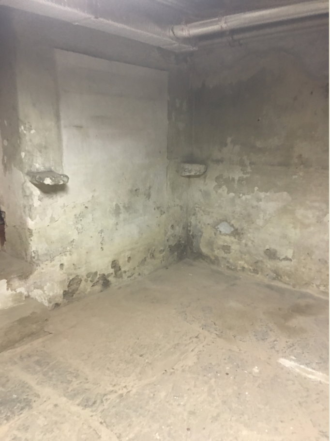

There has been moisture in the area and the walls show it. The want them cleaned and prepped for the painter. The homeowner "doesn't want to pay" to have anything done, so it will fall on the designer. We are willing to work with the designer as we see the potential for ourselves. But, as you can see from the pictures, the walls are flaking and chipping....(it adds to the character right?)

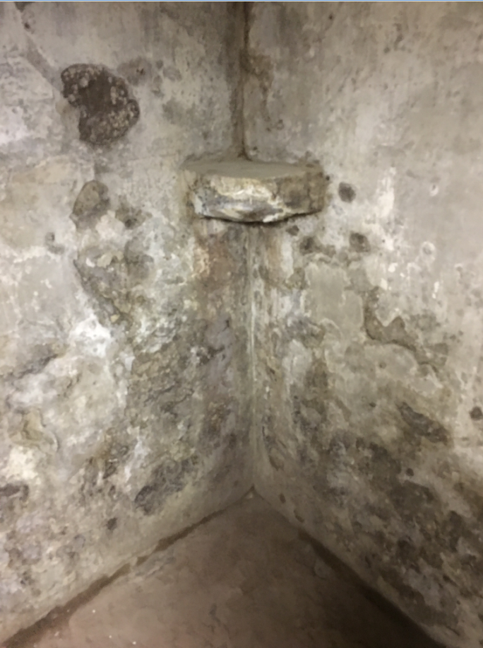

Some of the worst molds are those that stay wet over long periods of time continually. That wall looks as if it could easily support growth.
With moisture getting behind the paint it will be difficult to get the new paint to adhere. For paint to adhere it needs to be dry and clean surface. Rotz of ruck!
Soda blasting would clean it up enough to get paint to stick provided its dry enough. Although it has its own issues with cross-contamination and clean up.
If you do the work I suggest treating it as a mold project. Containment, critical barriers, neg air and HEPA vacuuming.
Control what you can see, as well as what you can't. This way nobody can accuse you of not controlling the spores.

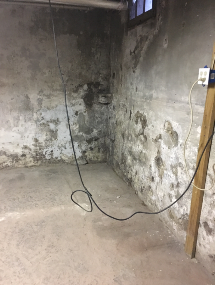

I cannot tell by the pictures but is it really mold or is it efflorescence from moisture coming into the basement through the Morter? It can sometimes look like mold but it will always be chalky white to grey, it is the calcium being leached out. My house is over 100 years old and I have it all over the basement. It starts behind the paint and bubbles up cracking/removing the paint.
Reactions: Desk Jockey
Jeremy you are probably right.
A lot of it could be efflorescence. The concern is that without testing you can't see what can be harmful. Mold spore are so small it would only be a guess without testing. A risky guess.
Unfortunately testing from a CIH is not cheap. It could be $600.00 - $1200.00 just to find out.

Meg, that one wall backs up to the grade and is being dampened by groundwater outside the rock foundation.
For an event, it can be made to work. In my home I would first spray a mildewcide, then lightly scrape the effloresence. Take thenormalprecautions against airborne particulates, spores, silica dust and so forth.
The stucco is loose, so be careful not to do more damage than necessary. Then whitewash all surfaces with waterproofing, or foundation sealant. When air dried, it can be painted with latex and will last about six months before breaking down again.
I'm not sure how you make money on this. In fact, the painter should deal with all the prep work.
