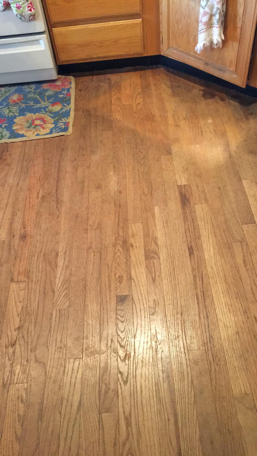

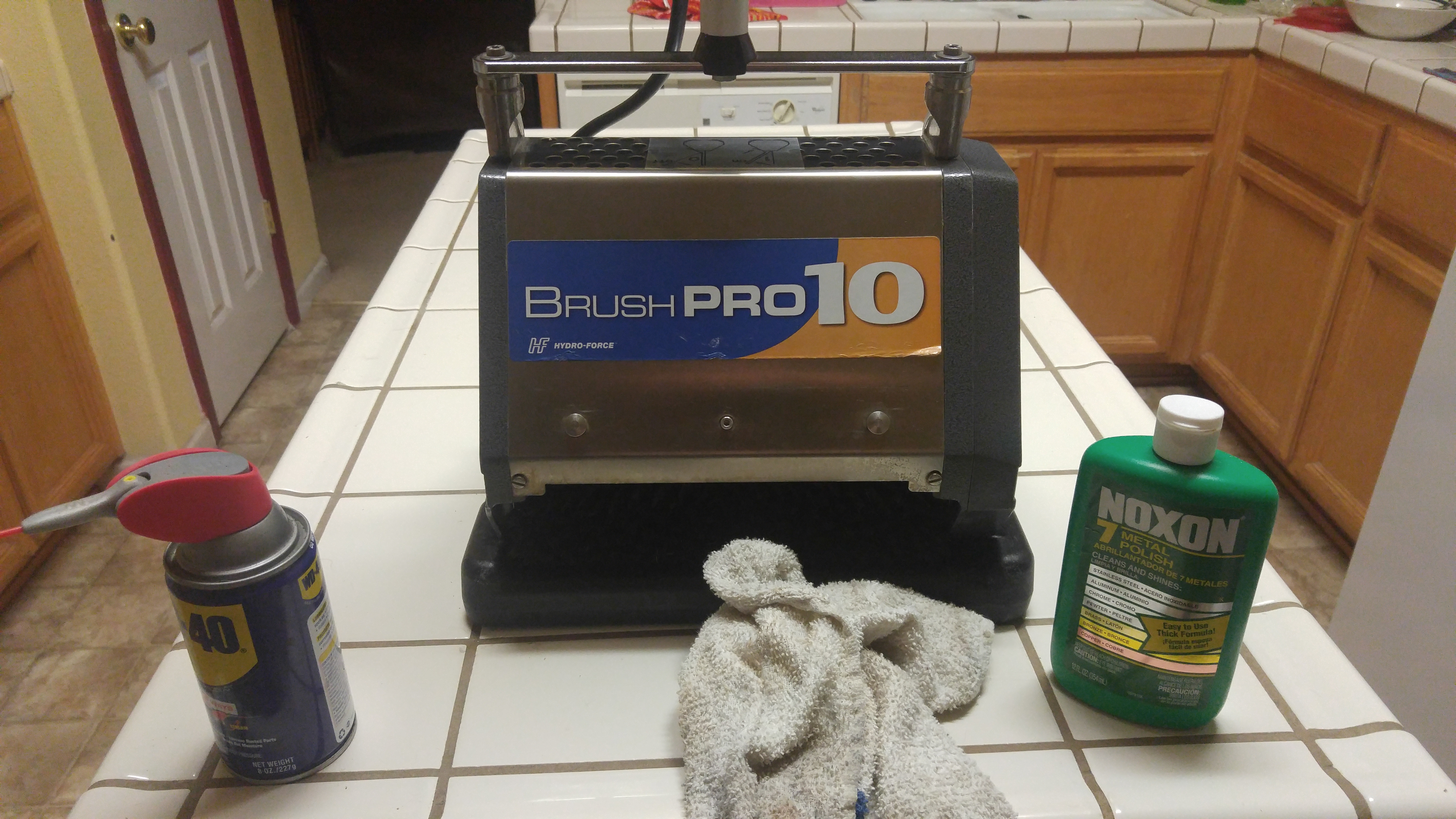

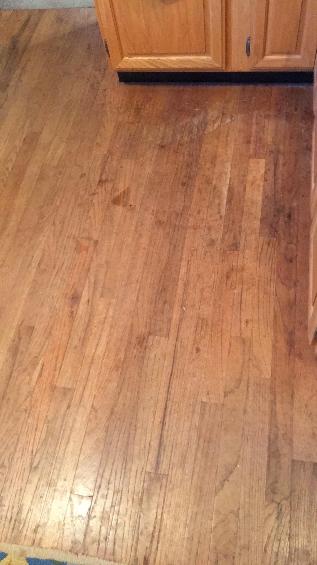

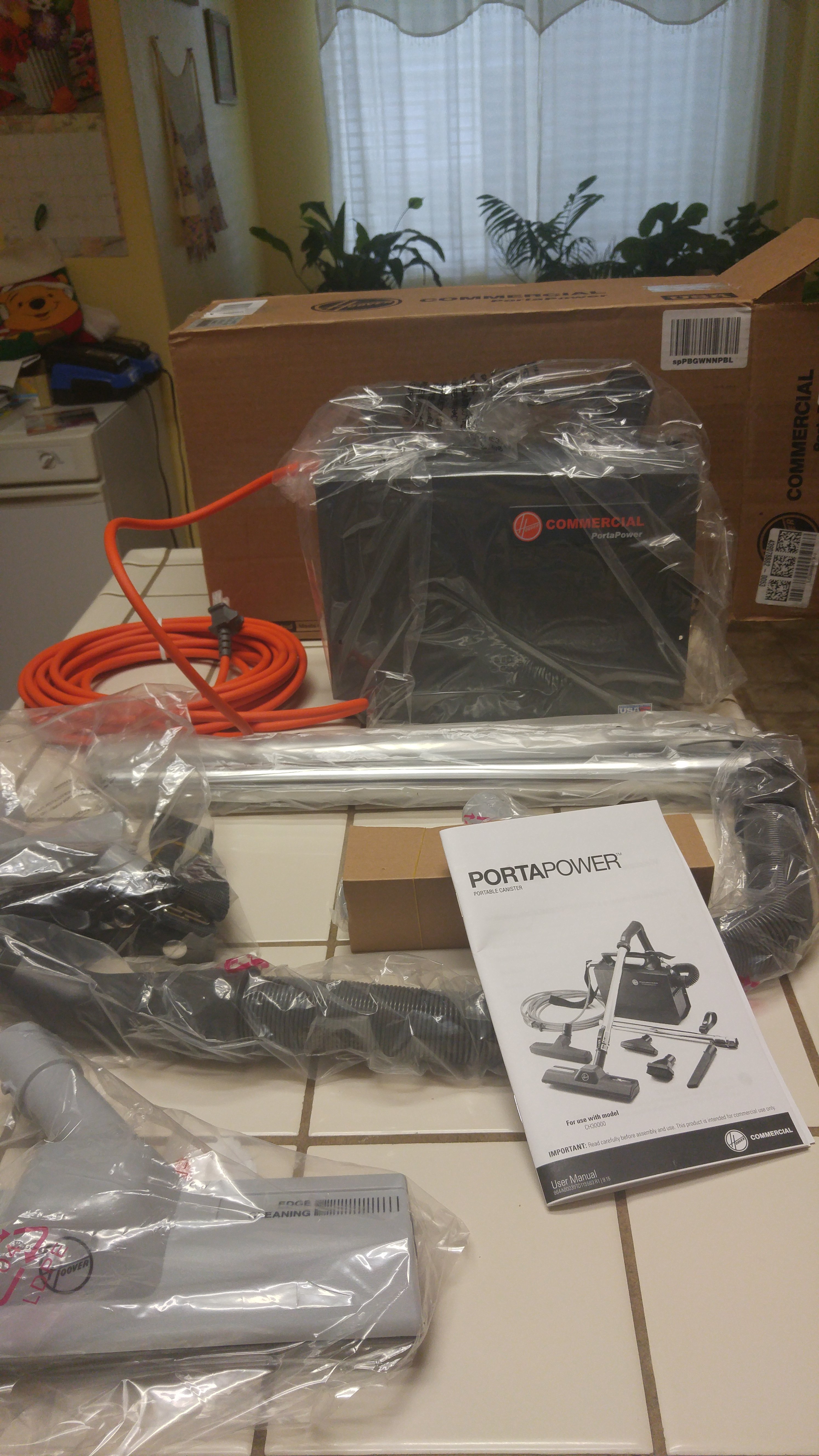

Well I'm on board. I bought the natura dri whatever the name is. That name needs work by the way for search engine benefits. I'm doing my first one in early February. I'm not looking to restore anything. I want to clean easy cherry picked floors to prevent the need of a restoration process. I've been cleaning carpets for over 25 years. I'm pretty confident in my abilities and judgement when to cut bait on a job. Without getting too complicated that's what the immediate target customer. I don't have a wood guy I trust or know but I will seek to build a relationship with one. I'm inexperienced with wood but I pulled a bunch of them while working at Serv pro. I'm going with the compound, my Brushpro 10 and my awesome hoover porta vac thing. I'm finalizing a quote on my liability insurance so I'm holding off any wood jobs . Instead I started a free 200 sq foot of wood floor cleaning. It's just for the members of the private fb group ...I have 5 entries so far. It ends Jan 31st. It's all neighbors and people I know around my small community. I'll have promo footage of my own pics, videos, comments and the names of the customers that didn't win. As long as I don't screw it up I'm good.
