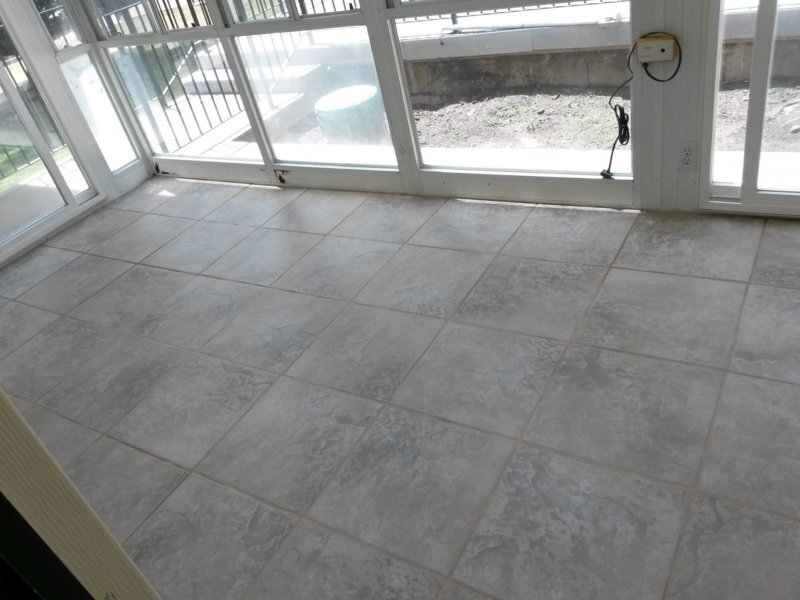

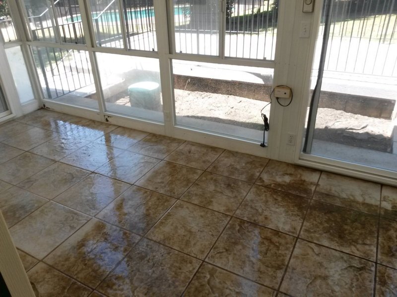

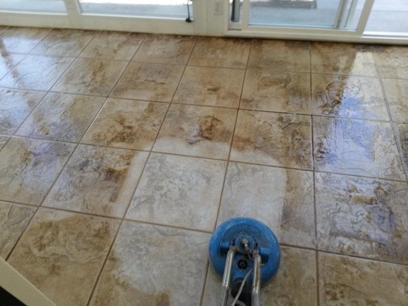

30 year old plus tile grout never cleaned professionally. Used "snake oil". Prespray dwell and set up. Tried using tile spinner alone. Oh I mixed it on the strong side too. Wasn't happy at the results. So redid it. This time scrubbed with crb and shark tool. It did clean up really good. But it needed scrubbing. Most of my tile jobs do. I used to use the 360i tile head which is a brush and does a good job because you're scrubbing as you're cleaning. But the crb/tile spinner is still faster and does a great job. I did just order a new cleaning chem to replace my snake oil. I think it'll be better we shall see. But I'm planning on still pre scrubbing my tile and grout.

Looks great, Ross. This pic was CRB only? Being the hack that I am, I have to ask:
Is the spinner necessary after this?
Hey Damon, thanks for your comment.
To answer the point of your question, no. But it is the easier most efficient way to extract.
You could used a glided wand, brush wand or I guess a mop and bucket. But a spinner is the way to go.

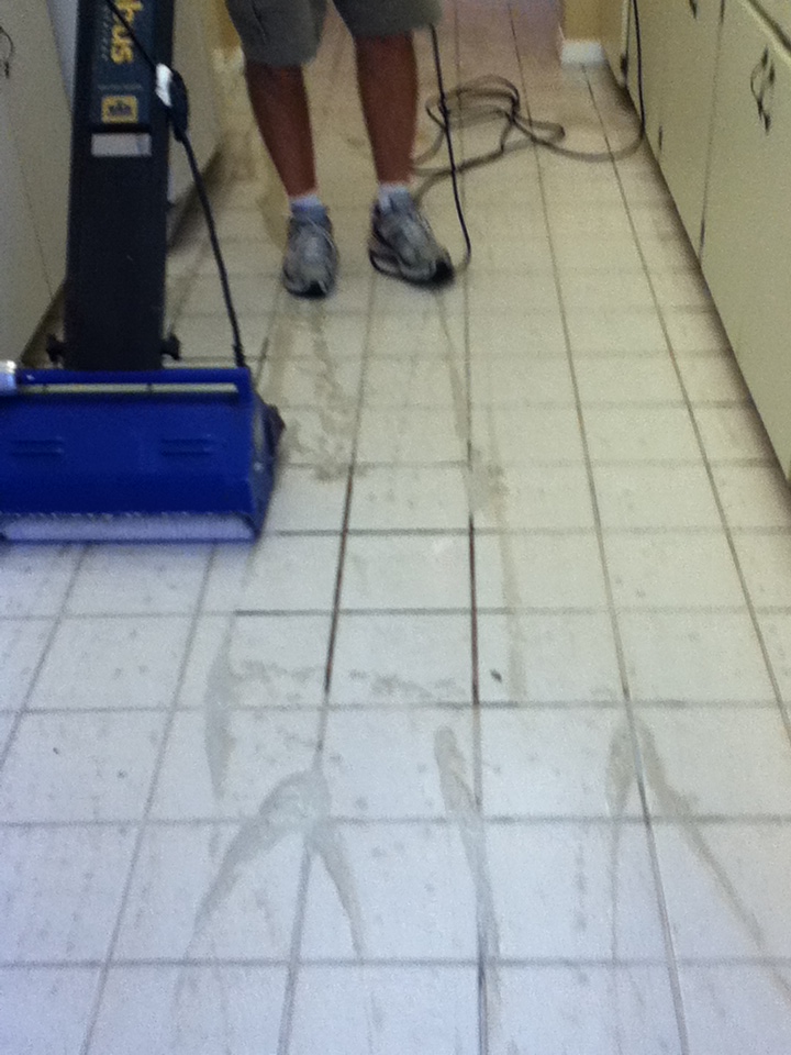

We do this. Oh that is the customer trying it out, hahaha! Great guy and a friend. Notice the dirty tile beyond him.
