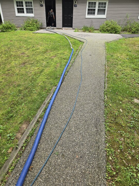

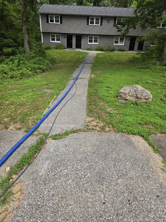

I personally don't have any on my van but they're on my list for my next wanders order. I live in the country and dont run into manicured lawns as as some cleaners do. When i do i at this point lay out 50 exrta feet of soulition hose. Where i live believe it or not alot of multi million dollar homes have gravel driveways but there are those times where a couple of sets of these would come in handy. But i would think you still have to be sure that the slight pulse of the pump doesn't make the hose sag and still burn the grass. I did however many years ago loose a good customer because i burnt a bright yellow strip down there brand new sod lawn
I've already noticed a few spots we've been at where we'd have to cut the heat once it is fully functional because there would be no way to avoid laying solution line on the grass. Those stakes look sweet. I'll keep em in mind!
14,249
Grass is not your enemy. Ok, fancy rich people grass is, but I haven’t found a need to buy those yet
Your real problem with your hot hoses will be those squiggly black lines on an asphalt parking lot. Your hoses will melt that asphalt and it’ll melt on your hose. And if you bring that mess in a home, it’ll burn itself on the carpet/floor. That’s a real problem
