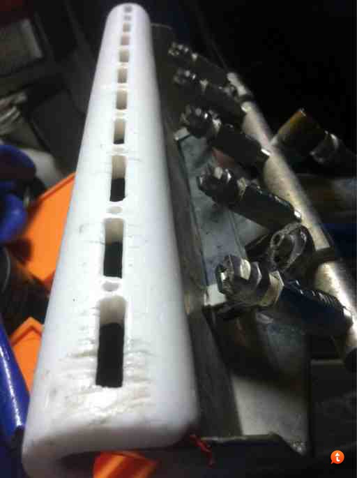

G
GCCLee
I gotta do everyrhing?
This thing was all hole and it irritated me so much I kept kicking it off an throwin it back it the truck. So i sent it off to be hacked on. Much Much Better.
I could use a 12" scratch one now : )
Sent from da middle of a Trailure park
ruff
Apr 19, 2007
11,010
Ofer Kolton
And that's when its sent from the "middle of the trailure park"
Imagine how it would look from the double wide :winky:
Good picture.
Funny endings though Chris.
I like your latest endings.
