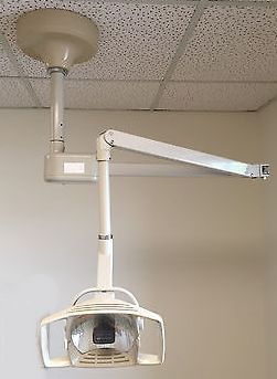

My new one will. Larry, what would be the look and design of your dream room?
It would have hi-power UV lights like a dentist uses, mounted on a movable track.
When necessary, you could push the light up or pull it down to examine the rug closer.

Fancy! More for show? Hand held likely will continue to be fine for me.

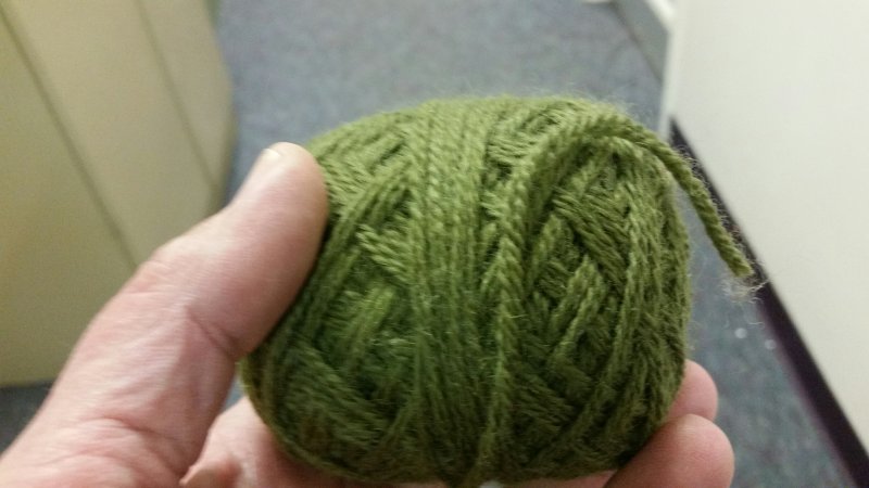

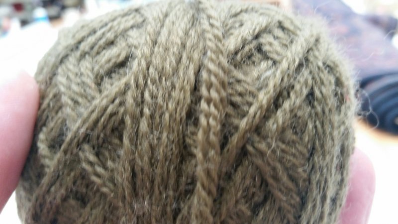

You may want to make sure that your lights have a high CRI (Color Rendering Index). Our repair area has florescent lights that have a 90 value, while the general office lights have a 70 value. The higher the number, the closer to true daylight it actually is.
We have a spool of yarn that we use as a demonstration of the lighting. In our office area, the yarn is a plain brown. In the repair area, it is a khaki green. It had caused us issues in the past before we got the 90 value lights. The yarns used for repairs looked great in our shop but looked terrible when viewed at the customer's home.
We got a lot of assistance with this from our local lightening supplier. We also got some substantial government incentives when we switched all our lighting to the newer electronic ballasts using the T-8 bulbs.

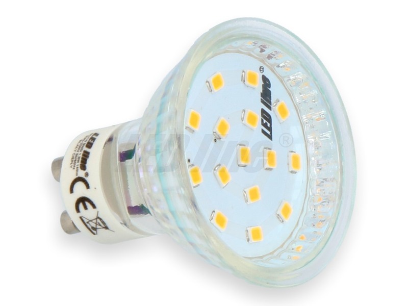

My shop is quite small and I have overhead florescent lighting. To eliminate shadows, off to the side I have a bank of 4 500watt halogen lights. The kind you will see in autobody shops. The problem with these lights is they take a lot of power and they burn out quickly. I was at Home Depot and picked up a Led equivalent to my halogen lights. Takes a lot less power and gives a whiter light. I am going to replace my halogens with all leds.

Here's an example of lighting...
Same spool of yarn, same camera (actually my phone) and same settings on the phone. The first picture was taken in our repair room, the 2nd in our office. The funny thing is the camera changed the color too. In the repair area the first picture was brown. In the office it was closer to the 1st picture in color.

What would happen if you used the flash on a low setting? What should happen is the color should be more correct and the image should have better focus. Not sure what camera you are using though...so yes it's lighting. HDR setting to auto and your camera/phone and colors should also get better.

I took the pictures without a flash. I wanted to show the effect that lighting has on perceived color and to add to the conversation about dry room lighting.
Sorry I thought you were showing the difference that a camera sees... the human eye/brain would not be fooled so badly. Old movie studios were essentially walls with removable ceilings for natural light. Lighting is all about LED's now. New lED Lighting mimics the sun.

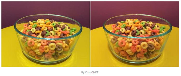

Quality LED's have CRI ratings also . . .
Standard LED's are usually deficient in the Red spectrum.
Here is a photo taken with a Cree LED with a CRI=93 on the right:
