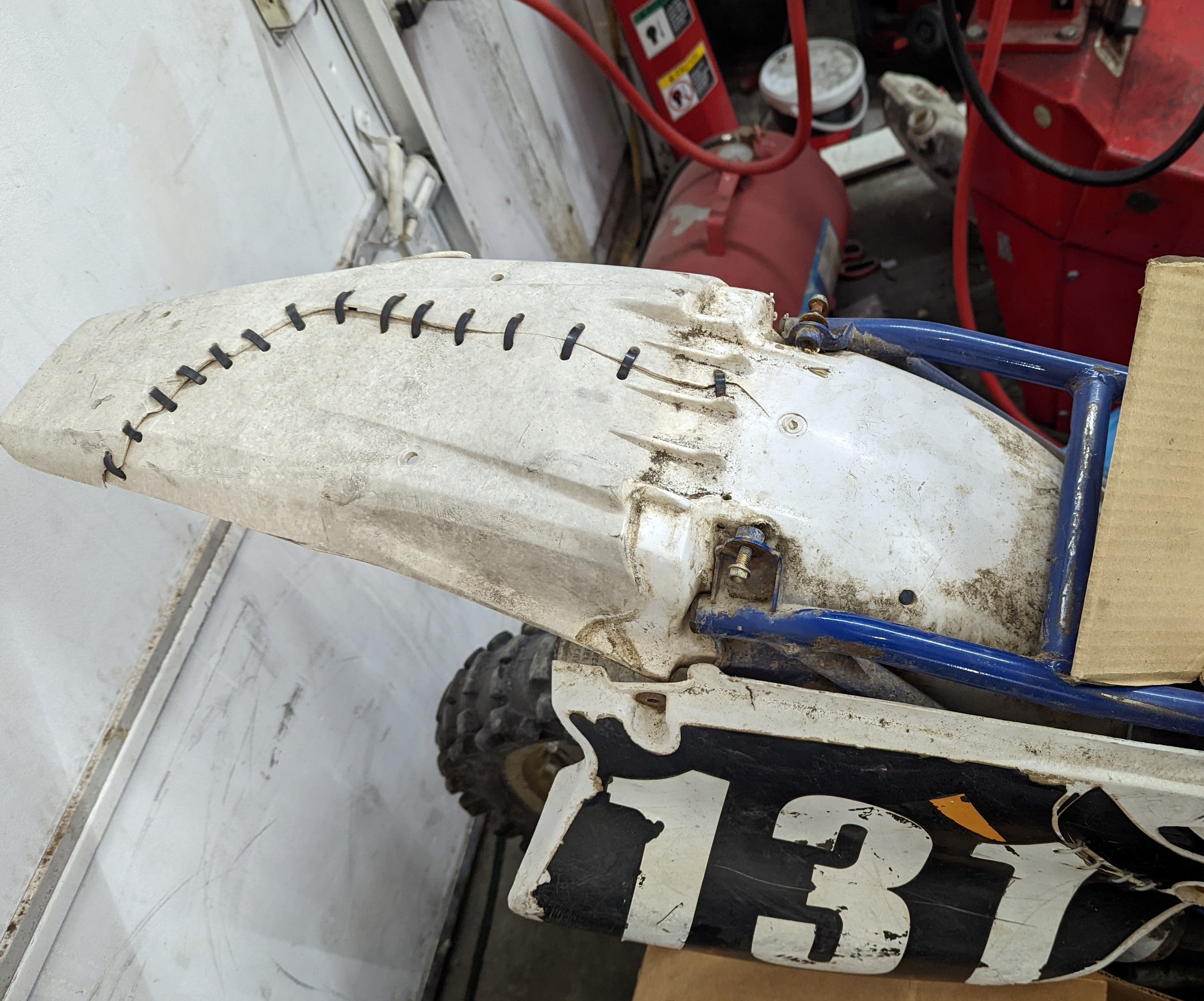

Have some fun with it. Use one of these.

My friend has one of these.. Works well for a lot of things.. You can get the cheaper ones.. It uses staples that heat up and you melt it into the plastic to repair it.. So far it's holding a bumper on a car, a proteam vacuum head, and a few other bits I've tried it on..
Amazon product
Amazon product
can confirm....used one to put the rear bumper assembly of my kid's car back together
