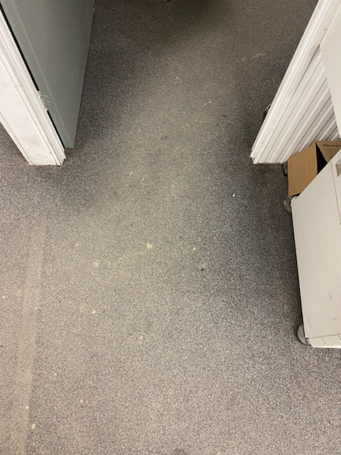

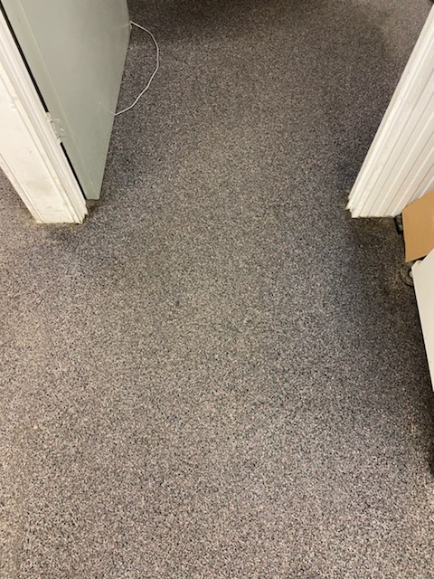

First time using dry compound, it was the austrian crb compound. Carpet was commercial olefin, bombed out and really in need of replacing. I was surprised at how effective it was. Sprayed down a light mist of peroxicap from groom solutions prior to spreading out compound. Maybe I spread too much but I spent more time vacuuming up compound around edges than I did with the crb, stuff seemed to get everywhere and I am pretty sure I missed some. Not to mention the time it took to clean up CRB. All in all, happy with results given the condition of carpet, smelled great but don't think I will make this an option unless they can not have any down time. Anyone use this stuff effectively in combo with other VLM?

I would have OP'd the carpet in the photo
