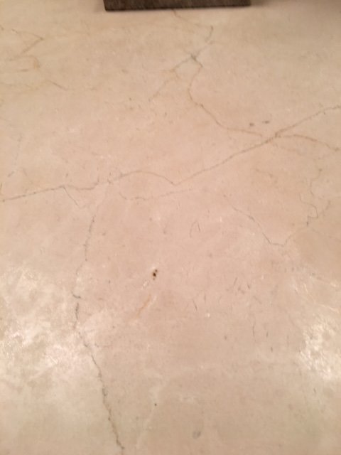

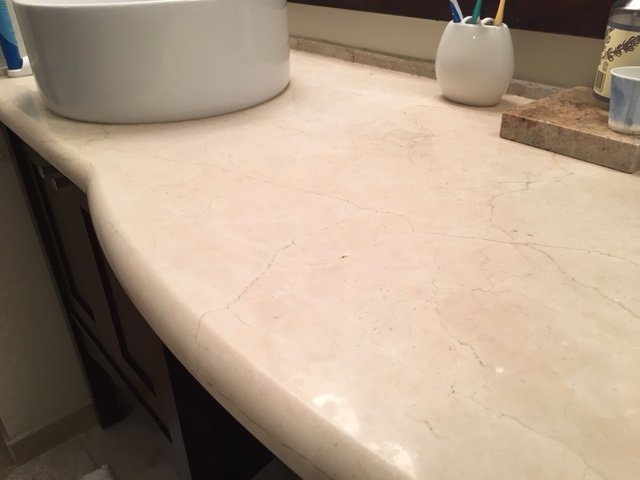

I have a client who has a marble vanity counter top that has lost its polished finish. Any suggestions on a simple way to restore it to its original sheen with a cleaning product? I don't want to get into anything complicated. The marble doesn't appear to be etched, just very dull looking as you can see in the pictures.
117,182
it's etched 98%.
400, 800 & EMP will be the easiest route.
There is no miracle (easy) fix for that mess.
Or coat it with VCT wax and hope she is 1/2 blind.

You may need to go down to 220 then work back up. Mike is right, you can go to 800 then EMP. You can also switch over to ZOOM DIP's at 1500 then work your way to 3000 then use Polish Pro or stay chemical free and go to 11,000 ZOOM pads.
