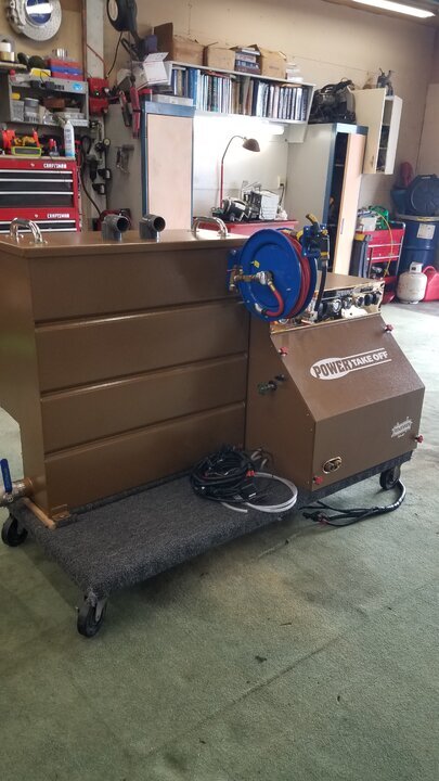

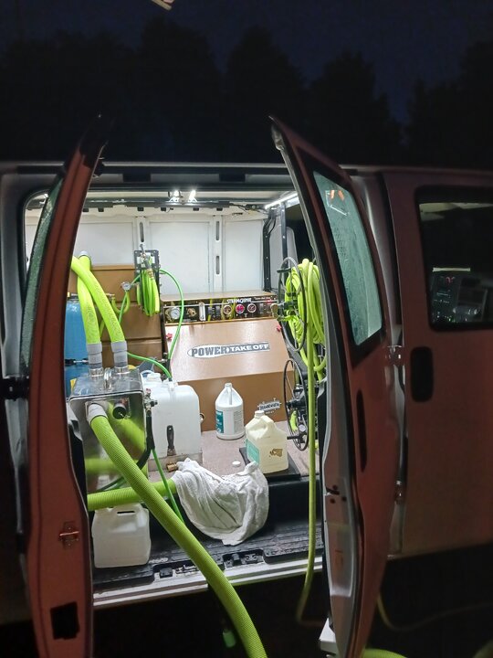

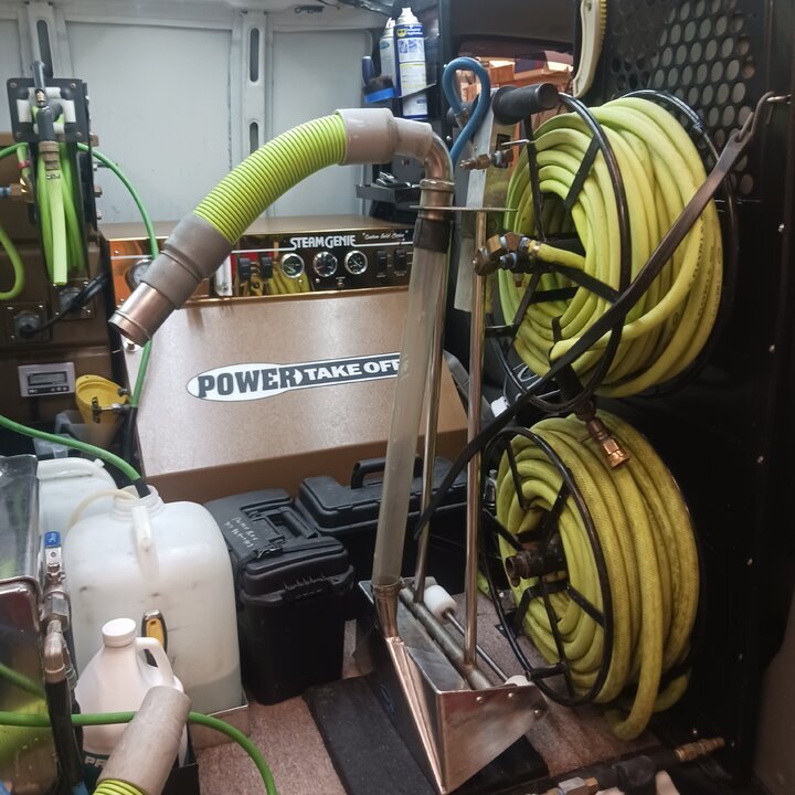

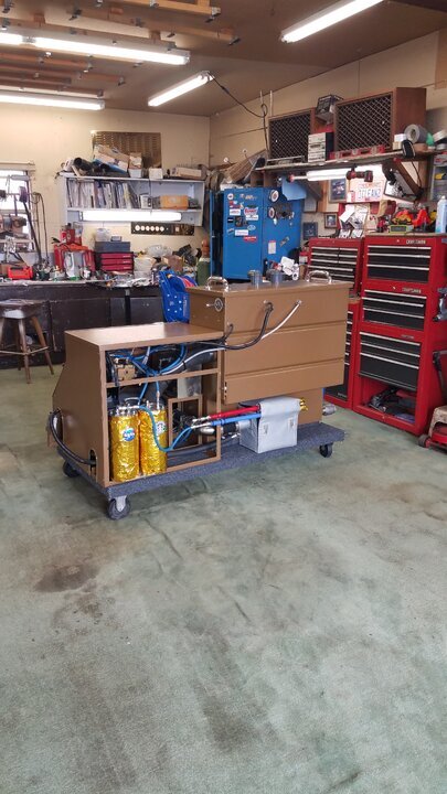

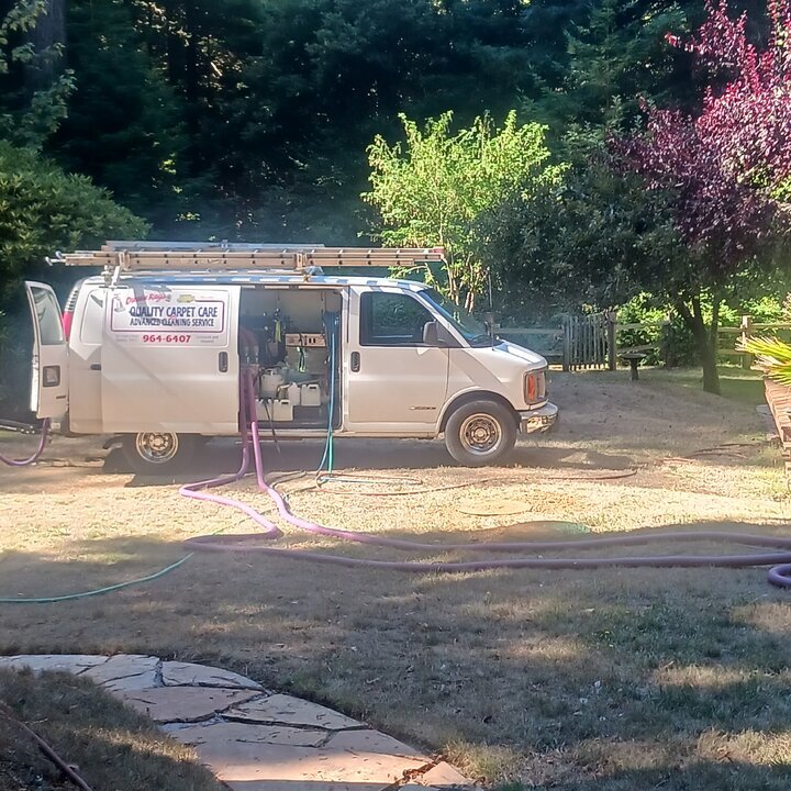

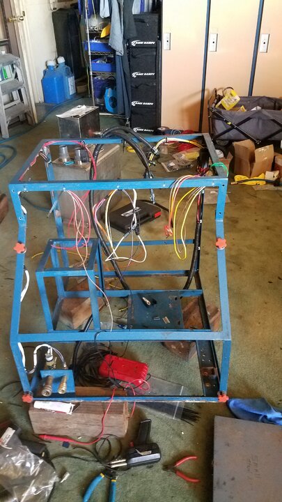

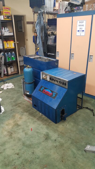

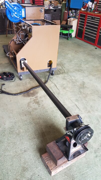

Ive found the old steamgeni pto's the easiest. You can see and reach every component virtually nothing is proprietary and you can completely tear down one with a screwdriver and a crescent wrench. There's a clutch on the engine, 2 bearings in the driveshaft, 3 belts on the machine a pressure pump (eighter hydra cell or hypro) a vacuum eighter a 45 or 47 small water box, heat exchanger and a simple solenoid for throttle. Chemical supplied by starvation. They generally last over 20 years and can easily out live the van below is a picture of my spare used it last week van is a 2000 3500 and has 201k on it and the machine is about to turn 11k hours. In 2018 i went to the Las Vegas trade show thinking i would replace it but the idea of replacing a perfectly good 19 year old machine with one with a life expectancy just slightly longer than the payment plan didn't set well with me. I went home took a 1998 steamgeni geni pto upgraded it slightly and installed it in a 2020 van. For about 10k less than the pos at the trade show and have soooo much more machine but thats me. My advice to someone buying a machine the acronym KISS comes to mind keep it simple stupid! And the simplest is probably the most reliableista
