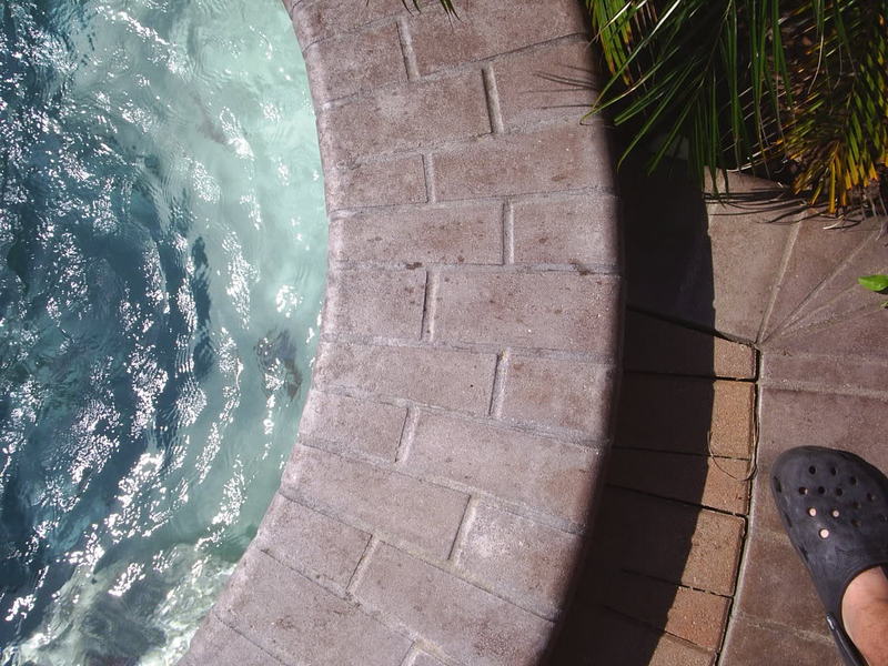

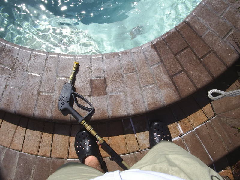

Are you SURE it is efflorescence (white and powdery) or could it be moisture coming up in spots where the grout was not entirely dry?
LIKE THIS..... :shock: Sealer was applied...before pavers were cured..... :(
