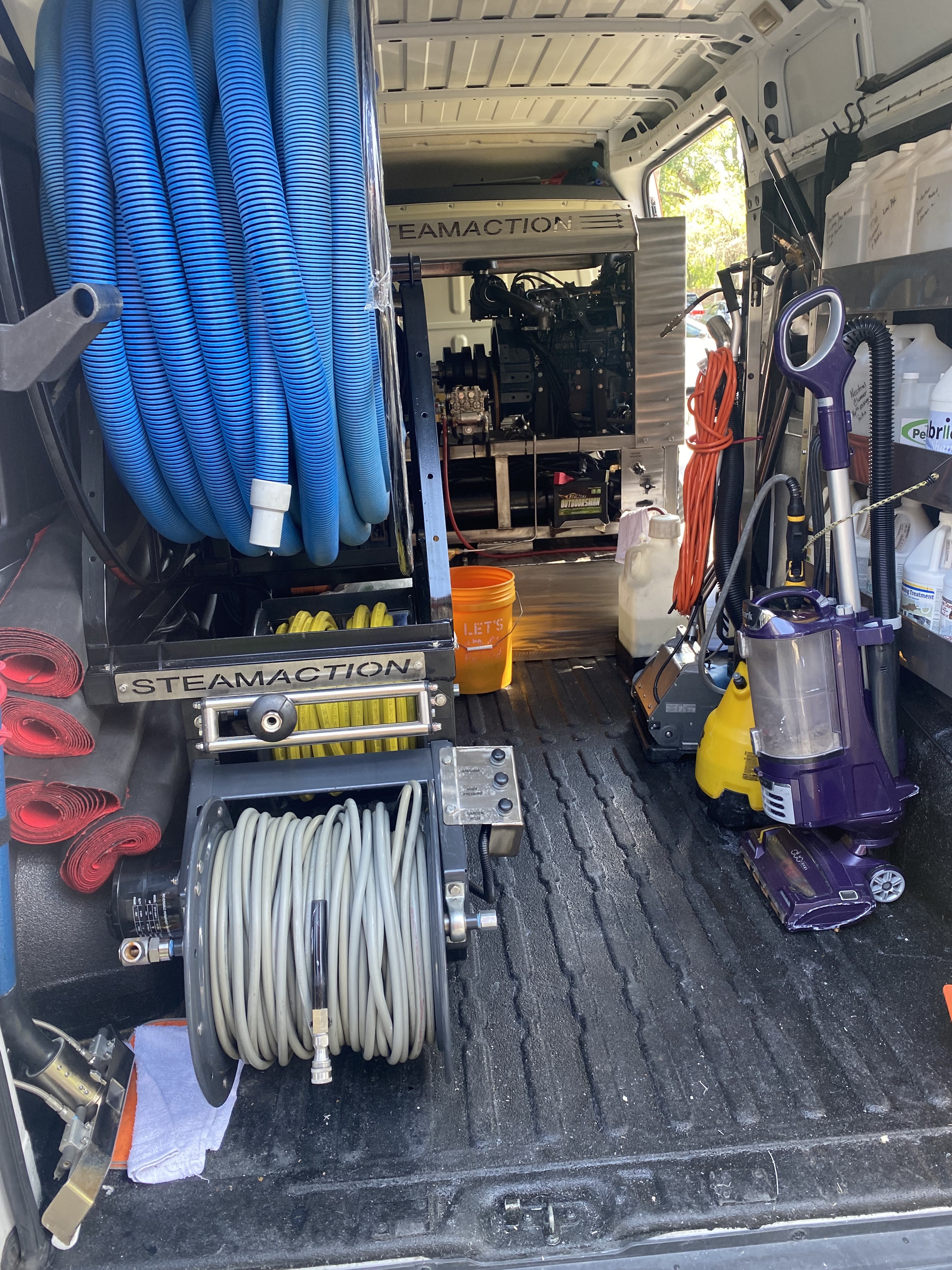

It's a must have for owner ops. You're wanding all day, the last thing you want to do when you're tired is roll up that vac hose. I waited 14years before I bought mine. don't worry about how much it costs. Just get one. The one from steamaction is the most impressive. And there's a dude in Atlanta that makes one similar. I can't remember his name. Someone on here can highlite on that. He made crappy garagemade truck mounts before he switched to hose reels

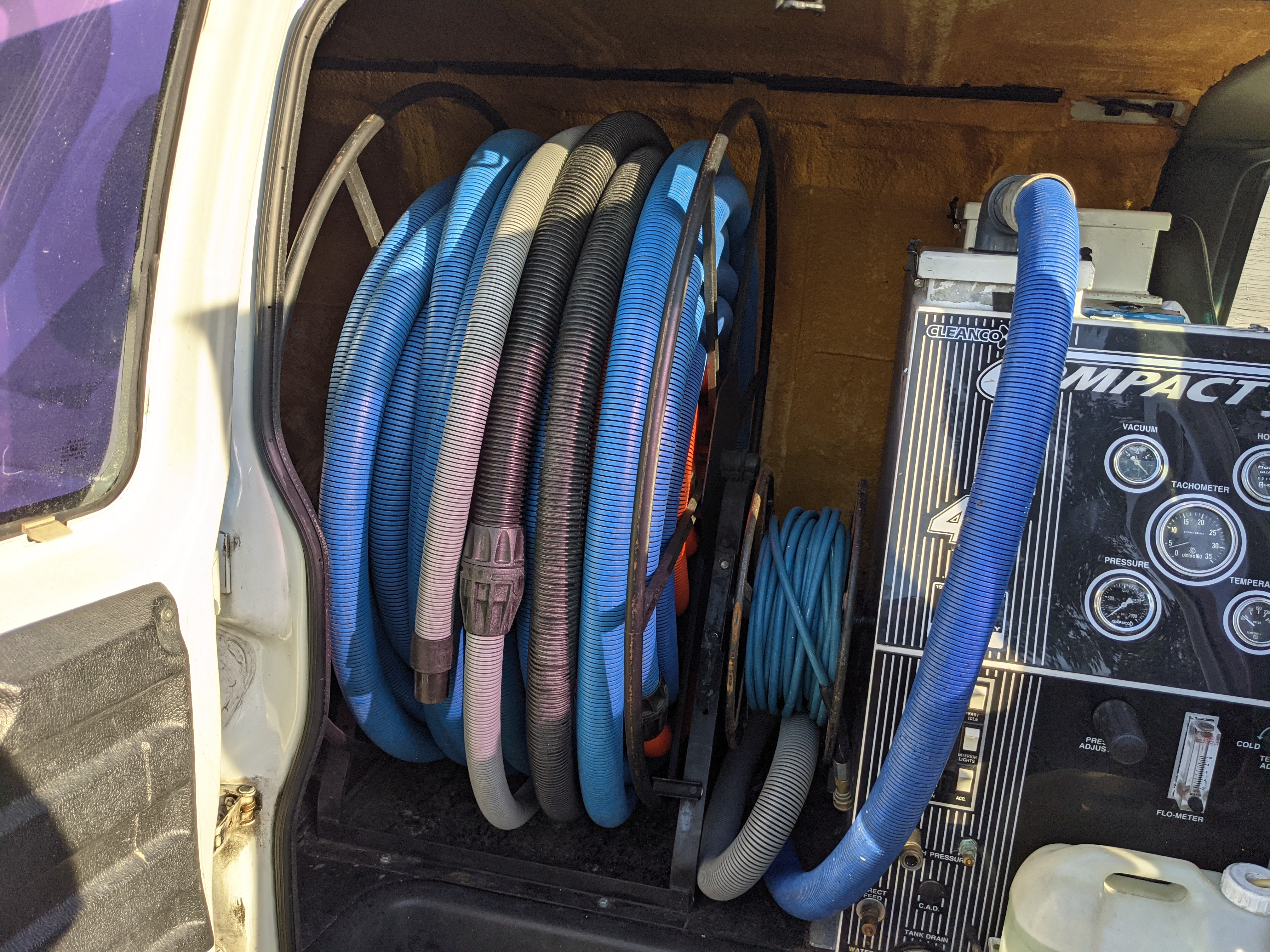

For a 20 year old van, it's in great shape. The reel is so easy to turn I don't need any help. Different if your reel is mounted deeper in the truck. One of the things to think about is, what happens if your electric reel malfunctions? Blows a breaker or fuse? How difficult is it now to manually roll up your hoses connected to an electric drive motor? Can you easily disconnect the motor from the reel?
14,268
Disconnect the belt and it's just as easy as a reel without the motor.
