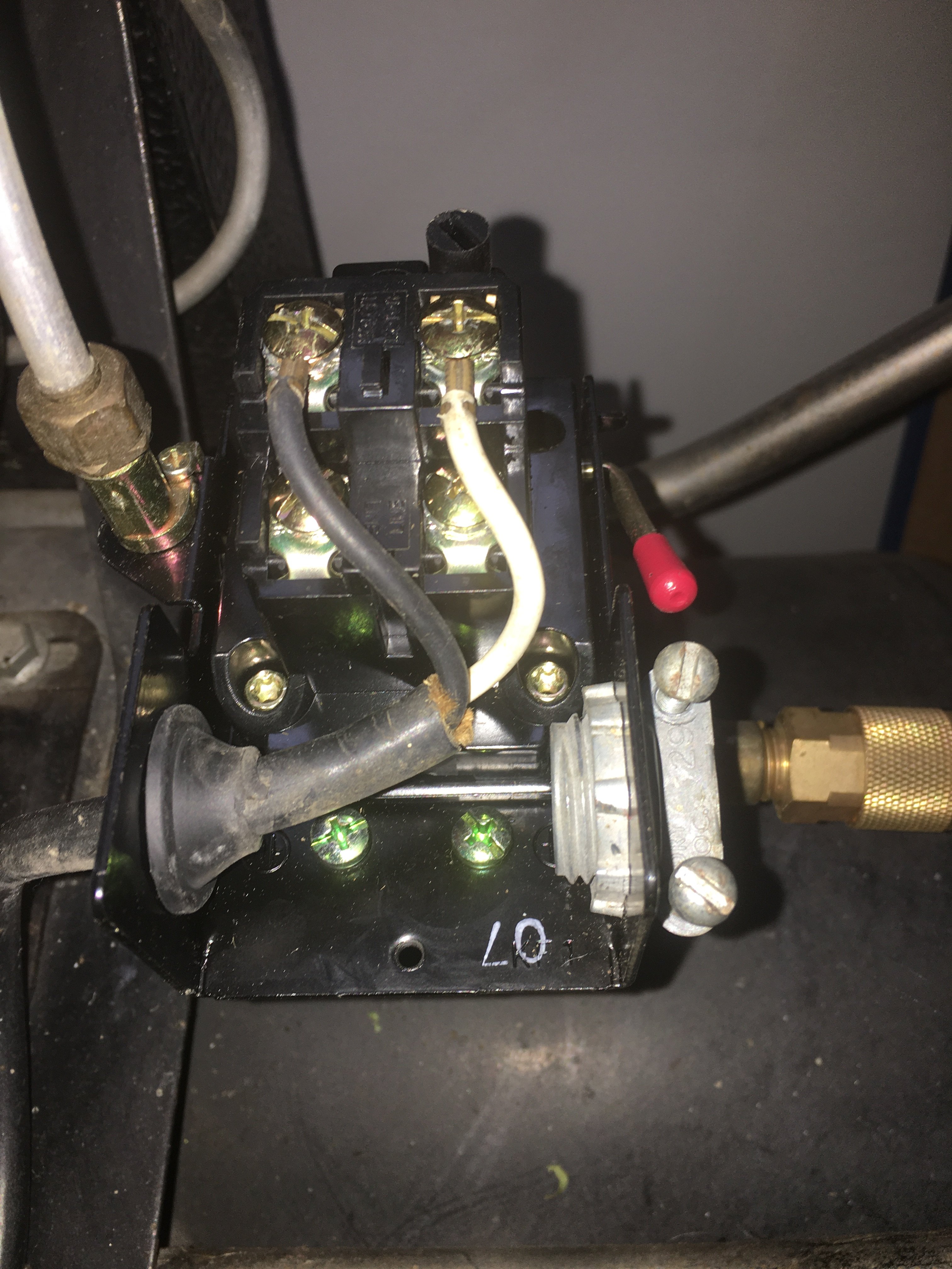

Here is my question: The compressor motor has two wires from the motor to the switch terminal. There are two screw terminals, each marked “line” and a ground terminal.
So, from the plug, the L-shaped prong is ground. Which two of the other three prongs should go to the “line” terminals on the motor?
I have a severe aversion to things blowing up in my face. Can you help?

What if there is no neutral terminal on the compressor motor? Do I just hook up two hots? The two top terminals are labeled “motor” and the two below are labeled “line.” The green is ground, obviously. But there is no neutral from the motor. Does ground suffice for the neutral?
Sure.

Okay.... Inspired by the general confusion, I looked it up. Turns out that for 220-240, one ignores the neutral line altogether. So, 10 gauge wire, make up to the generator plug on the two hots and simply let ground be ground. To the compressor, hardwire the two hots and ground, light ‘er off and see what happens.

i am no means a electrician
however we run 220 stone machines and I maintain and have replace the 220v internal switch
usually only the hot wires ( 120 plus 120= 240 ) are switched, common and grounds are always connected
on our stone machine we do not use the common, as it does not have/require one. Many older houses, before they change the electric code did not have a common wire. just 2 hots and a ground- 3 plug for dryers and stove.
Typically "ground" and neutral are electrically equivalent, however the green "ground" wire is meant to safely ground the major metal elements of a machine or appliance. The neutral wire facilitates splitting power from a 240 v apparatus to a 120 v part, like a motor, light, solenoid, or such.

230/240 motors are phased..
Line one is one phase and line 2 is the other..... Typically on most types of motors ground acts as a netural...
So any where that it says line in.. That is power.. So line in from the cord cap to line in to the motor...
Netural ( white) and green are both negative wires and act to complete the circuit....
Green is a physical ground and is used more commonly on motors...
