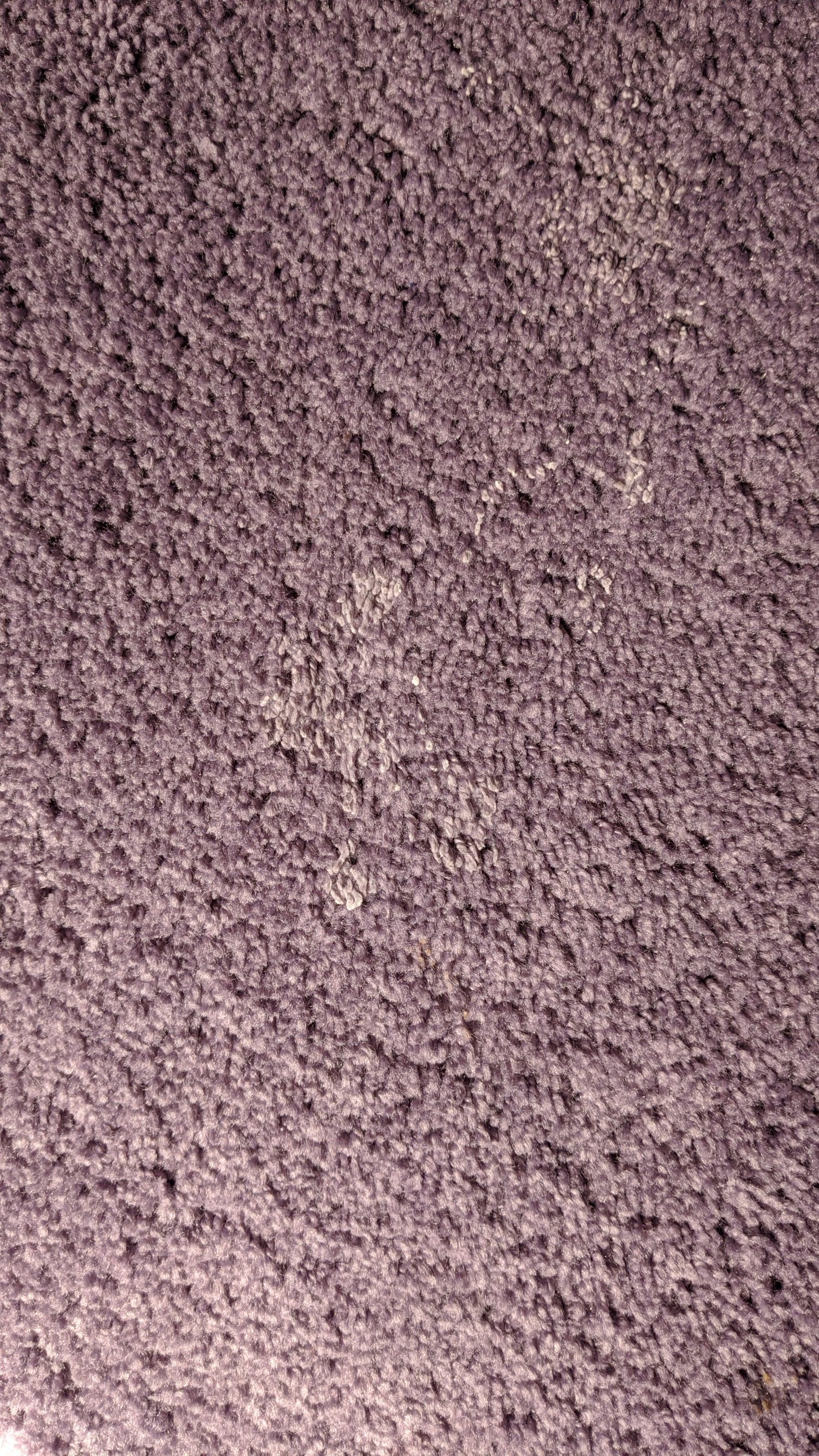

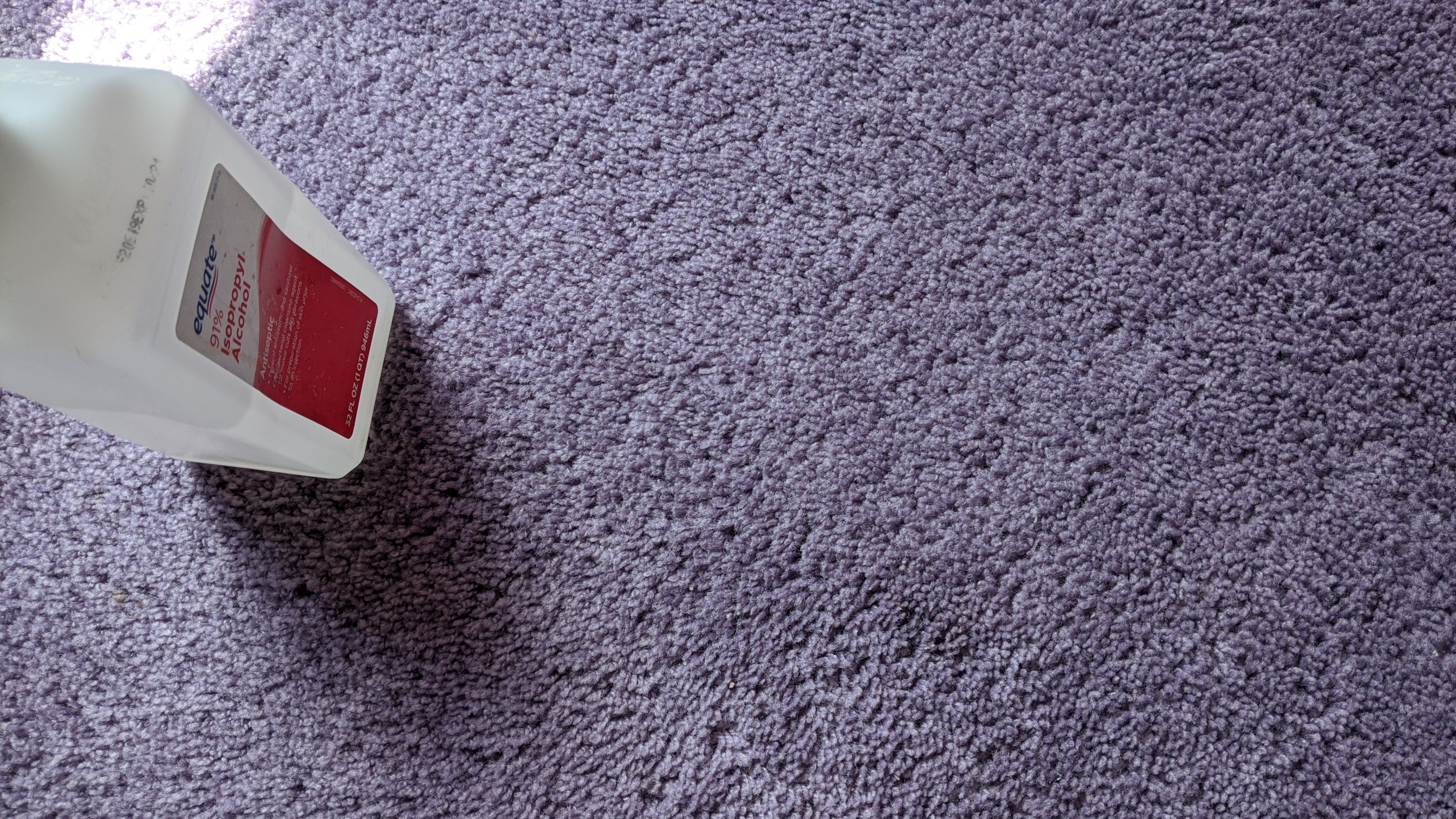

Otherwise known as homemade "Slime"..
Hi alkaline pre-spray and a CRB doesn't touch it
Gum Out products don't touch it
But rubbing alcohol in a hand towel takes it right out...
Put that in your spot bank

This was really good and practical advice Mike; but I admit that I thought it was some crazy food recipe that you came up with....

RVJR to the rescue! I've had several nasty slime jobs, and no need for any spot cleaners, just hit the areas with JR and presto abracadabra it's eliminated!
JR has that wow factor. The ability to 'hover' over at 190 and rinse continuously for minutes at a time sets the standard for spot removal of most substances.

Its doesn't always work, but it does work the best when it does.
I failed on some slime today,

I used 91% alcohol. The tufts started to come out as well- so I stopped.
