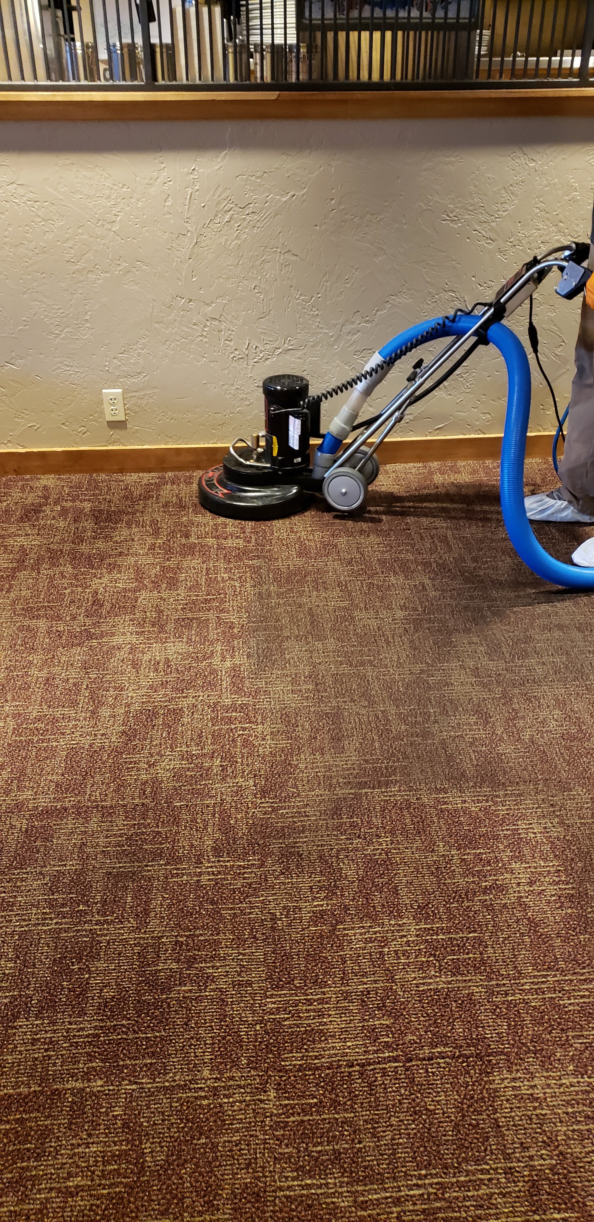

I'm doing a nice restaurant in town and it's been at least 5 years since they've professionally cleaned. Most of the time with CGD I've HWE'd, then Encapped after it's dry to touch up. I've read some threads where people have had good success encapping with a bonnet first, then HWE'ing. Has anyone tried this? I can see where it would help loosen dirt and grease and help with extraction, but will it help fight wicking?

We started the restaurant today. We presprayed with Prochem Ultrapac Extreme, scrubbed with a red pad and extracted with the 360xl. I will encap it tomorrow with a bonnet. We tested a spot with encap first, then HWE and it cleaned up nice, but it would have taken a ton of bonnets. I'll get the same result with post encap, using less bonnets and I won't be rinsing the encapsulation away. Thanks for everyone's input!20191027_121256.jpg
