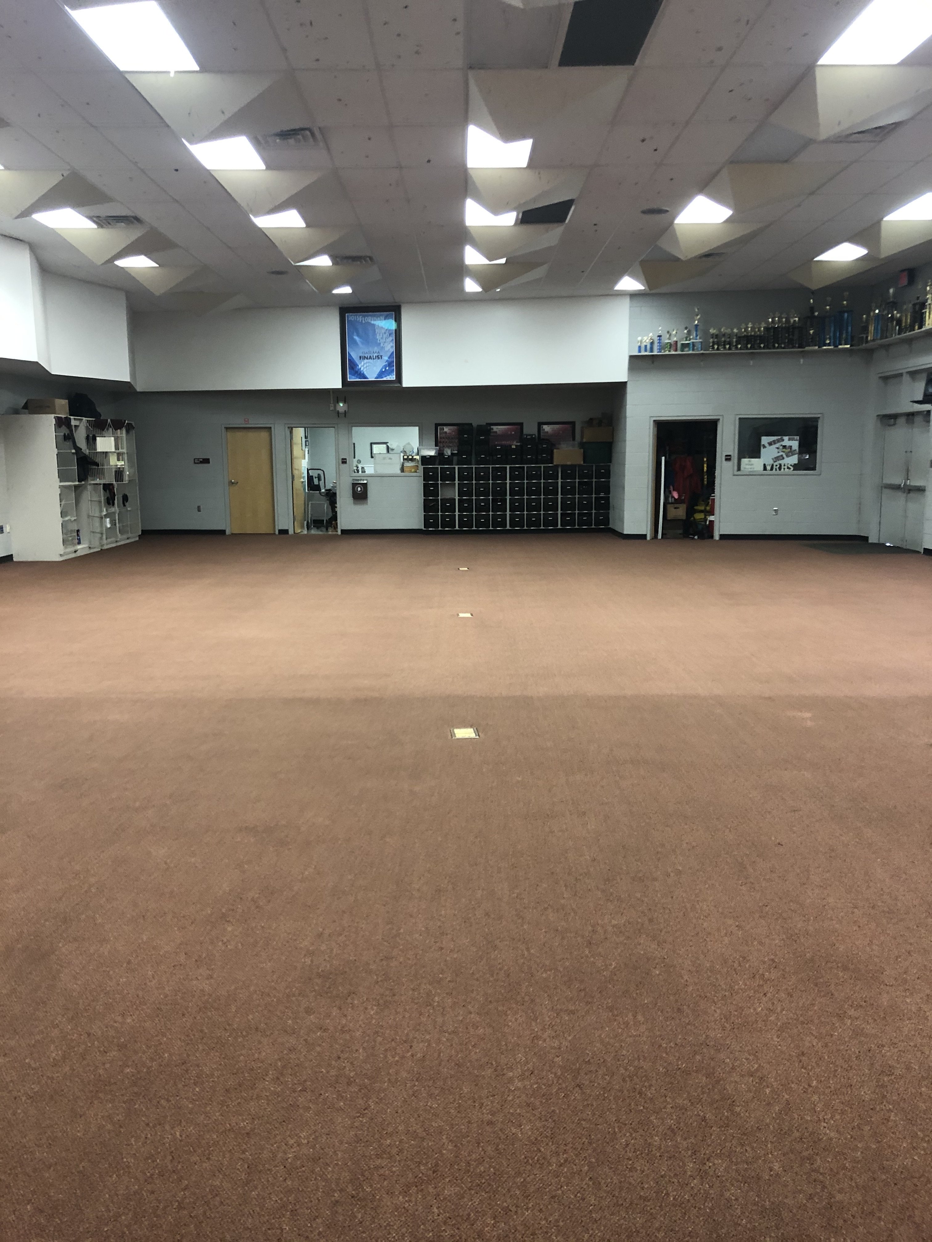

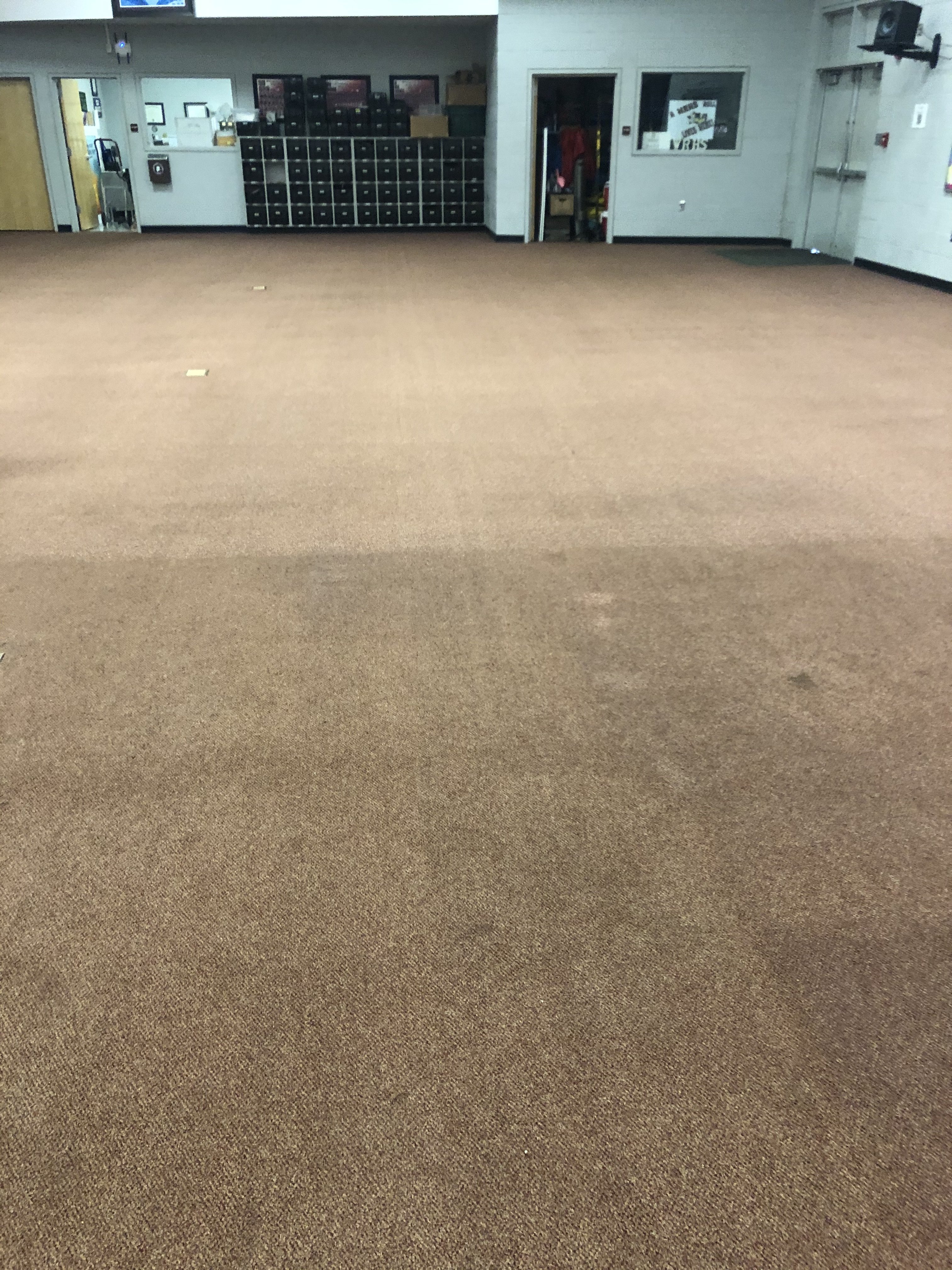

I had a crew do a job today. A school to be exact. And in one of the room the maintenance department previously used Host GVX and Host SJ on half the room. The crew used out strongest Butyl Commercial Pre-Spray, scrubbed with a CRB and extracted at 600 PSI with devastators and couldn't get the 2 half's close to matching. Our half didn't look nearly as clean and/or light as the half the maintenance department had done. We're going back later this week to encap. it to hopefully get it more uniform. I have a couple questions hopefully somebody can help answering.
  1. There's the old "where's the dirt go?" joke.... but in all seriousness, without a thorough extraction, there's no way in my mind that Encapsulation can get carpet as "CLEAN" as Encapsulation. That does not, however mean the end appearance is superior. That leads me to believe encaps. have superior chemistry that make the carpet "look cleaner". Is this true?
  2. Assuming the answer to question 1 is true, what EXACTLY do encaps. do to make the carpet appear cleaner? (ie optical brighteners, oxidizers, reducing agents, etc...)

Might be that the water goes deeper w/hwe than the vlm does. As the water dries the soil lower down in the carpet is pulled up through the wicking process. The vlm doesn't go as deep, where more of the soil lies, so less soil is wicked up (less moisture also means less wicking too).
