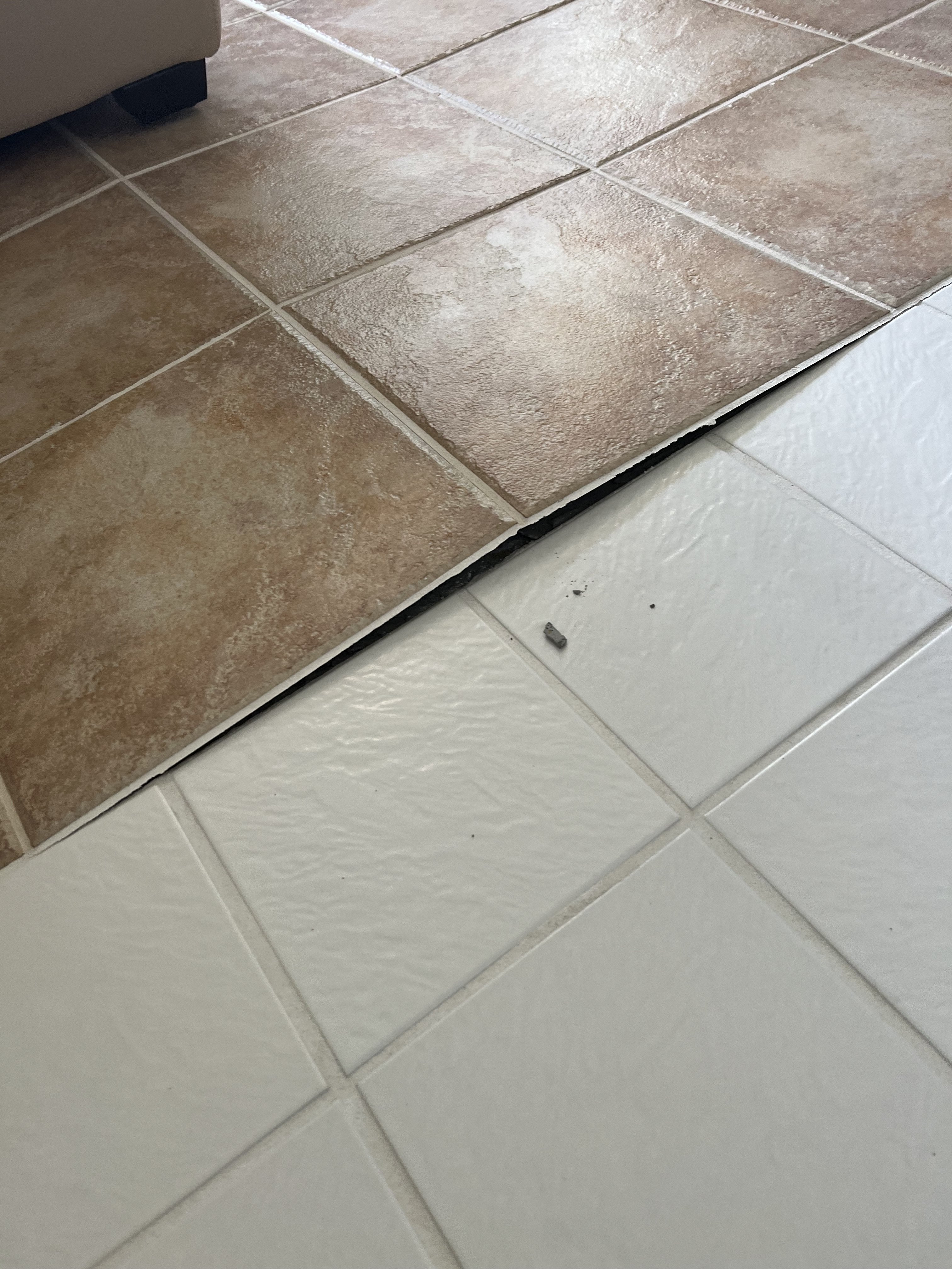

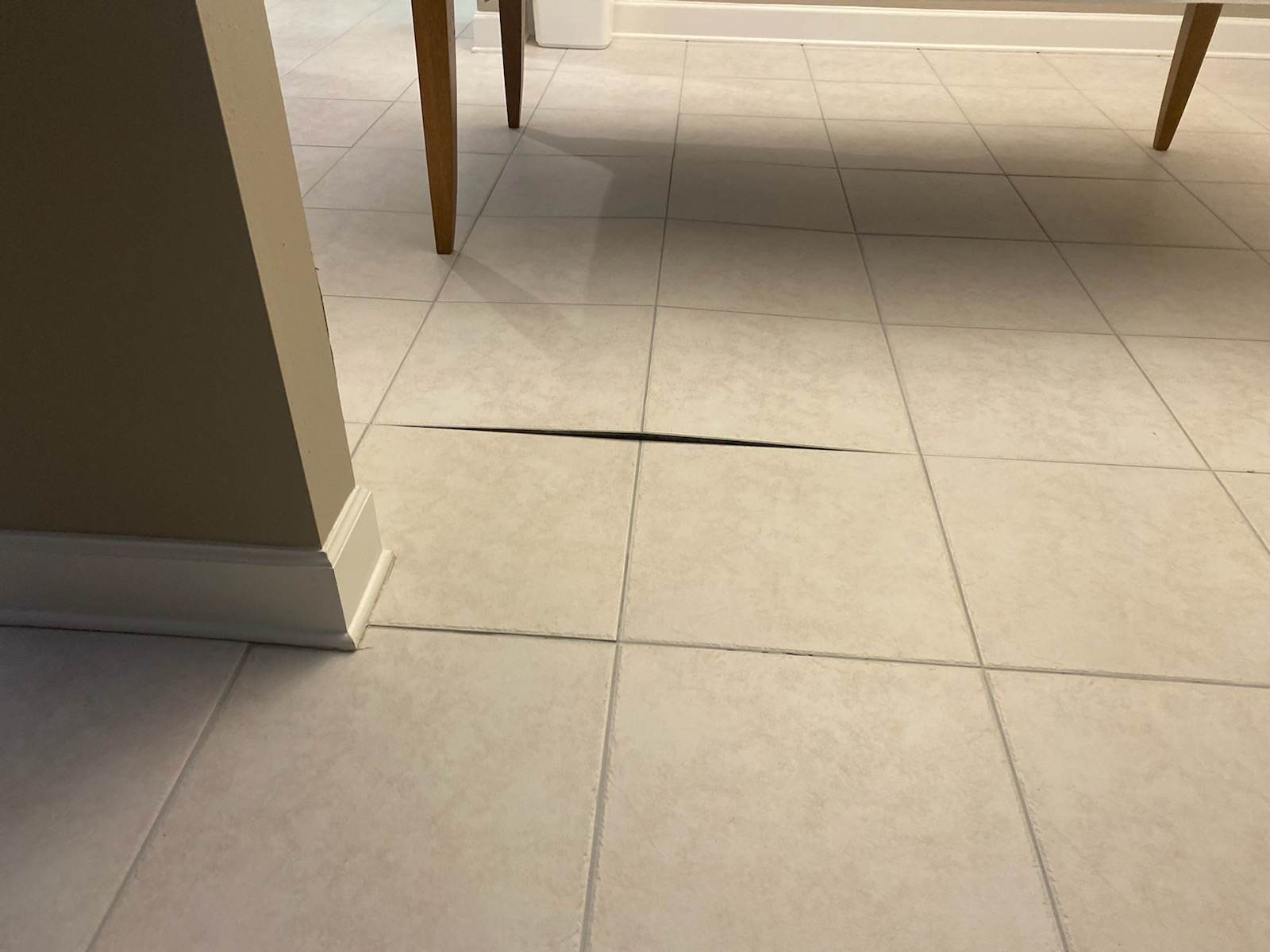

Fascinating photo of a tile floor gone bad after cleaning..
116,048
Tiles popped loose an hour ofter getting "spinner'd"
Florida.
Concrete subfloor..

Always an installation failure. Nothing to do with the cleaner
Yeah I mentioned probably not enough thin set, but I hear hallow points in tile all the time and it's doesn't pop up, I just see breaks before I touch it.
But I'm proper install of thin set ant tile is a real deal.

One of my many fears with tile cleaning.. Golf ball test or even the seam tractor going over it to hear if it's hallow.. A lot of WDR guys have had problems with "tenting/popped" tiles after drying out..
I'm sure your BHGG are the answer to this problem.. Lower pressure and heat used to clean it..
116,048
Tenting is due to incorrect installation but as in the case of this particular photo it was aggravated and definitely the straw that broke the camel's back but had the concrete subfloor not been wet. Most likely there would have been no tenting
