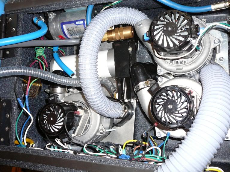

Friday, we finished testing some "brand new" more efficient vac motors on our Breeze portable.
It has three 3-stage vac motors AND a 500 PSI pump running on just two electric cords.
We think it provides higher vacuum than any two-cord portable on the market.
Air Watts are over 1500 total. CFM is around 240. Maximum lift is 15" hg.
Water flow is 1.4 GPM.
The first model will also have a pump-out system on those two cords.
We are still deciding on the best wand for standard equipment (14" vs. 12").

Larry, please explain to all of us how you have the vacs configured? Air-parallel for higher CFM or Air-Series for your 15"hg claim? Or some hybrid configuration?
Also if Air-parallel are you using a single Stack in the waste tank, or multiple stacks?
Thank you.

How about that pump, Larry? I would imagine to be able to get three 3 stage units and an auto pump out on 2 cords, it would be powered by a DC motor, is it? Whether it's AC or DC, it sounds like it should be a respectable porty.

Larry, what is the amp draw of those motors load and no load, if you have an amp meter lying around.
