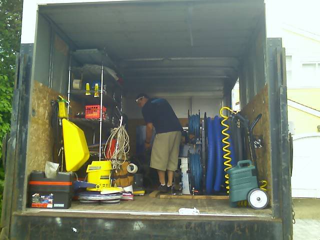

The V had to go in for new shock and a lube and tune so my new to me SW Legacy 2100 with only 58 hours got it's first work out.
Some notes:
Single wanding sucks. We got off @ seven and lost a small job when we would have completed them all and been done by 5pm w/ the V.
Non electric reels are for you guys who do two jobs a day.
The 3/8ths hose was easy to wand with and delivered tremendous heat to my 012 wand but rolling it up on a reel is for guys who do 2 jobs a day.
Vac and pressure reels in the back of the truck, four feet in should be against the law.
I think I'll ditch the pressure hose reels.
2.5 straight to the top of the tank ala' a GG elbow, creates plenty of suck for single wanding. Best I've ever experienced with a 45 blower.
My V does not get this hot even in single mode.
Vapor lock is fun.
I am wondering if I'll ever get use to that nasty heat and stench that blows all over me all day long.
I am wondering if my customers will ever get use to that nasty heat and stench that blows all over them all day long.
A truck mount with out a fresh tank is like a wife with out..
Why did SW not put a ball valve for the fresh Water QC?
Where is the hot water convenience hose?
I feel ashamed in a ratty unmarked truck.
Even this pos 1989 Ford with over 400,000 miles on it drives better than the UD.
But it has horrible blind spots and backing up is a game of Russian Roulette.
Check valved TI wands makes some crazy ass noises when blasting that kind of heat.
It's temperature gage is not accurate.
Inch and a half whips are for scrawny 98 pound Minnesotans.
None the less, it sure was nice to make $1500 while my V was out of commission

you realize you can unbolt those and slide them out???? :roll:

There not capri's, there called MANPRI's. I hear they are Very poplar in Europe, along with crocs. :| Nice Box truck except ya need to push those hose reels back 4 ft towards the back of the truck. Oh ya know that, NEVER MIND. :oops:
it just needs set up right, Ron.
Mike bought it from hOtEL mANager, not an efficient set up CCer.
Yo-Yo, vEEgs..you fit right in the projects with those pants.
they look a LOT like what the hood-rats wear :shock:
do you wear a baseball cap side ways too???
BTW, that burner shouldn't "stink" or smoke if the air ring is adjusted right
("IF" you're burning kero (K-1) and not diesel or fuel oil)
and I can't imagine gas engine exhaust smelling any worse than the exhaust from that rattle/chatter UD diesel motor....
15,253
Forget the MANPRI pants and focus on the snappy upscale T-Shirt!
117,248
Thats my helper ya idiots.
Those are Dickies work shorts.
He is just a short little fella so they look long.

can't afford to get him some real shorts :p Real men wear shorts that do not go below the knee!
Patrick
Dang...if you consider him short,I'd hate to see what you consider me at 5 foot 4.

Those shorts would be to my ankles. True about the kero and exhaust smells. It clings to you from the first start up in the morning. That's one reason I got away from SW and kero heaters. But it will kick some serious arse with the heat cranked to max. Where you dumpin', mike? I'm sure that unit don't have an APO>
