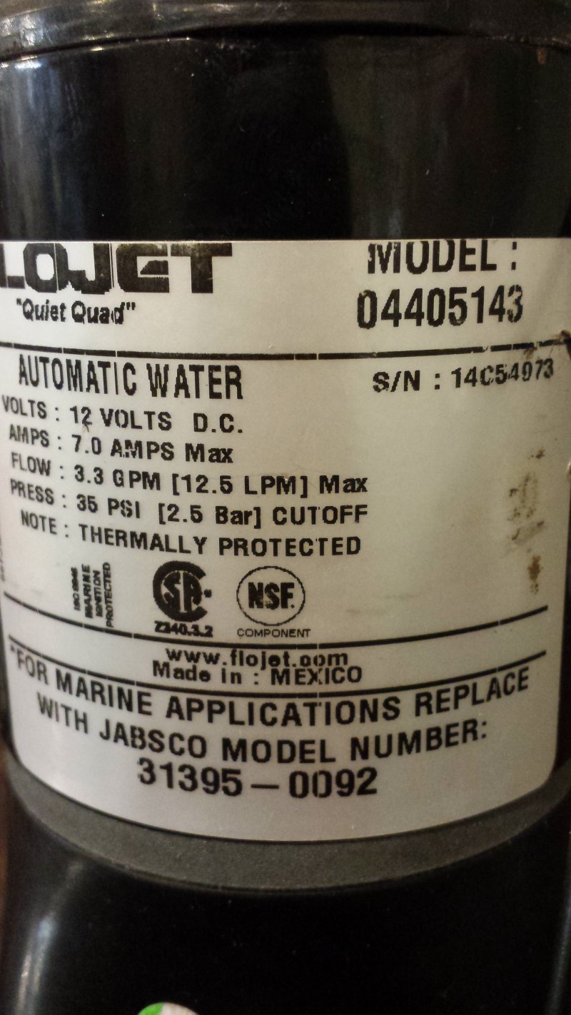

I have been having problems with my pump over heating it says:
So I took out my accumulator tank and it still over heats.. Is it just the wrong pump for the prochem water box or what is going on here? It's OK for a while but it I have bigger jobs it shuts off due to high temps..

I first replace the switch(normally it goes) then the pump, to no avail. .

I switched pumps with my other TM and that one is fine.. Not sure why these run too much..
