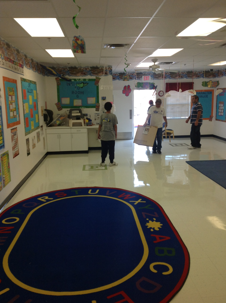

17 years between cleanings. Neutral cleaner in water and rotary scrub with a maroon prep pad. Edges cleaned with maroon doodle pad. Buffed to close it up then 3 coats of Pioneer Equinox floor finish. Buff with thermal pad on a propane when dry

and scrub and recoat is always my preferable way if he original job was done right and like micheal I prefer blue pads for that but you did a great job with your process!
