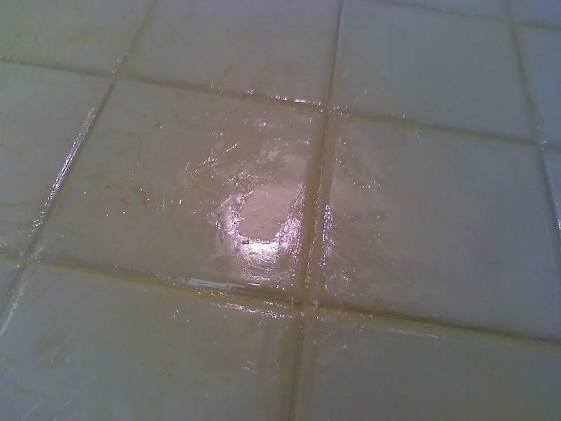

Once in a while you'll have to remove a botched job from some other yo-yo or DIYS..
This stuff gets it off in about 15 minutes with no odor and very little skin irritation.
Apply, dwell for 10 minutes, scrub in with grout brush and then rinse with your TM.

Mop n Glow will come off with Floor Finish stripper usually.
If not, this will work but it's $70 a gallon RTU

Think this would work on 8 coats of wax on restaurant tile and grout?
G
Gary T
Stuff works well. It will remove crap that other strippers won't touch. Johnson's Fastrip/Butcher's Wild Rapids for Mop&Glo crap. Works like it wasn't even there.
