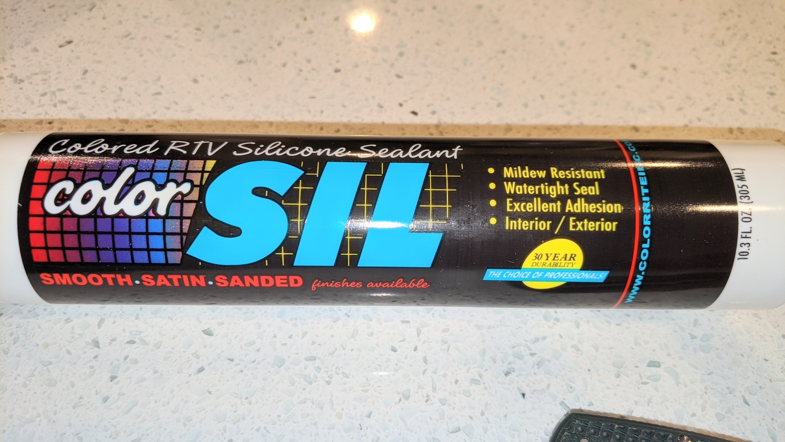

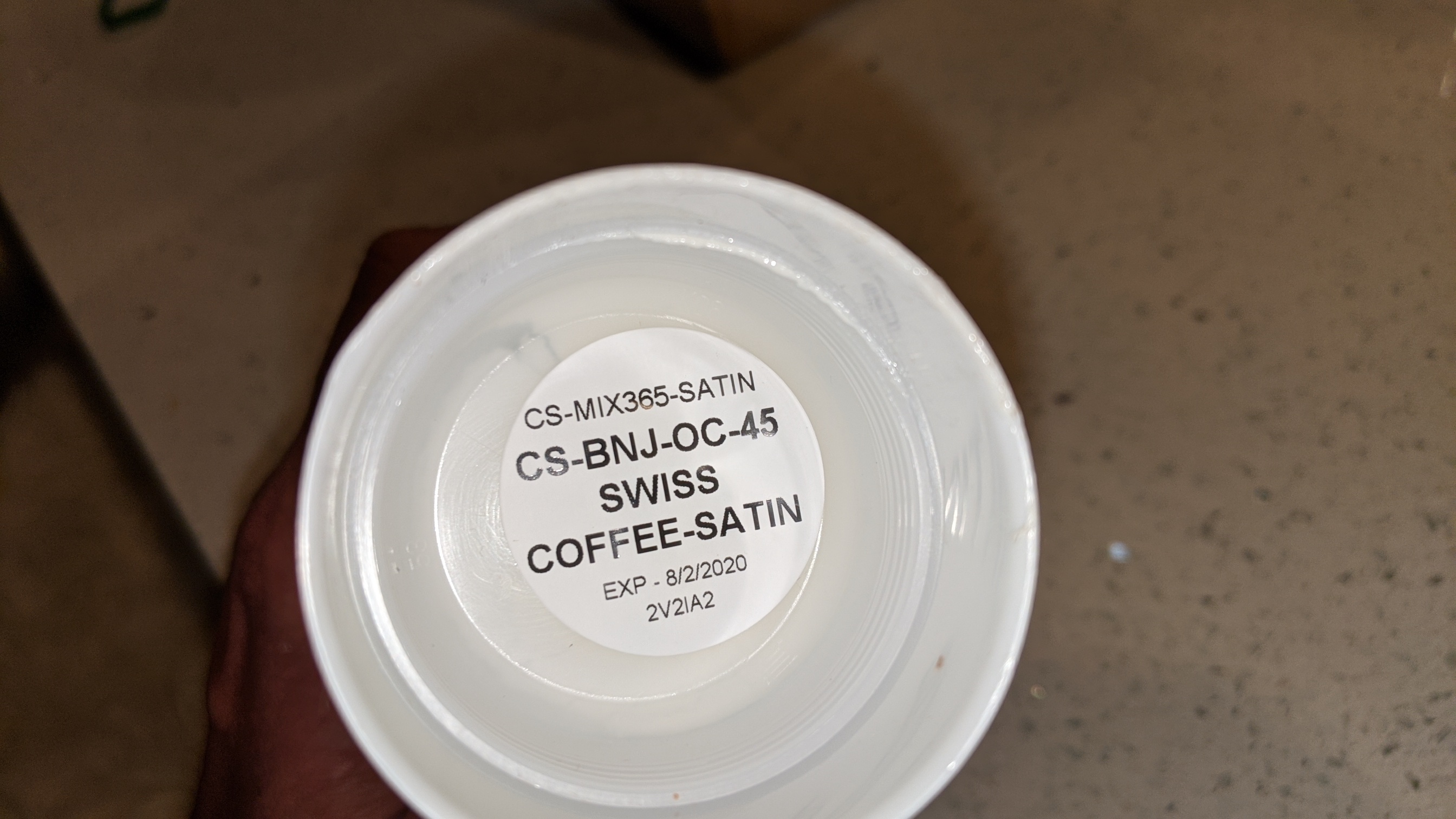

I think it was Bill on here who 1st turned me on to this stuff.
By far the highest quality, easiest to apply silicone "caulking" available.
RTV and available in three textures/ finishes and most importantly, available in every grout color and Benjamin Moore and Sherwin Williams paint hues.
It's pricey but pass the cost along ($30ish a tube)
I watched two painters caulk, mask and paint the gap under some baseboards yesterday. Hours of work for a shitty end result. This product is a no brainier

Do you buy this at Benjamin Moore and Sherwin Williams stores?
117,180
Only available here
saved in labor
