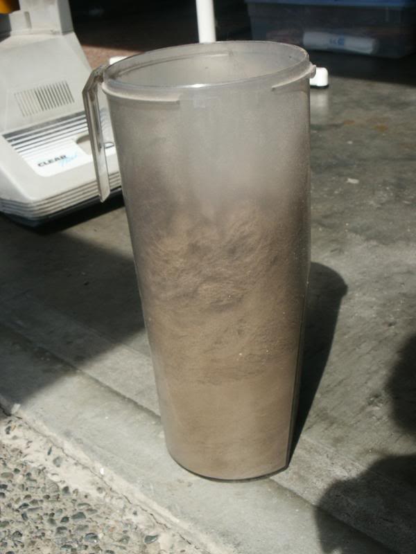

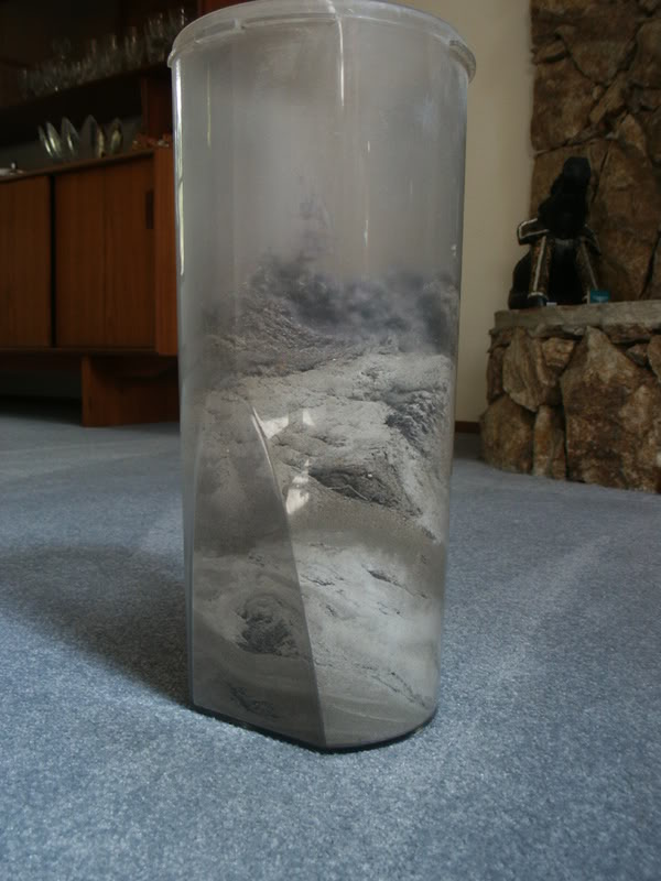

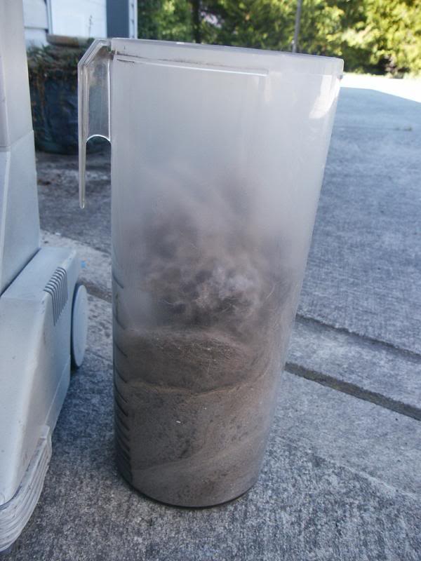

Ron,that person or persons you get that crap out of are the ones that Do Not vacuum enough period.You can give a guy the best equipment there is and still do a crap job.So put blame where it belongs,to lazy people not vacuuming.Oh and teach you're clients the importance of frequentcy or you are doing them a disservice.

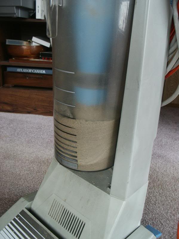

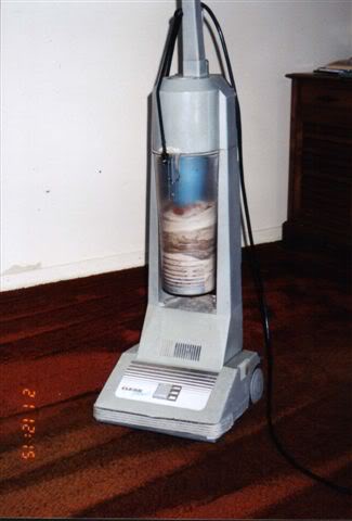

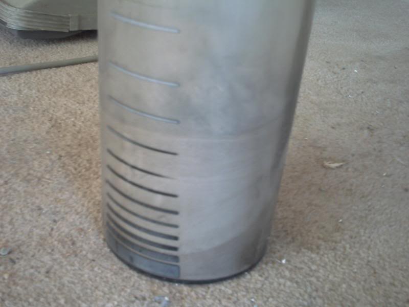

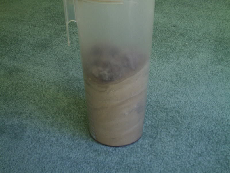

Most of those pics are from well kept homes, not trashed places, where the client has vacuumed before I arrived.
Keep bringing the excuses, haven't heard anything new yet.
If you don't want to prevac, just acknowledge that you are not removing all the soil that you could. When you've finished and the job looks great, you're only guessing that you've removed the soil.

Dry vacuuming removes the soil OUT OF the carpet, accounting for, hopefully as much as 80% of the soil. We'll never achieve that, but its the goal.
Now that the dry particulate is removed, Steam Cleaning will remove the soil that is ON the carpet fibres, the remaining 20%
