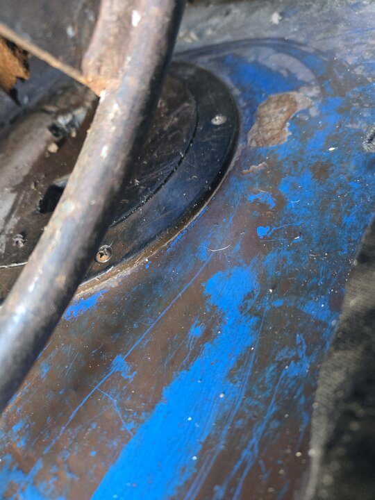

It leaks out of these twist lids, there are two of them. When the tank is full enough it sloshes the water around enough while I am driving to come up through these lids and get all over the floor of the van. I've tightened them as much as I can. Have any of you experienced this? Have you sealed them with silicone or something that can still be removed later if there are service needs?

All is fine, except the twist lids leak out of the threads when I am driving via sloshing and it leaks water onto the floor of my van. I think Nate's recommendation of black RTV silicone will work well. Unless I am missing something. With the overflow hose plumbed through the van floor I don't think the tank will burst if I seal around the threads of the twist lids, and then overfill it at some point.

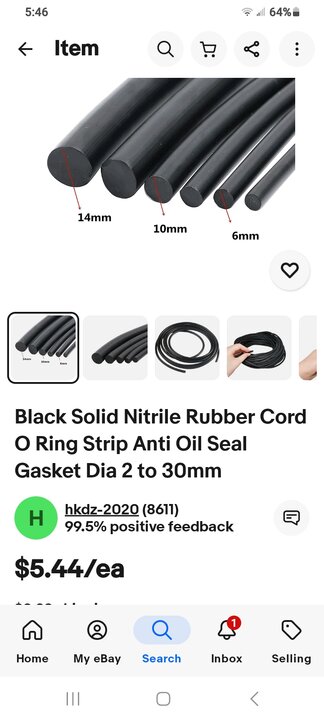

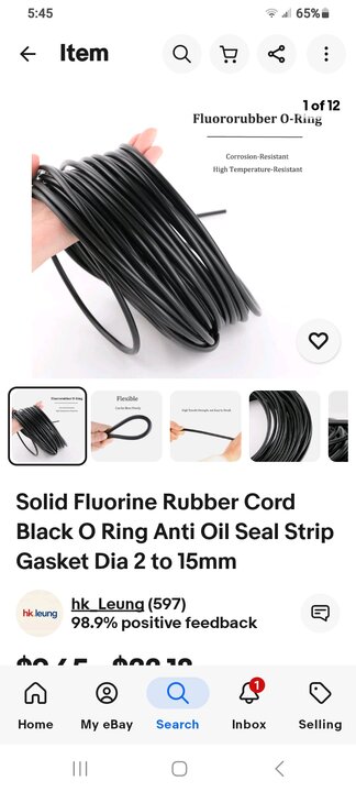

The problem with silicone is youll be gluing them shut and if not impossible it'll be nearly that to open them again. Can you put an oring around the top? If so you can buy oring material and make one to fit. You.order the diameter of material and length then cut to size, glue the 2 ends together and presto you gotta custom oring gasket ( if that'll work in.this situation)
