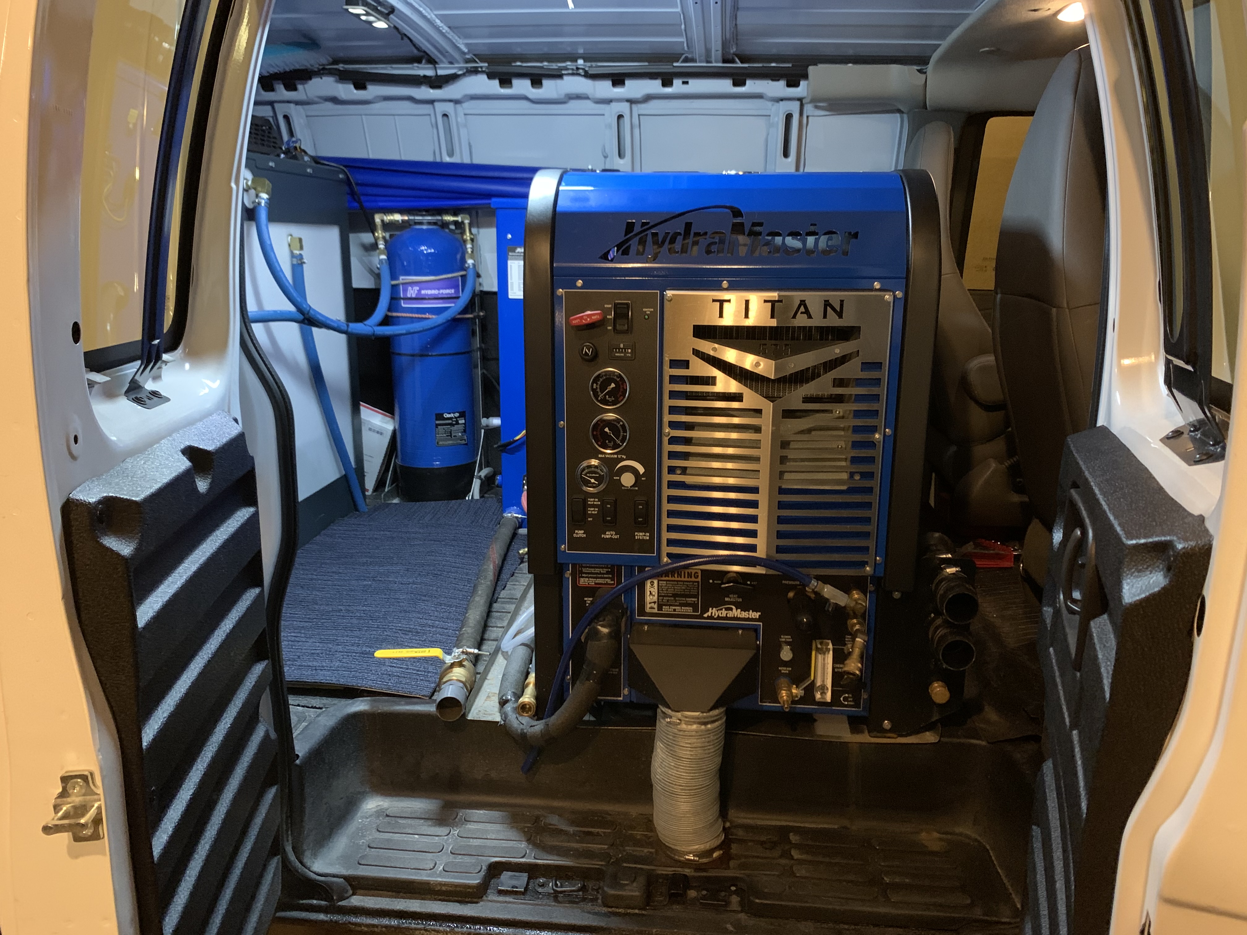

this is the one I use. Just mount it in the van near the waste tank. run the water through the softener before it goes to the machine, either from the homeowners water source or an onboard water tank.
I just put in salt every month, but yours will be different depending on how hard your water is and how much water you use.
No drawbacks that I can think of.
Cost is for salt. Cheap
