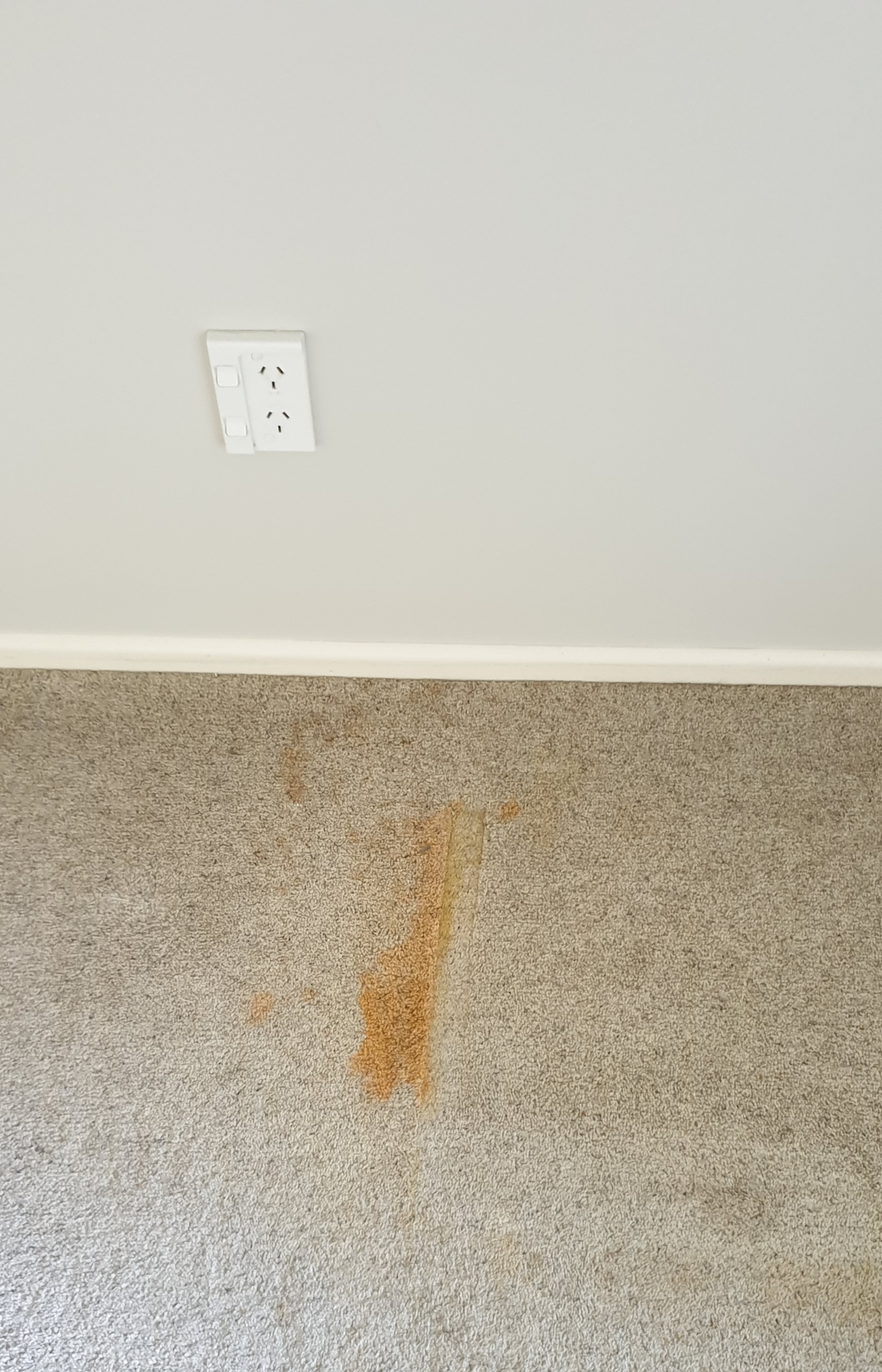

Geothermal fluid on wool Berber
6,564
Is it R410 or propylene glycol?
Propylene glycol.
He also made mention that it is at a very diluted concentration, approximately 2-4%. Apparently it is supposed to be at about 30%.
There is also a slight orange tinge to it.
And there is sort of an oily substance present.
All they did was put a fan on it.
