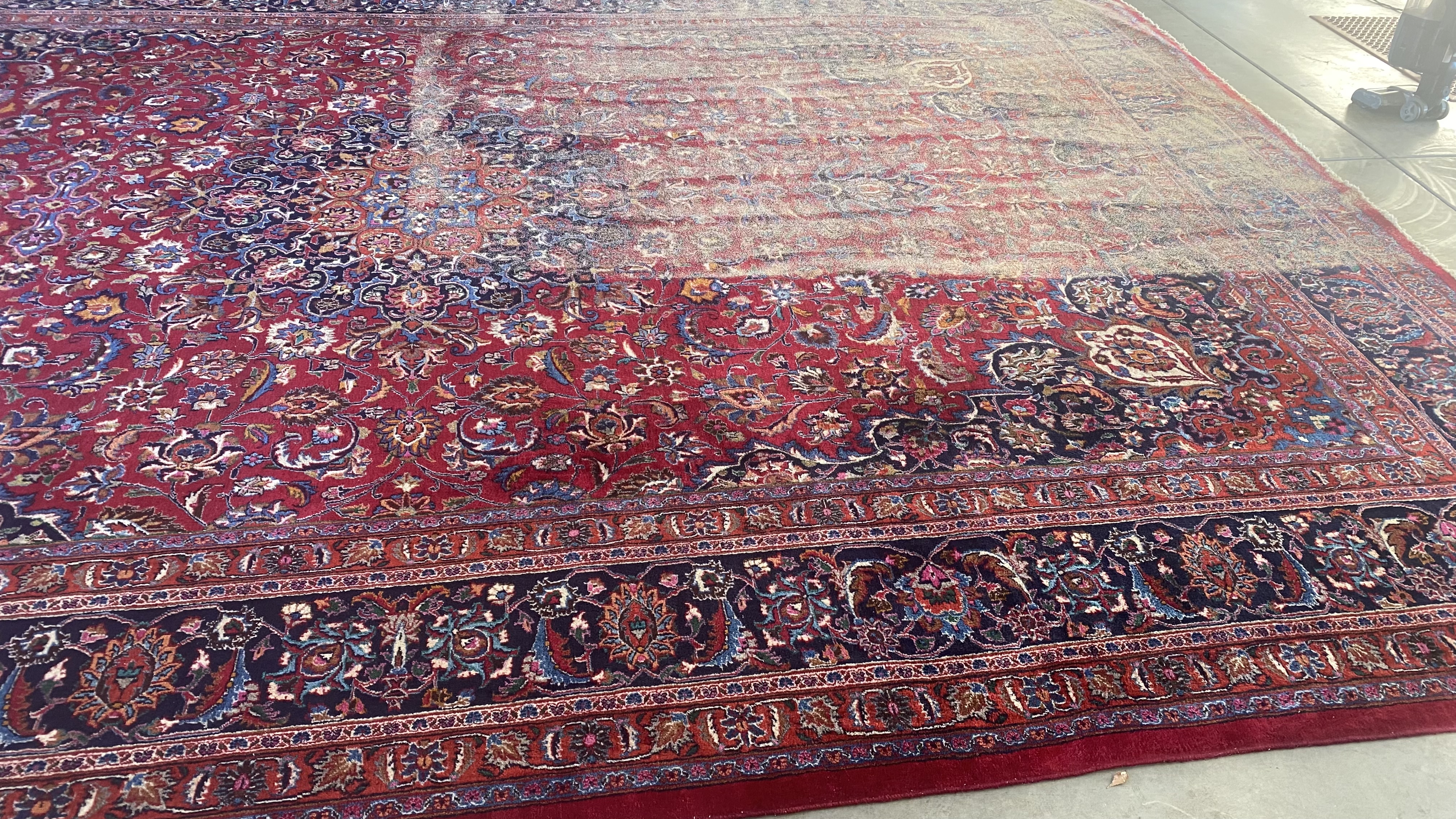

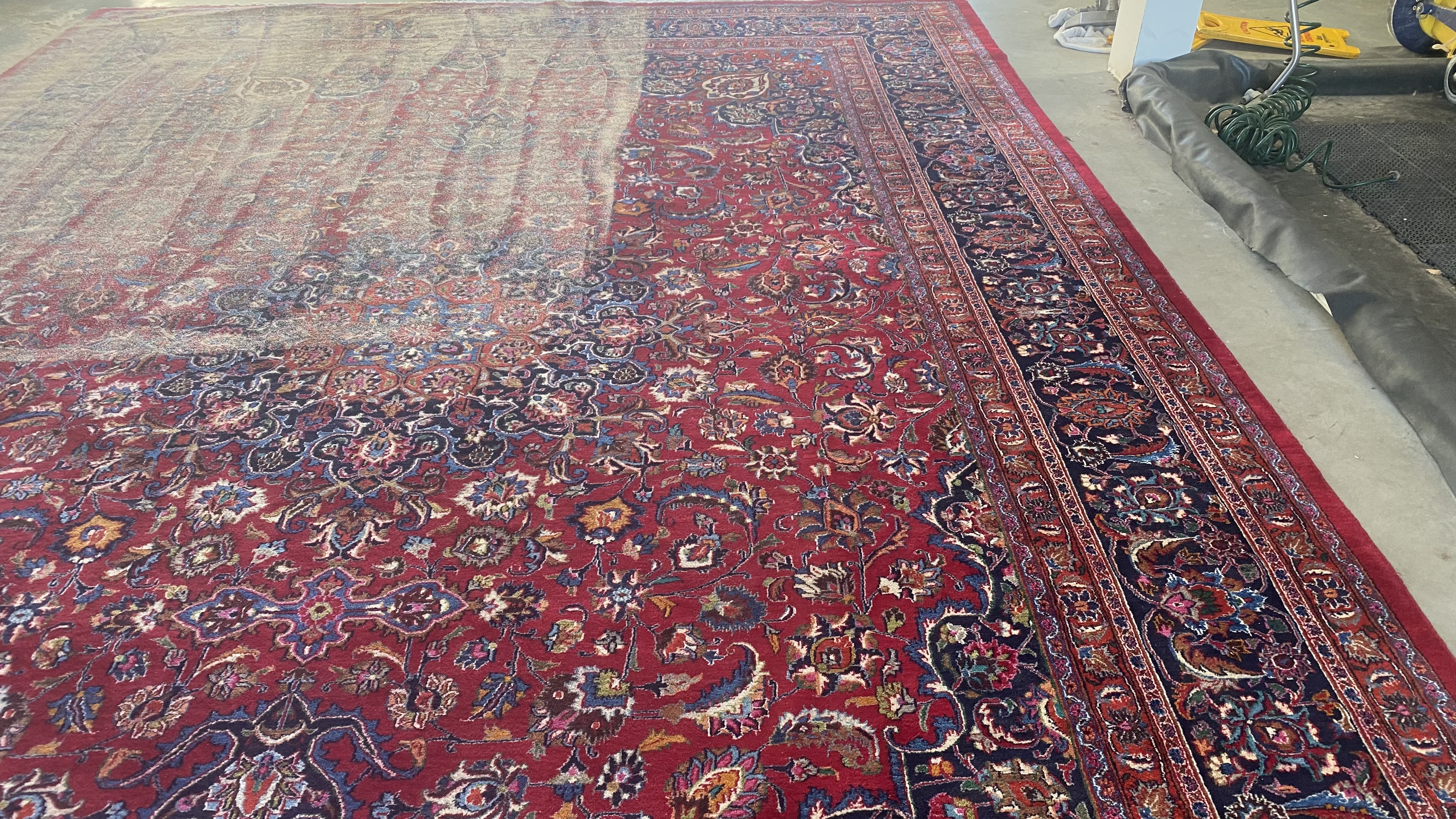

Working on this very large area rug and decided to try out the dry compound again. Going to take a little more time this time and let it rub in and just deal with the mess. So far it seems to be doing a good job. I’ll try to take a picture of have to run clean with compound and half the rug and touched. 4A6D0255-3111-4A55-978E-FB7CEAC6DDD9.jpeg
24,055
Redding
I just scrubbed and vacuumed 1/4 of the rug. I dont know if it’s noticeable in the picture but there is a difference. The blues and reds seem to pop a bit more than the un treated half.

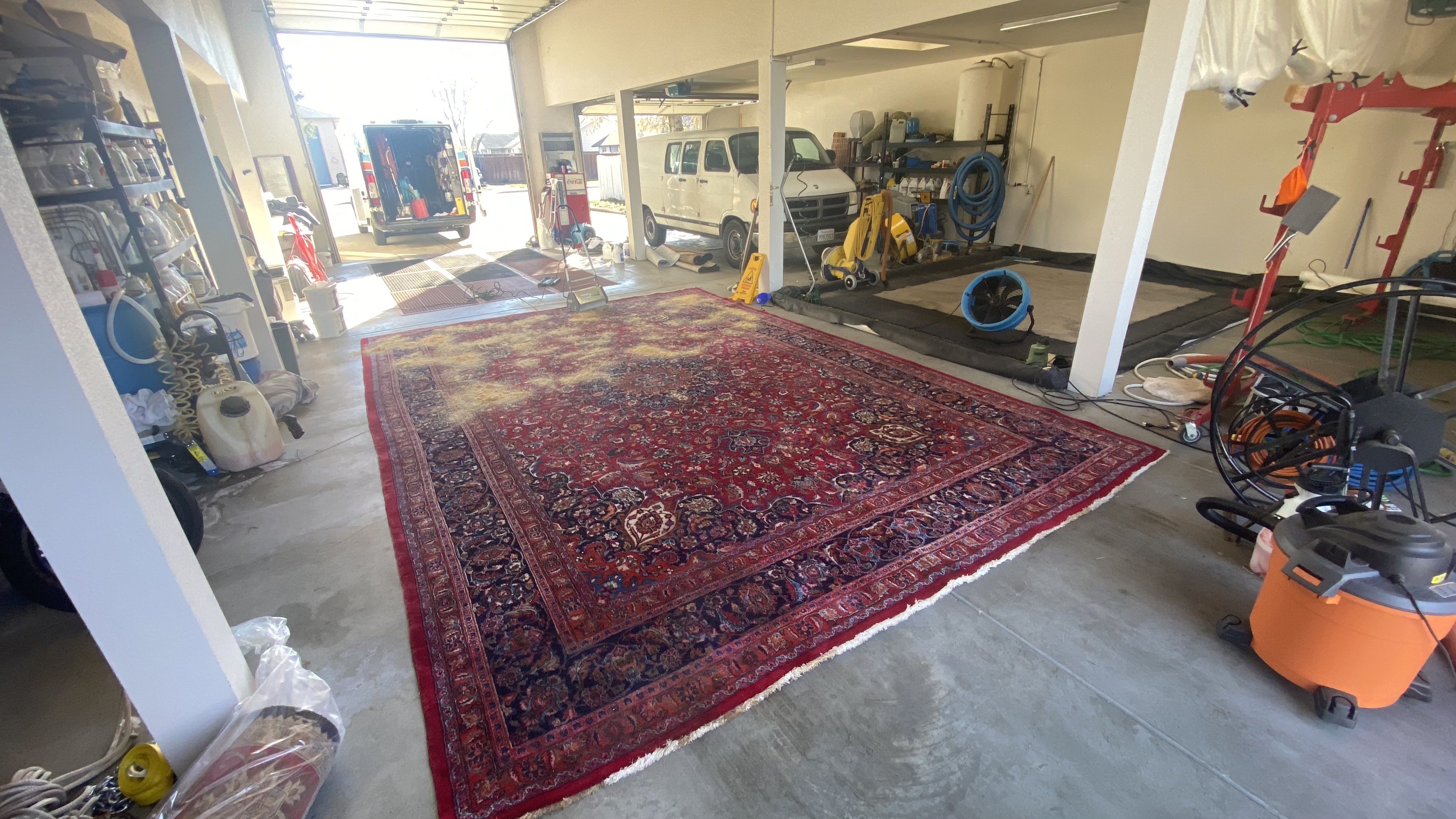

@Papa John that came out worse than I meant it to sound. That rug is 19‘ x 16‘. I can hardly move it dry. I certainly can’t move it once it’s wet. My rug pit just isn’t big enough for it. I’m going through the entire rug individually flushing all the urine out using the Centrum Force flushing tool. It’s also a massive massive bleeder. All the fringe will be worked on individually with a fringe cleaner.
Bleeders don’t scare me, I just acid rinse them them until they decide to stop bleeding. But this rug is so large it would take hours of rinsing and flushing with a squeegee. I could never forgive myself for putting all those dyes back into the ground water. They should give me a medal for my environmentalist ways.
