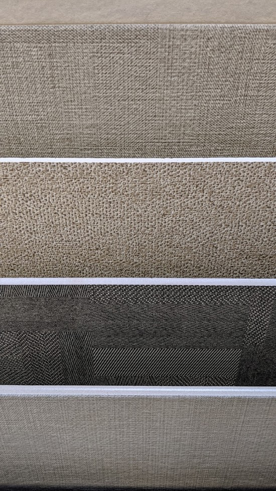

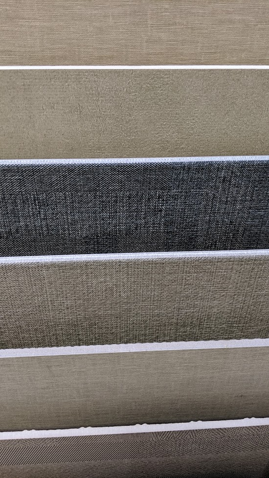

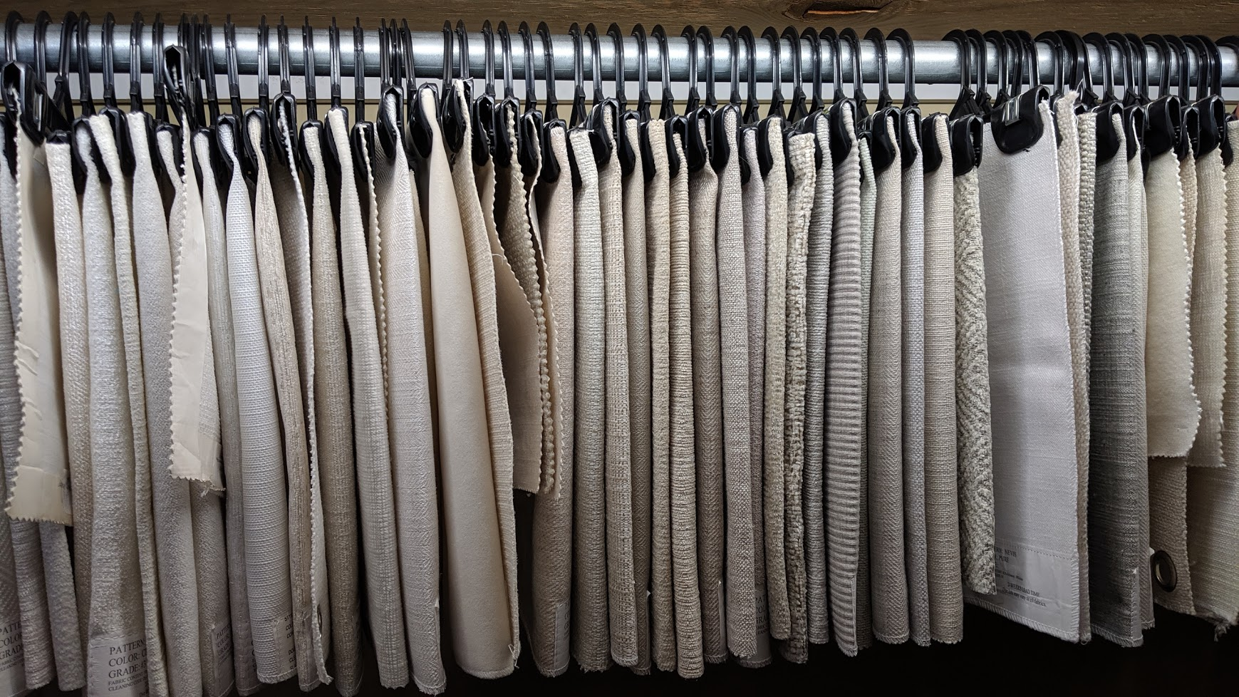

seriously though, when I visited three furniture retailers (a Lazy Boy Gallery, a middle of the road and a higher end and an all natural organic) last week, 95% of all offerings were 95% or more pure Polyester.
All those scary brownoutable, shrinkable designer fabrics from the past are now Ultrapakable....
These are all 100% Poly....
