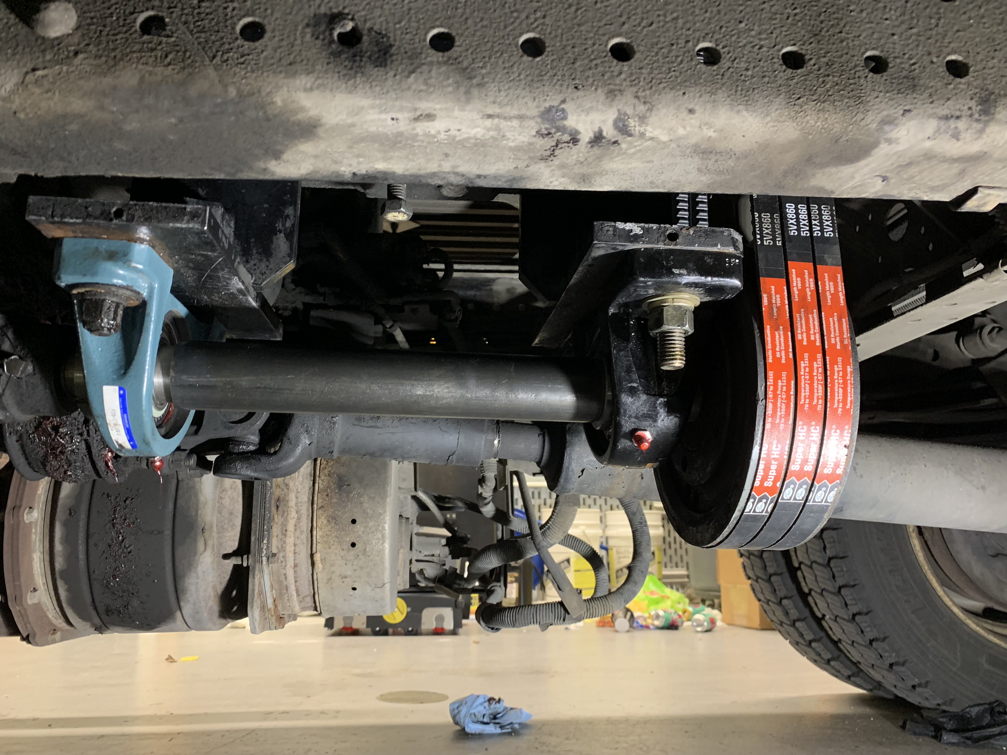

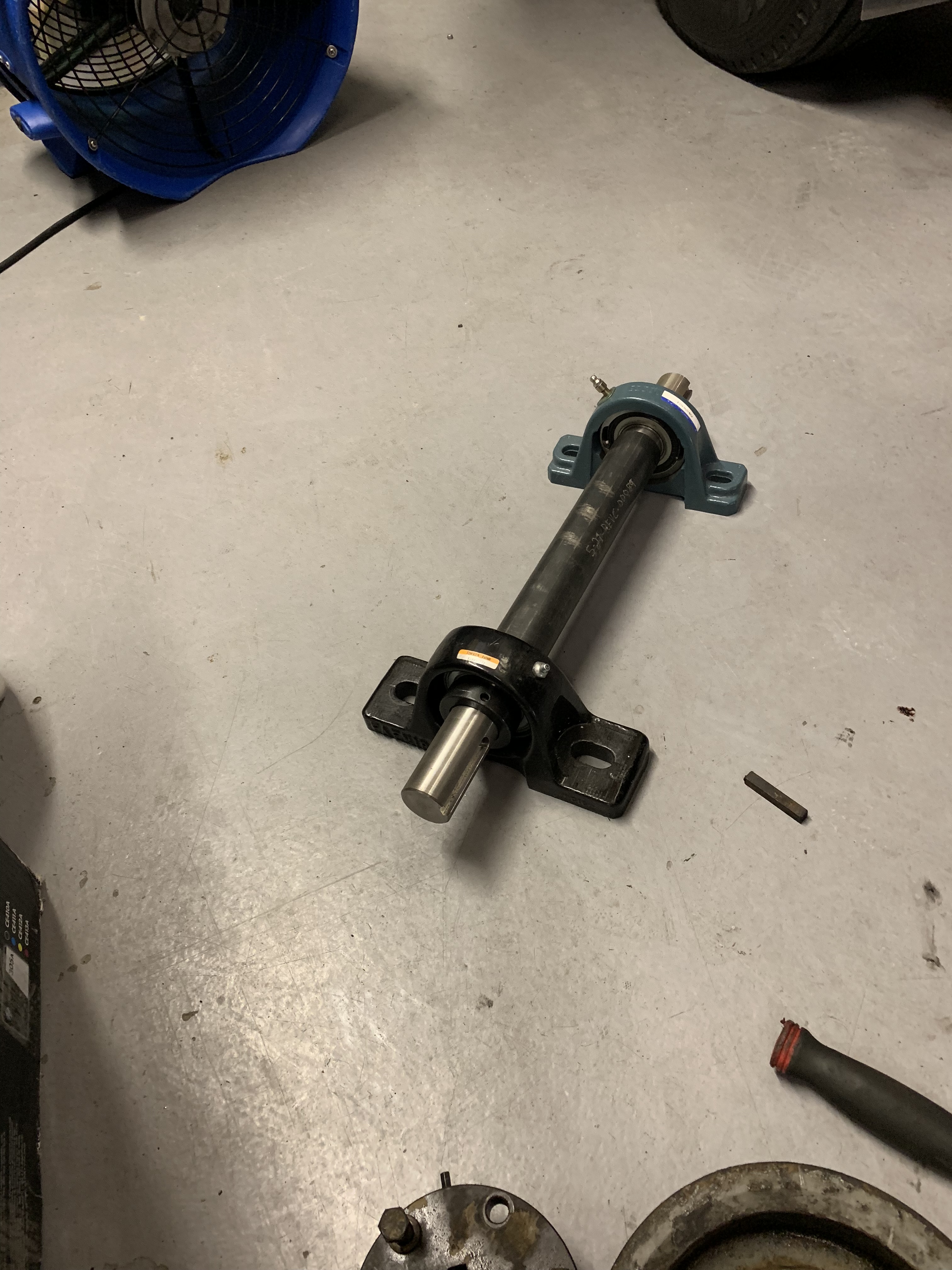

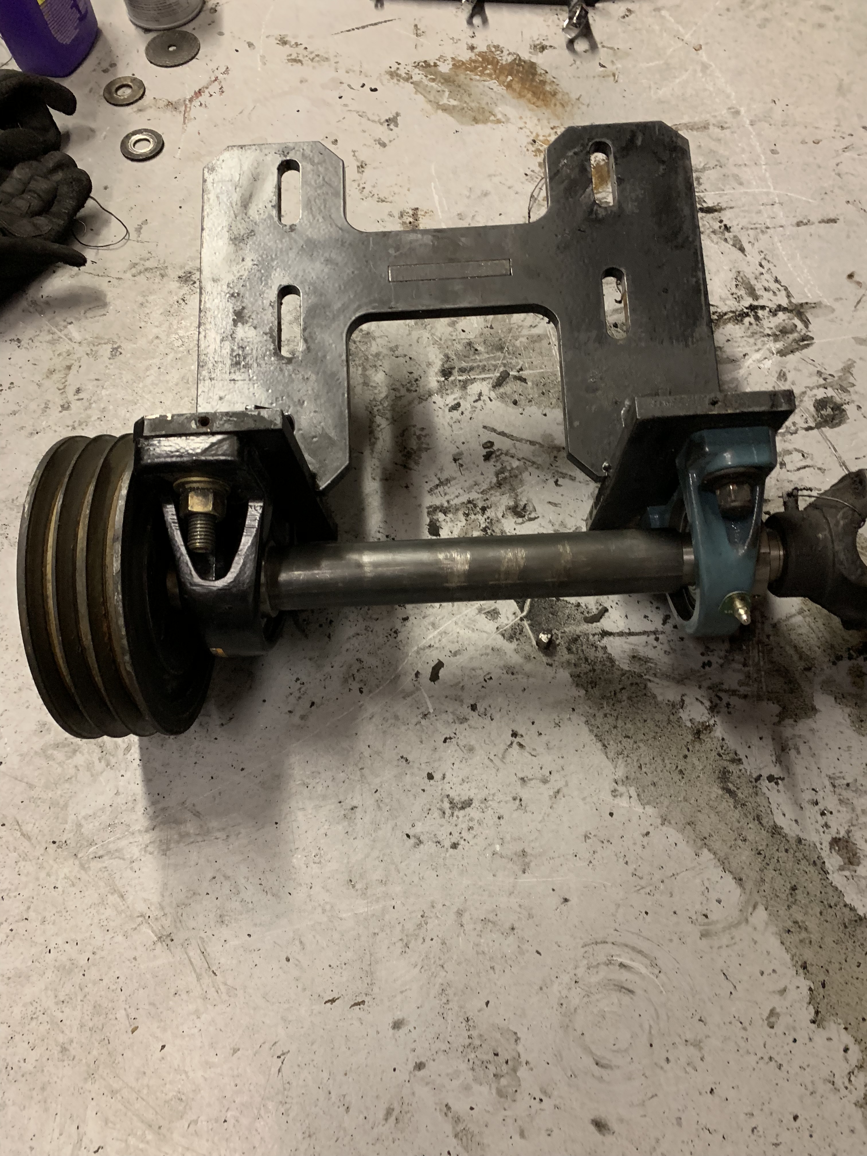

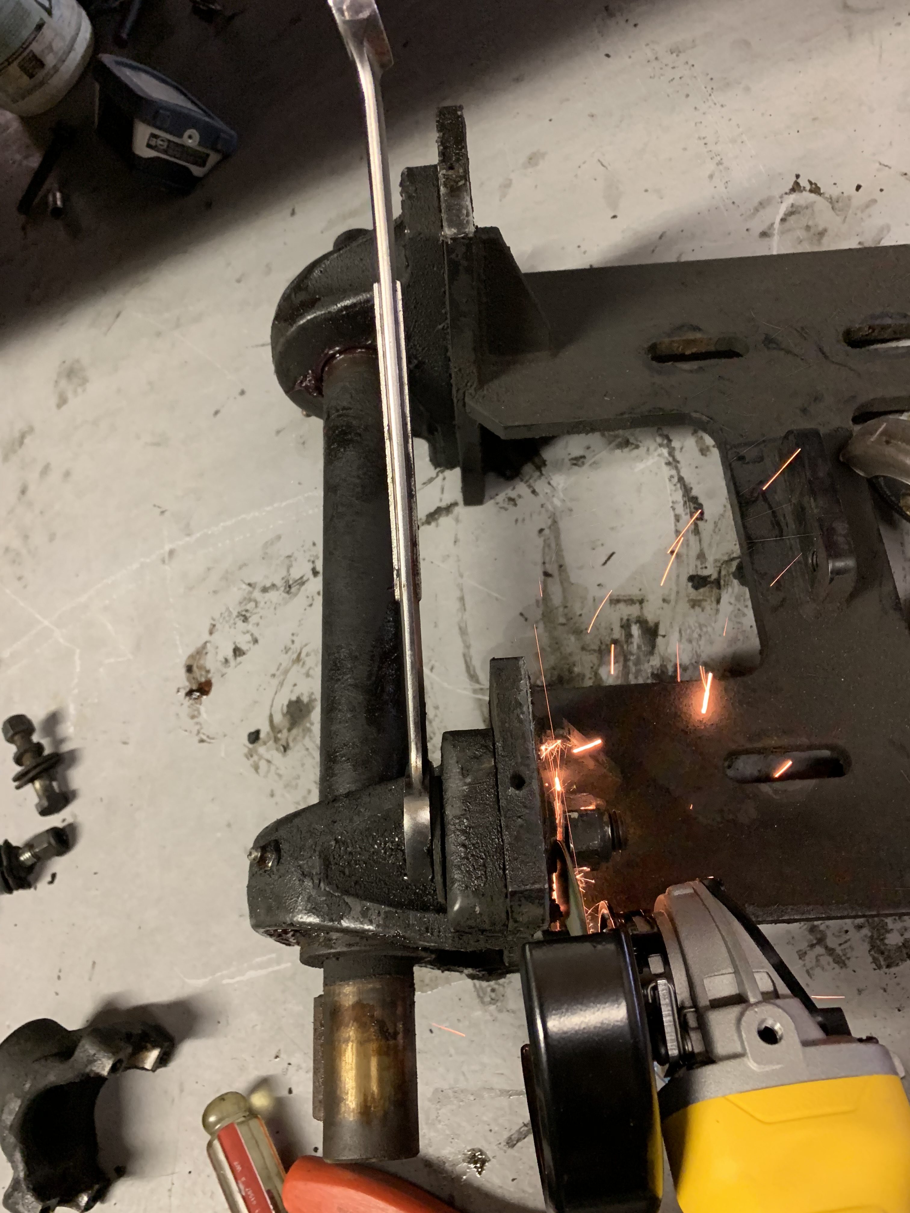

Oct 6, 2018 #1 ronbeatty Member Joined Nov 16, 2006 Messages 1,439 Name Ron Beatty If you ever have to replace the pillow blocks on an Aerotech, order the shaft with the coupler for the universal and the rear pulley. Over time the parts get rusty tend the be hard to press off. The extra money will be well worth it. Reactions: DAT
Oct 6, 2018 #2 Mike Pailliotet Administrator Joined Oct 6, 2006 Messages 117,339 Agreed.. Reactions: ronbeatty
