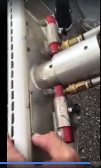

Larry Cobb
5,795
Larry Cobb
The amount of distortion you get sometimes depends on how close your jets are to the carpet. On my machine 12, I am using 4 1.5's and it works beautiful. The jets are angled to shear across the carpet fiber. I have a 2 inch westpack that has 4 02 jets that angle straight down and distort deep pile carpet. I feel if I could change the angle, it would work fine.
Devastator will let you change the jet angle with 2 fingers.
