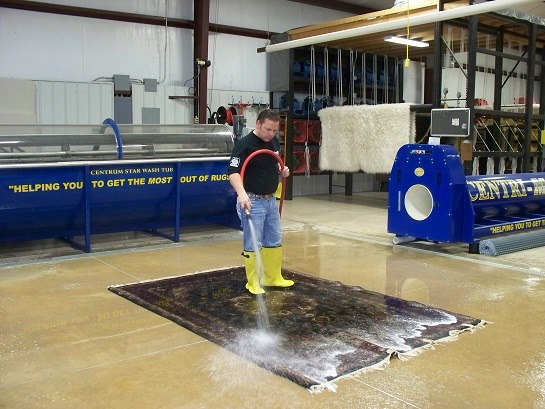

What type of floor drains are better to use?
Plastic or metal?
I'm looking to do the perimeter drains in my shop.
I currently have a inflatable rug pit when Arron Grosclose taught a class here.
Do you know the size that's best to accompany the water use?

Hello Nate, my floor drain are plastic 5'' wide 5" (deep). The drain by the wash tube is 8" wide x8'' (deep) the wash floor is 20' X 25' and is 1" higher in the center which lets the water cascades all four directions. Hope this helps.

Nate,
The drains themselves don't have to be plastic. You can cut the drain trenches and pour a concrete bottom, then coat with Herculiner if you're concerned about chemical etching. The grid tops should be plastic though (I think reinforced fiberglass) or you'll spend a lot of time fighting corrosion.

Thanks Rodney and Uncle Brian!! My floor has a 1" slope in it, so I don't need to re-pour it... Great idea on making a concrete bottom... This whole time I was trying to look for trenches...
