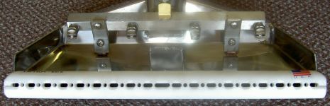

Here is a jet view of the modified 2" wand:
Greenie does not have the GunJet on his design.

Larry Question
Question Larry, does each jet have its own no drip check valve, or is it set up like Butler wand with one no drip check vale at the handle?
Are all check valves made by the same company? Those little puppies are starting to get expensive.
What kind of valve is in "gun" style trigger handle? What do you have to disassemble to put in a rebuild kit?

Bill;
The Greenie check valves are between the the Veejet & the jet bar.
Greenie also designed the jet bar extension that moves the larger Veejets back and angles them toward the glide (not shown in the photo).
The Gunjet in the picture is an option that some customers prefer with the 2" tube.
Greenie uses a stainless "light touch" valve.
