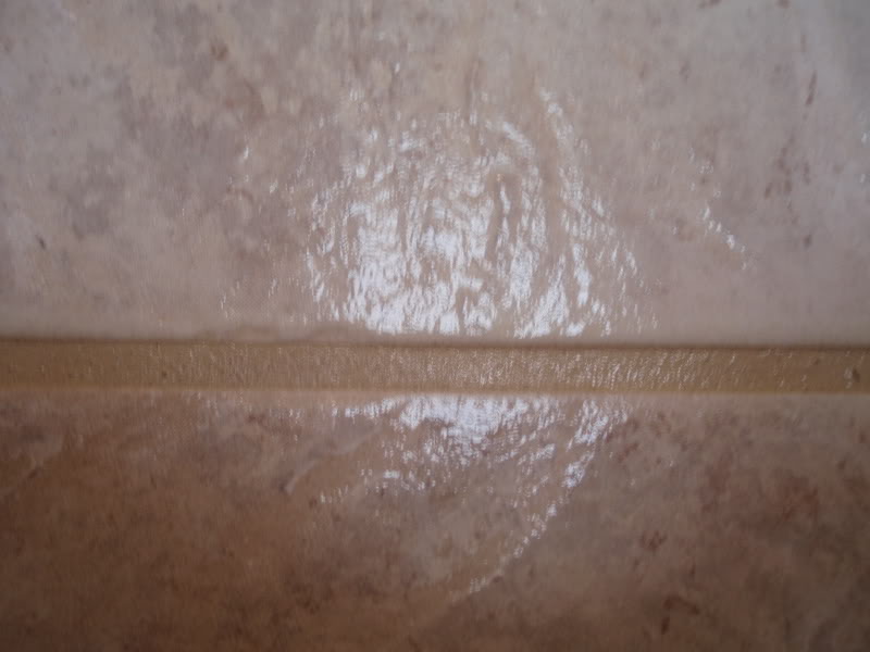

I like the blue microfiber chammies from Sam's. Cheap, easy to find, and they do a great job of wiping the floor after the application. We get about 100 sq ft out of each chammy. Less laundering, wipes up better then cotton and they hold a ton of color seal.
TOG & Grout Perfect both match any grout manufacturers colors.
BTW, we found that those applicator bottles slow us down.

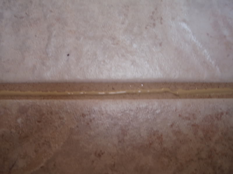

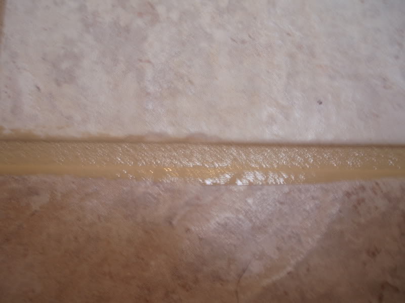

Initially the applicator brush is not easy - but when you get use to it there is nothing better or quicker. We have two methods of application:
Option 1) Beginners Version - apply a bead with the tip / yorker top and then spread with the brush
Option 2) Advanced Version with applicator brush
Check out the video clip in my signature line if anyone has any doubts.

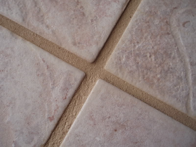

We only do one coat if the grout color is nearly the same as the customers choice of color sealer some touch ups after if needed.
Two coats if we go from say a grey grout color to a white color seal or say a white grout to a grey color seal remember though the second coat goes a lot faster like clear sealing our jobs always come out perfect or is that grout perfect I also find black color seal the hardest to work with. :)

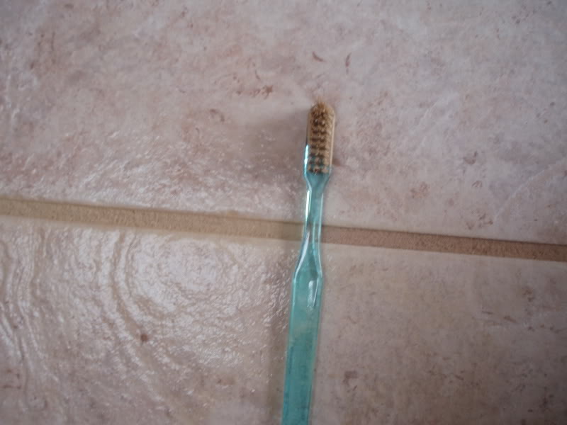

How long do the brushes last before you have to replace them? Do they clean easily? Or do you have to throw them out after every job because of specialty color mixing?
TimP
May 19, 2007
4,055
Are you talking about the tooth brush to color seal. You can replace them every time if you like 1-2 bucks for a toothbrush. I think you can afford it making a buck a ft to color seal. Although they do rinse good and you probably could use them again.
A grout scrubbing brush lasts a while although the point on them goes away after a few jobs.
