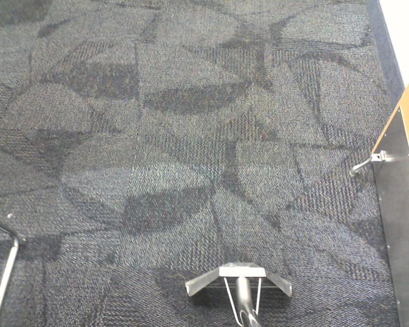

So I discovered that it pays to read instructions-yet again. I used more that a dab of sealant on the ends of my glides and sealed them completely, until yesterday. I allowed the wand to breath- low and behold after checking on my dry time-same carpet/psi/prespray- dry times were further reduced. down to 3 hrs dry to the touch at 350 psi.This means that the dry times are reduced with no glide and only 25' of hose to 50' and 2" with glide. The juice also worked very well on the dealership I cleaned. Thanks dear sir, your check is on the way.

Looks like carpet squares in the bottom picture.....those dry faster due to a plastic no pourus backing.
I think you need to do side by side tests to get a better picture on the dry times.....just my take on it. Oh and I didn't know you were supposed to put sealant on the sides.....maybe greenie can clue us in????

Depends on the wand, and age of the wand, we usually only recommend a dab of end sealer to older wands with wear, or occasionally to portable users who have limited vacuum and are trying to squeeze every drop of airflow through those holes.
The wand in the picture looks like it probably seals well to the glide, so the sealer probably wasn't needed.
Glad everything is working well, changing from 25' of hose to 50' of hose and getting Better dry times speaks volumes about what can be done with a porty and a few tweaks.

I need to clarify- those pics were with the judsons, the carpet I cleaned and tested dry times on was my own carpet here at home- medium pile stuff- longer dry times.
