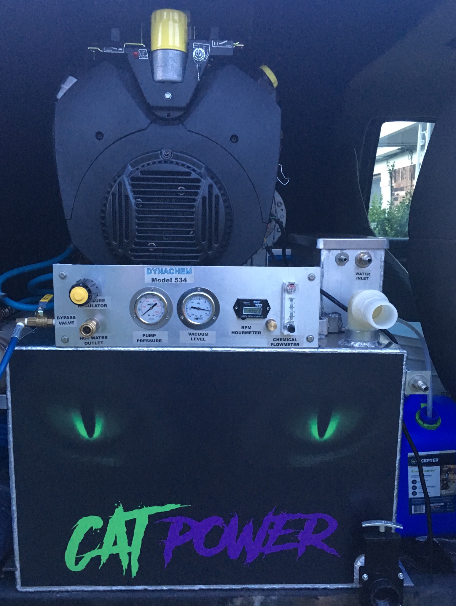

Although I am definitely not a newbie. Quite the opposite. I am working a few more years heading towards retirement. So I recently was in the market for what I hope will be my last machine. I did a ton of research before making my final decision. I also do primarily residential. The Rage was actually a finalist as well as the SS 370. Instead I decided on the Dynachem DC 534. Oh I know it’s one of those uncivilized “garage builds” but, when comparing what you are actually getting for your $ it was a no brainer for me. More hose, both a recovery and fresh water tank, installation, more power, heat, tax, all out the door for $16,000. It may not be a head turner look wise. But I’ve ran this thing pretty hard for the last 10 days or so and it’s been a beast so far. Just my personal opinion make your own decision. We all have different views. I was hesitant at first due to some negative views on here towards this machine. But I really researched the actual components and how it was designed and I am very happy with my purchase and that I didn’t have to break the bank. Happy Fathers Day to all!
Your opinion doesn't count. 😉 All machines should be great after only 10 days! lol
Seriously even a garage built Cobb is better than a portable...well...ok...yeah it is. 🙂

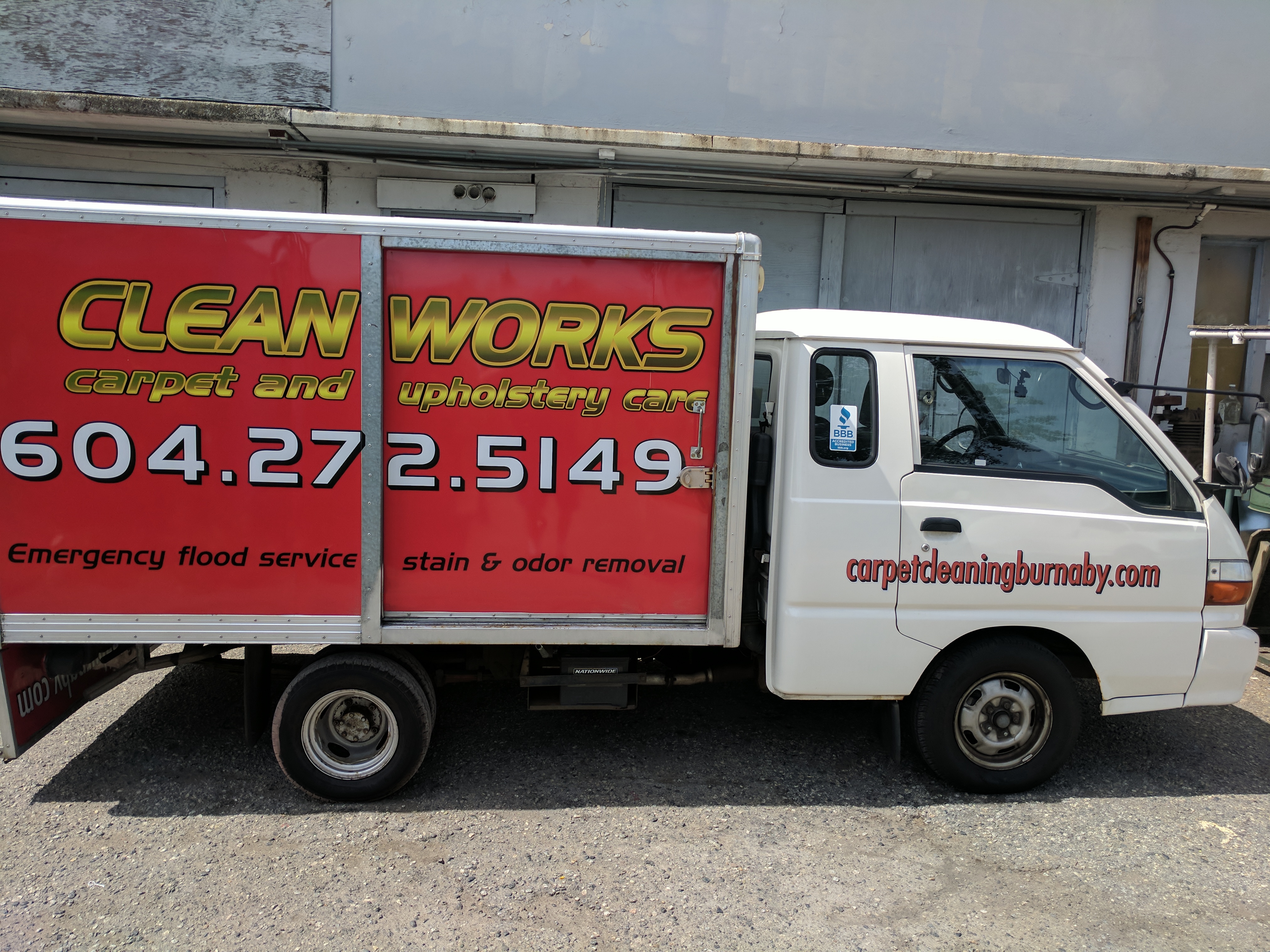

If you're going to buy used, know how to wrench on it yourself. I have always had used, except for my custom built unit in my dodge. I am putting together a little unit in my Hyundai box truck finally. It's an old Steamway unit with an 18 hp Kohler, a cat 3cp pump, a sutorbilt 3lp (36) blower and a lg Ht3 Propane heater. My mechanic has gone through the unit, compression is good, done a tune up and now it's up to me to install it. The blower is rated at 350 cfm at 3600 rpm. I will be running it somewhere around 3000-3200 rpm. Should be good for 200 ft of hose. Even at 300 ft, it will still be better than a portable. The propane heat isn't dependent on the engine or blower and is consistent. If any component fails, it is easily replaceable. I'll post some pics later.
