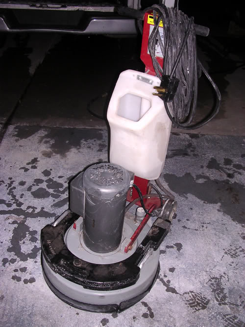

Thanks. This is not something I have scheduled. The buildings in one of the jobs I did today have parquet floors on about 400 sqft on each floor. I thought I'd try to find the person in charge and see where it goes. Their in bad need of refinishing, I can do one floor and see how it goes. Never done it before. I have a cimex type of machine (800 rpm) rotating heads and would love to give it a shot.

not sure how you would use a cimex, that would be a lot of cutting to get the pads to fit the heads

These floors need sanding. The wood is visible in a lot of the floor. From what I understand the scuff and coat systems can't have any bare wood showing. I was thinking of putting 8" round sandpaper in the machine. Here's a pic of it.

if you have to take them all the way down with that machine then you are in for a lot of work and you probably won't be able to do one in one day without different equipment
you are correct
