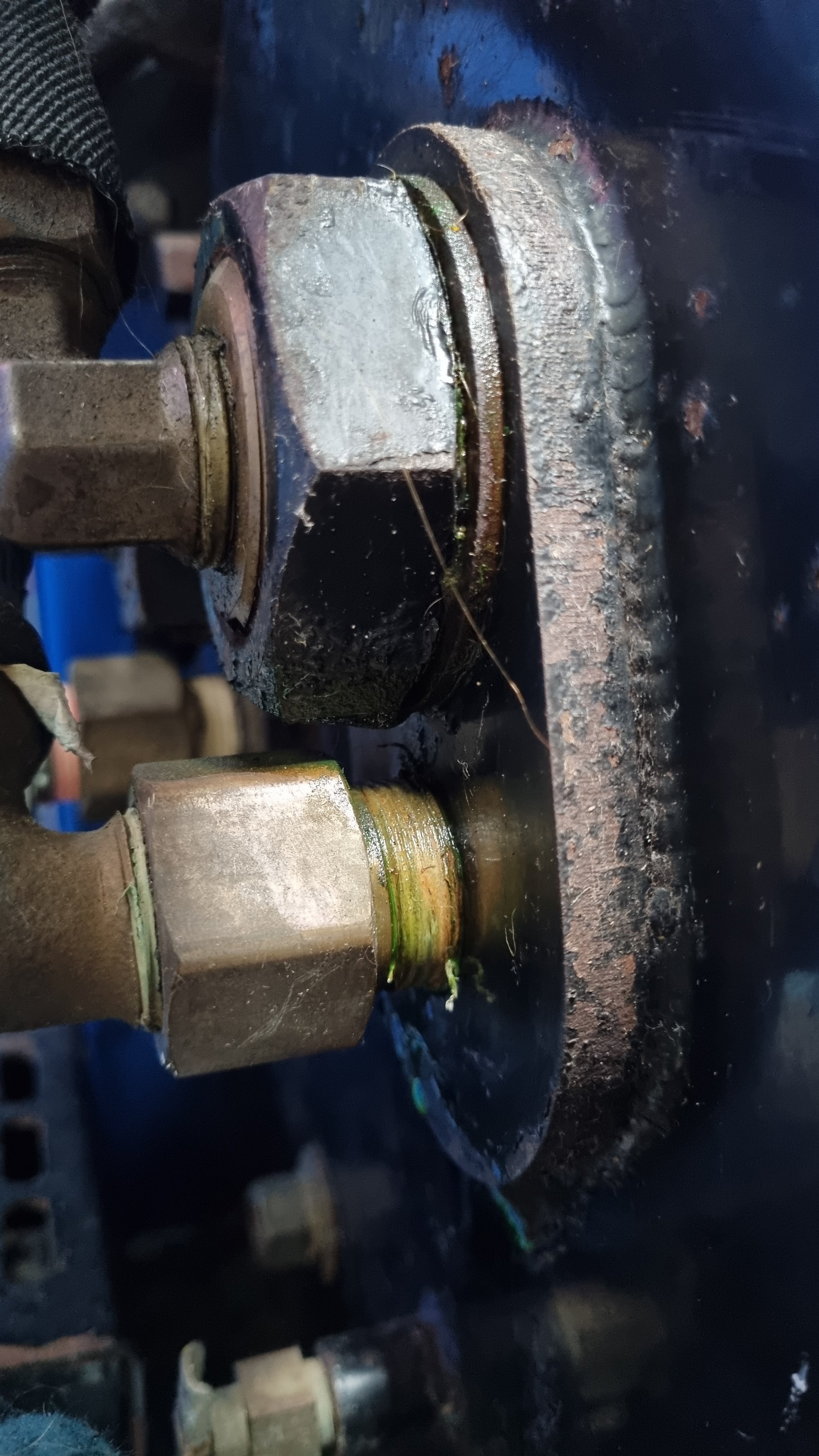

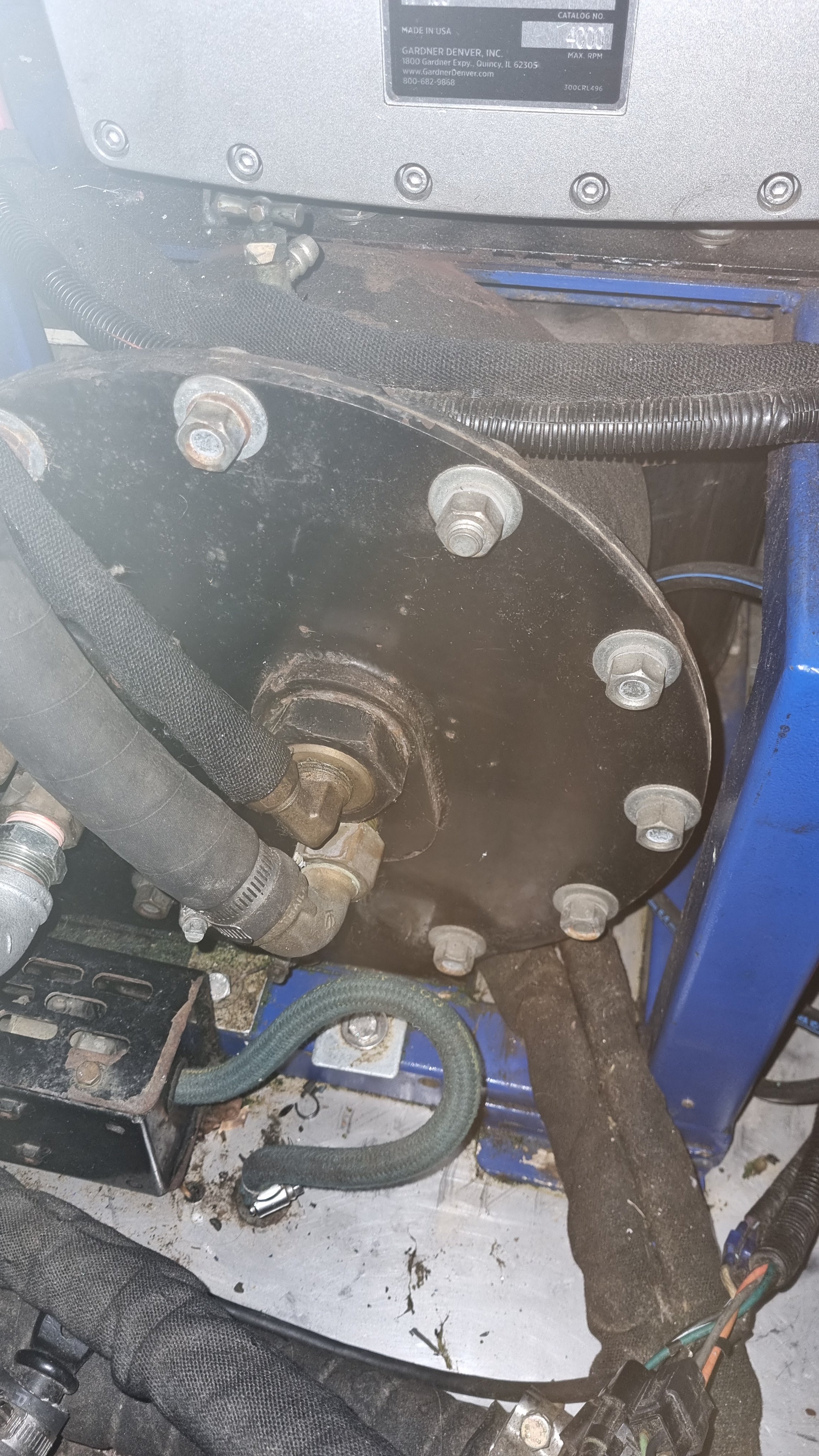

I am running a blueline bluewave.
The helicoil heat exchanger is leaking coolant from where the cleaning water is connected.
I haven't opened one of these heat exchangers before, what can I expect to find inside?
Also what are your thoughts about replacing this with one of the newer plated heat exchangers, such as used on the ss570?
Thanks 20221026_084335.jpg20221027_225503.jpgGordie

I replaced my coolant heat exchanger on my thermalwave and it didn't let me down. Provides plenty of heat and added more room for the machine to breathe and makes it easier to service anything in that area. It looks like your leak is small. maybe try to tighten that nut a little if you haven't already.
I had a leak similar to yours and I couldn't find out how to seal it back. It was a crappy design. I had the box shaped heat exchanger. It looks almost the exact same as the exhaust heat exchanger, only with different holes and upright instead of on the side. They were too poor at the time to use the "helicoil" shaped one.

I have an extra coolant heat exchanger box that's good if you want it from my parts machine. It's the box shape, not round design, so measure your area and see if it'll fit. All the hoses should plug right up to it

I have tightened up the nut as much as I can. Will see if it leaks over the weekend. If it does I think I will install a more compact heat exchanger as this will definitely help with accessing the water pump. I am in New Zealand so will probably just order a new part, but thank you for your offer
