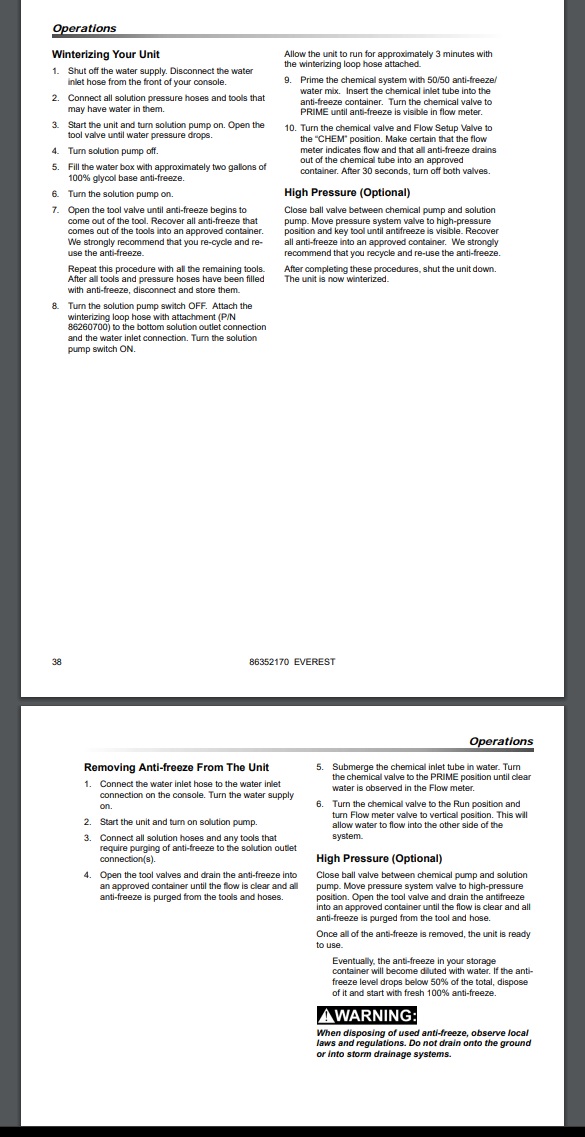

If you want to take the winterizing route, just suck out all the water in your water box (with the water pump OFF), then put some low temp windshield washer fluid in the water box (4-5gallons), put an open hose on your QD and turn the pump on until you see the fluid coming out of the hose. Do the same with the chemical pump.

You're forecast may change depending on your elevation. The higher up you are, the colder it will be. Good to take an air compressor and blow out all of your lines and tools, drain your water box, refill with windshield or RV anti-freeze and circulate through your machine. Remember to flush it out before your next job.

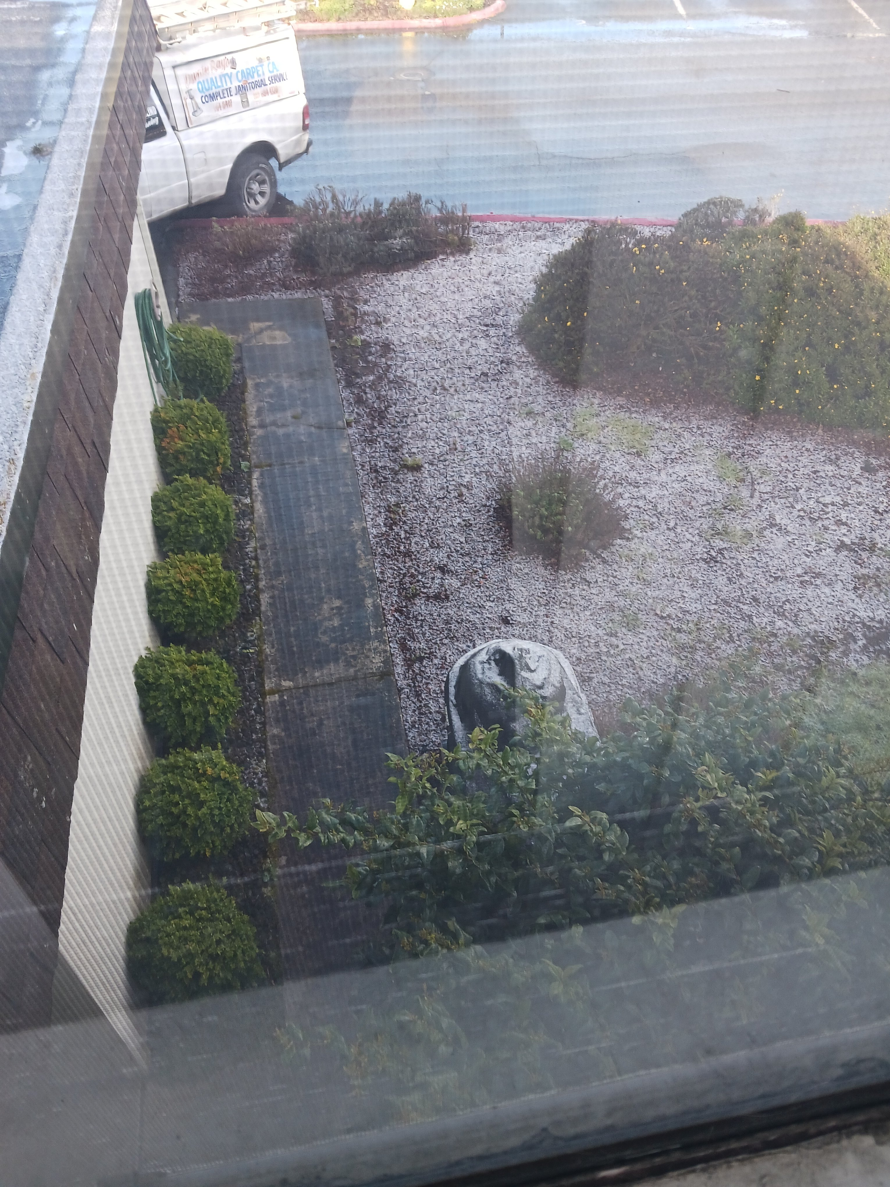

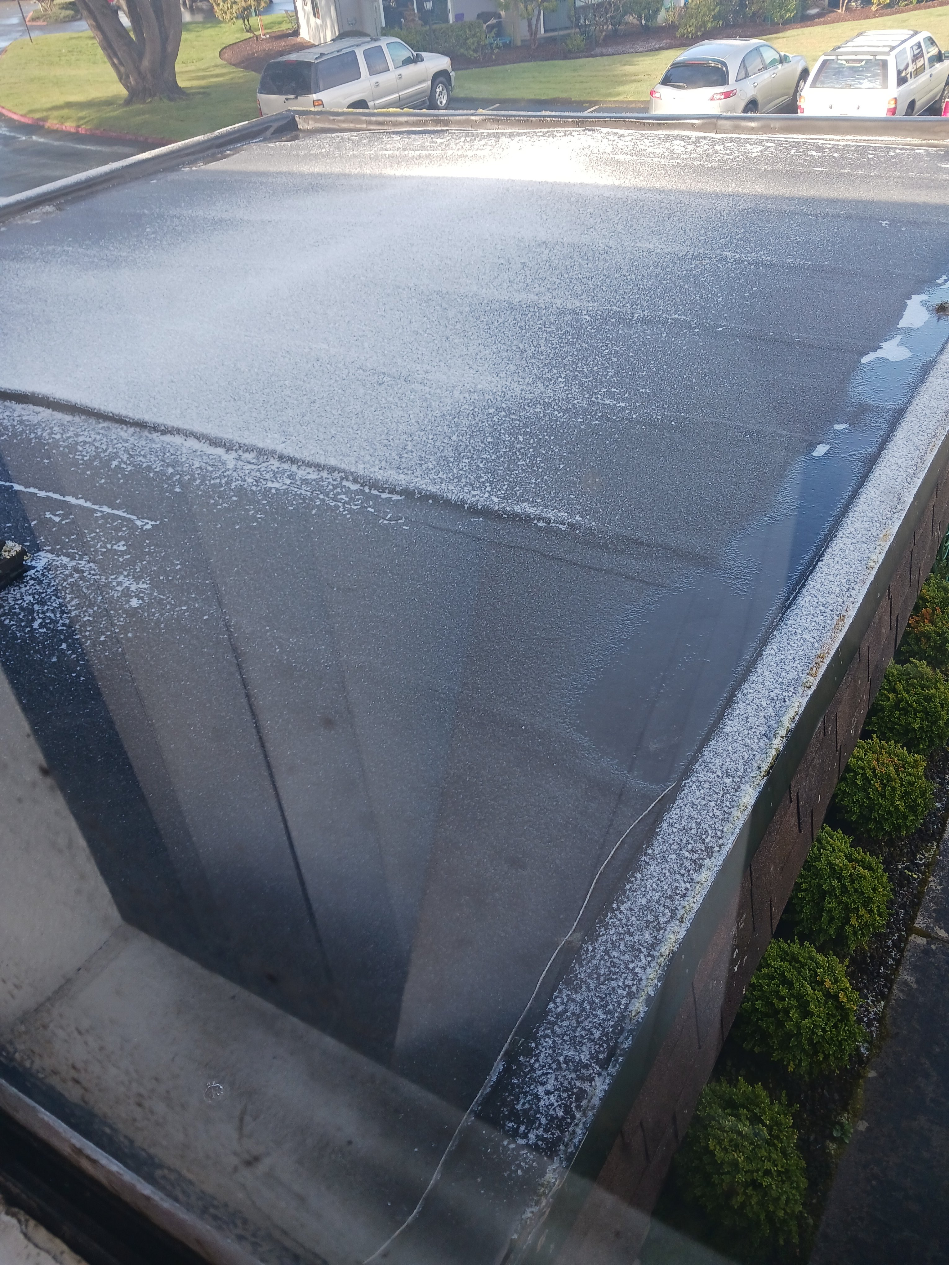

Thanks for checking yes I did just light snow on the vans nothing I know of happened lol
Cool, but if it drops much more consider a heater, when i put um in i used the ceramic heaters or the big oil filled radiant heat ones i stayed away from the ones with the glowing heating elements because of the possibility of 🔥 but at 32° a blanket should be fine. Got a little cold here last night and im within sight of the ocean

I live in Montana and for my first 5 years owning a TM mounted in a trailer I winterized every night. @BIG WOOD is correct with his advice. I can winterize my setup in under 5 minutes.
1. Suck all water out of water box. (I use my 1.5" cheater house, that I just stick into my vacuum port directly on my waste tank.)
2. Fill water box with windshield washer fluid. Usually at least 3 gallons. There's a way to cheat the float to get by with less, but 3 gallons usually does the trick.
3. Run an open ended solution line until you see washer fluid coming out.
4. Stick your rinse line into a a jug of washer fluid, and prime until you can see it in the sight glass of your meter. I'll often continue to run about a half gallon through while running more fluid out my open ended solution line.
5. If you wish you can run remaining fluid through tools and lines.
6. Suck remaining fluid out of water box.
Even after following these steps there is still potential for frozen gauges and anything that is brass can crack with even the slightest amount of water left. I would often also run 2 heaters with a thermostat set to 39° on different breakers.
Best of luck.
