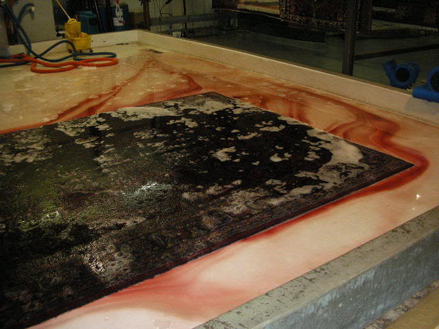

I kinda of like it when the rug oozes dye. Keeps me on my toes. With luck and fingers crossed, looking forward to seeing your plant this spring randy.

So what do YOU do when the rug is bleeding like a stuck pig?
Randy, Ron, David?
Do you guys always use dye stabilizer before washing?
Terry
May 18, 2007
575
Terry O'Brien

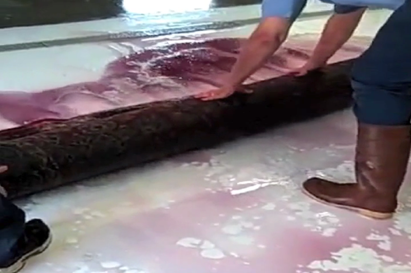

once it starts bleeding keep rinsing until it stops.
Ron K
Jan 3, 2009
2,371
Randy, Ron, David?
All rugs are are different and there fore treated different. I have not found a "Dye Stabilizer" that works 100% of the time. Tom and Randy at least you know what you have in those rugs in those pictures. It's the one that comes up and bite you that pucker me up.
sweendogg
Jan 15, 2008
3,532
David Sweeney
Terry and Ron hit it, keep the wAter flowing is important, but each rug is unique. Being prepared to strip a rug during wash or changing the pH when needed... Just depends on the rug And how invasive we need to get.
