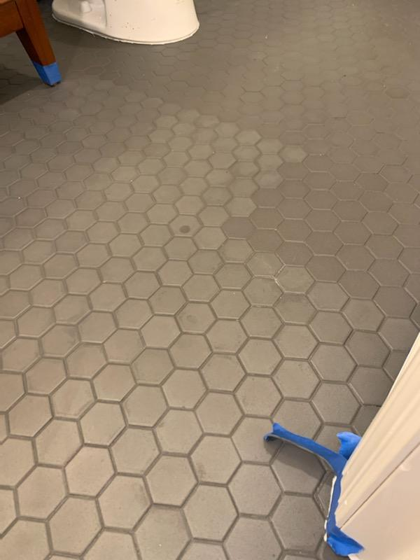

So this is what it looks like when people try to repair it with coatings This appears to be an older floor at that?

You seem to be hung up on the epoxy grout haze remover and in this case none was used, I posted a picture sent to me by the homeowner of what she used
I guess I'm just not explaining it right.
Whether or not epoxy grout remover was used there seems to be something that removed or damaged a topical finish. I mentioned the epoxy haze remover because given enough dwell it is the most likely to do so out of what I thought might have been used by the home owner. There was also a chance, with only pictures to go by, that given the grout color and small tile that what might appear to be a coating wasn't one at all.
The haze remover could be used to strip the remainder

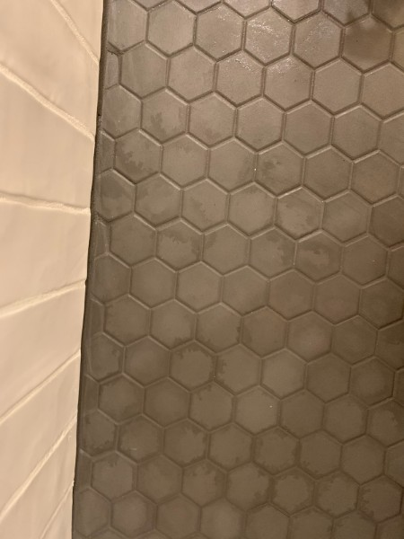

Which is exactly what she is doing, but now the tile is so absorbent that plain water is staining it..

The manufacturers can say what ever the F they want about the non porosity of unglazed porcelain.
This lady was sold/promised that her new unglazed floor would clean up with ease...
There is nothing easy about cleaning this crap, even for a truckmount equipped pro with a spinner at 1200 and pH14 Oxy Kaboom, let alone Mrs Piftleton and her Swiffer.
I've cleaned a ton of it and I've talked to enough frustrated cleaners to know it just plains sucks' as flooring material

Looks like color seal left on the edges.
Told this story before. Had a customer 15 years ago that sued the builder and tile manufacture, because there brand new porcelain tile in the kitchen, (new home) matt finish, was impossible for them to clean. Just like Mikey pic, turboed easy. Rest of the home had the exact same tile in a polished finish, not glazed. There was no issue with that. They went to court and lost because it was determined the tile was non absorbant.
It's not the absorbency that's the problem, it the surface texture.

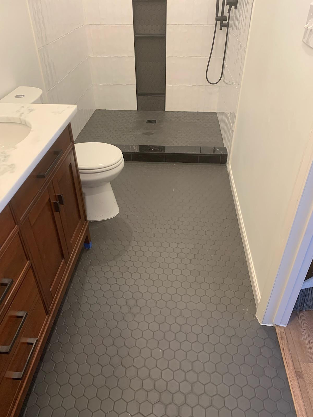

The whole floor has been colors sealed. the light area is where she used the haze remover.
At this point she has give up as water is absorbing into the tile and leave marks.
Time Yeater has been plying with some aluminum oxide finishes that can be mopped on, that dry level and look great...BUT leave the grout cloudy and or shiny.
Ripping this crap out is the answer, despite what Fred thinks.
