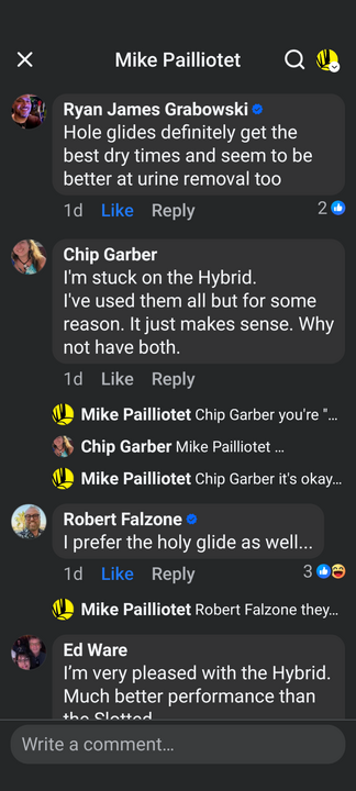

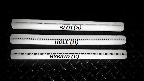

GreenGlidesLLC runs in waves, certain tools and Glides sell in batches for reasons I can't explain.
Questions come in waves as well and this past week has been; "which Glide should I buy, hole, hybrid or slot?"
If their age and experience isn't obvious, that's my first question followed by what extractor and wand they're using and most importantly, who are they cleaning for..
And I find that my answer is the same for everyone but apartment and restaurant guys..
The hole pattern will make your customer and your body the happiest, and you'll use it 90% of the time.
The slot pattern is best for those jobs that you hope will never call back.
And the hybrid is a compromise for those regrettable wands that don't allow for easy peasy swapping of the Glide to the best suit the task at hand...
I've been selling a lot of hole Glides lately....

Hole is by far the best
When the Glide is so flat that you can move the other end up and down without breaking the seal on the carpet, it's time..
